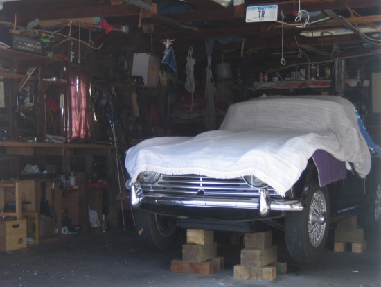

i,m running a low tech lower budget operation here. Maybe i'll start digging a pit.

That looks solid enough. Just a pain getting it up and back down.
Pits are illegal in many states because they tend to trap vapors which poison the mechanics as they work.
What sort of jack did you use to get her that high up?

I just used a cheap 2 ton floor jack alternating between under the diff and front crossmember. Can't safely get it in one shot. Also don't do it from the sides it will teeter. I can go one more 4x4 higher (which will make a big difference) putting wood under the jack. I never feel comfortable under the thing but even when it goes up once more I can give the car my best shot and it is solid. OK for winter but a pain for a quick fix.
Pit has crossed my mind it will never happen, especially after Peters comment
