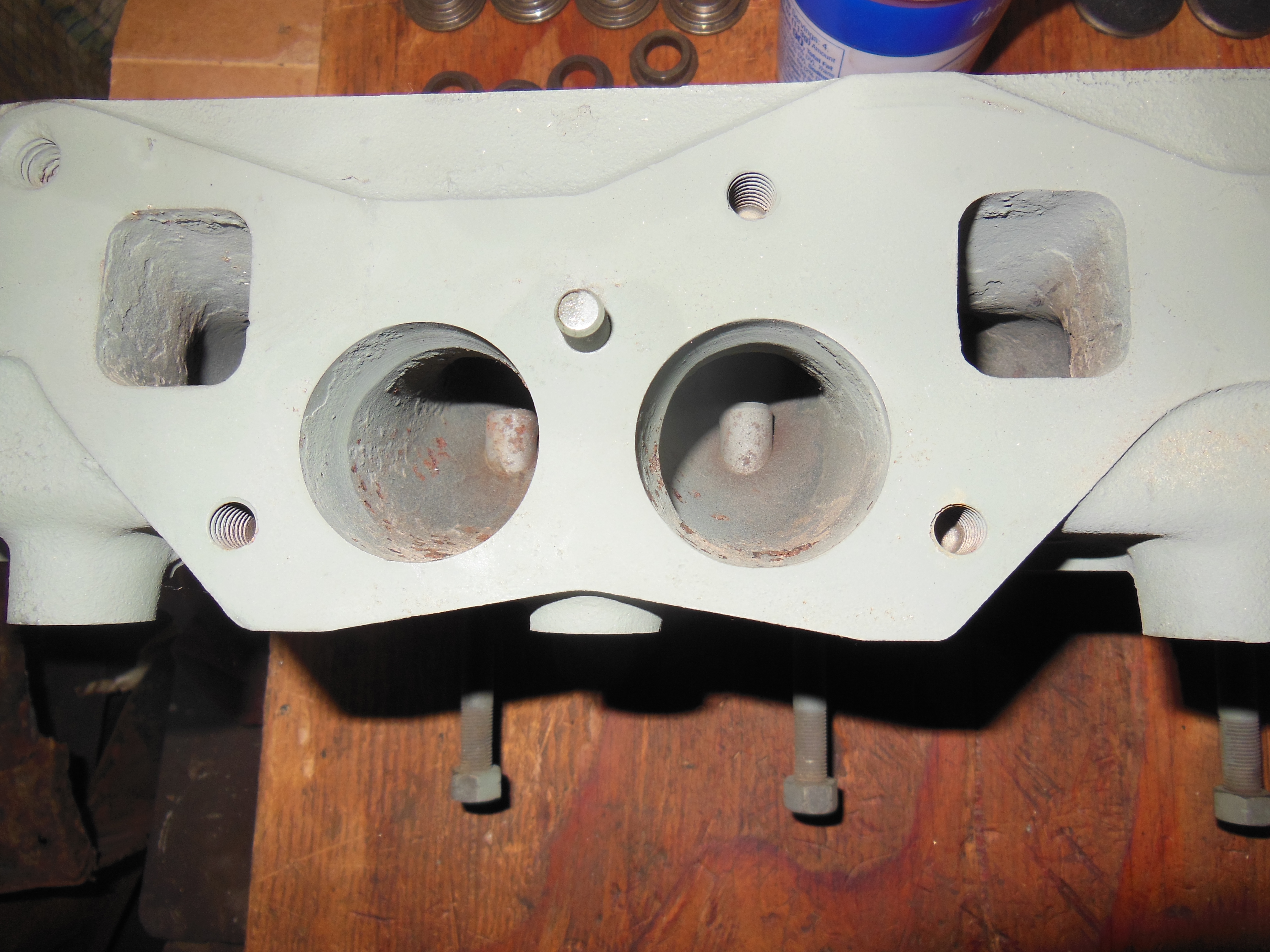

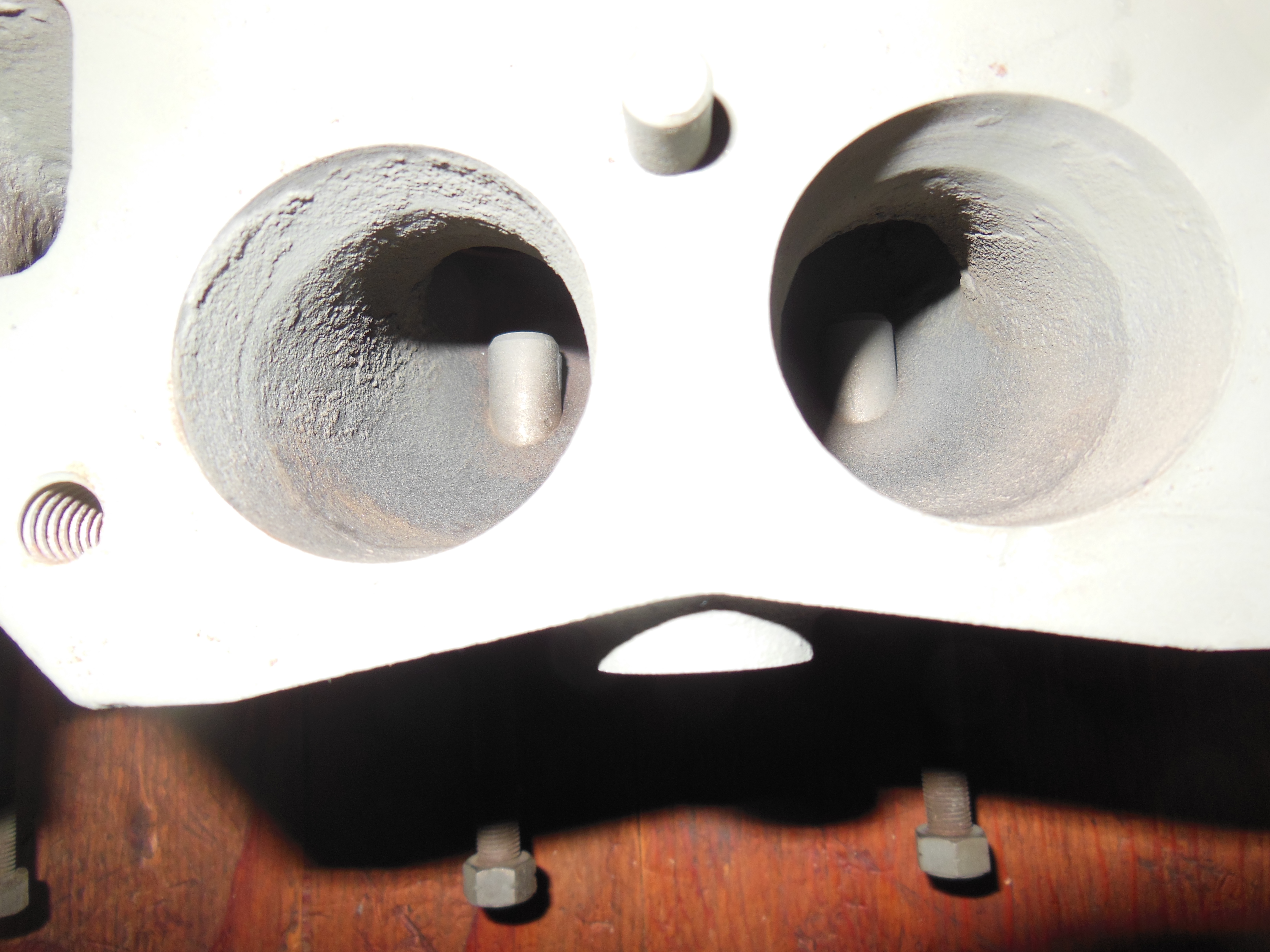

Rebuilding a cylinder head. I am working on a head that I bought off Craigslist many years ago and have had it under my work bench since. The guy was cool, and said he had the head checked for cracks at a shop and I think he said new valve guides. He only charged me 50.00 bucks.
I took some pictures to see if people thought the valve guides look new. Can I get some opinions of the conditions of the guides by these pictures or would a different angle of picture be better? I have never rebuilt a head before so any ideas are very welcome
Thanks steve

+1...you can't tell anything by just looking at the guides. Place a new valve in a clean guide and check for rock in the same plane as the rocker arm. Iron guides can be as little as .0025 rock...bronze guides (which yours are not), have to be closer to .005" rock. Of course, repeat with every guide to be sure. Also, I would emphasize "clean" guide, as it looks like the head was sand blasted, and every last spec of sand must be removed from the guides!
When I have a head to put together, it always goes to a machine shop for crack check, flatness check, guide assessment and valve grind.
Bob
My favorite trick is to install new guides then have them knurled to make up for stem wear.
It acts like an oil seal and greatly reduces oil consumption .Assuming the old valves are
in good kit of course.
Mad dog

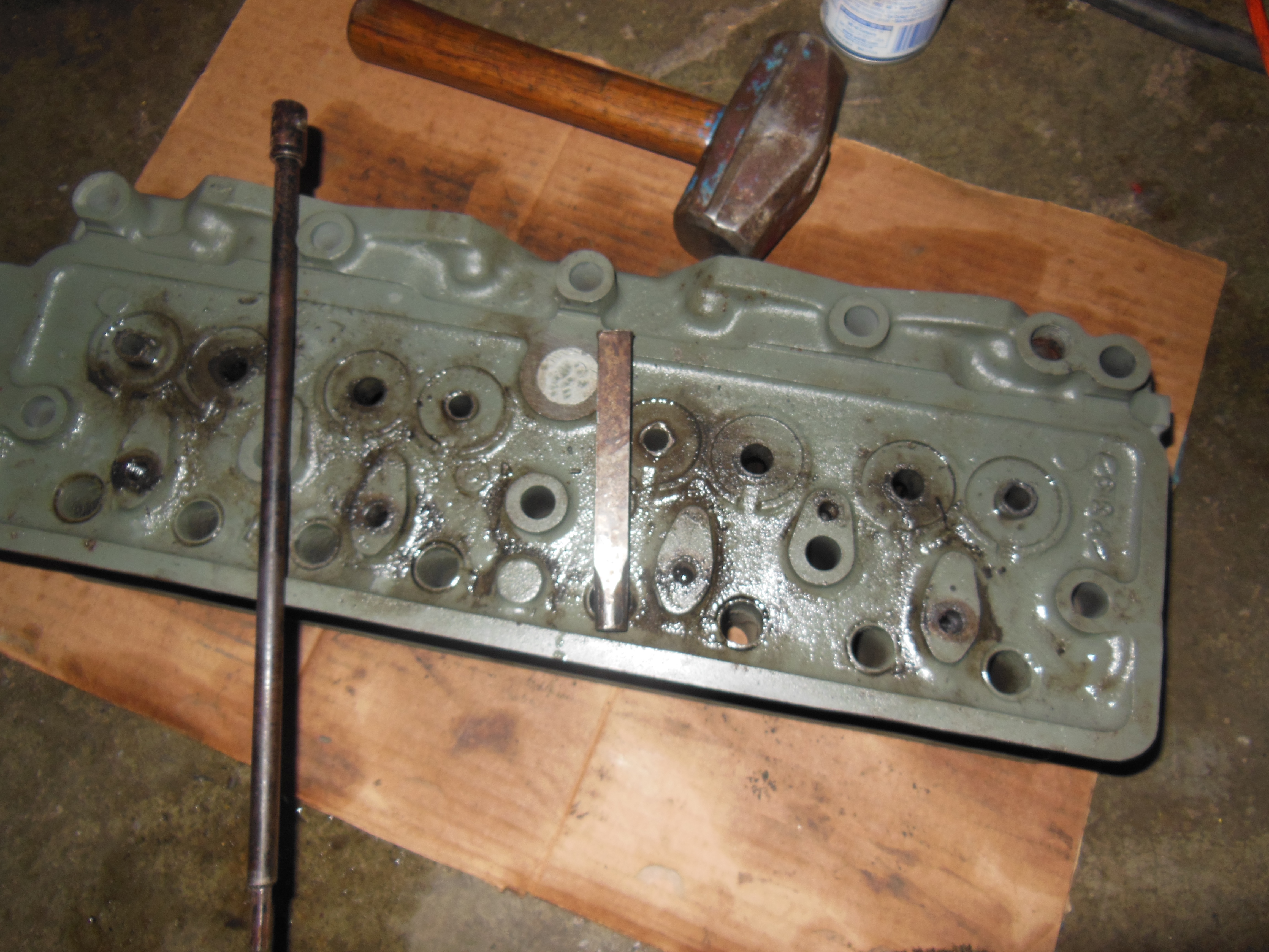

We have been on a Cruise and I lost my mind. I am trying to get back into my project car for therapy. I started taking the valve guides out with a small slug hammer. I was able to get the intake valve guides out pretty easily, but the exhaust valves are a different story. I think they are moving a little, so I wd40 them for the night. In addition, the guides seem to be breaking into pieces at the top. Should I be concerned about taking them out in pieces, so not to damage the casing? Moreover, I need to make a different removal tool because the diameter of the hole in the exhaust guide is bigger and my homemade tool does not fit. Anyone have a suggestion on what homemade tool works well for this application.
Thanks Steve

I used old valve stems and I welded tubing...or even old guides onto the stem and turned slightly smaller than the hole it is going into. They take a lot of beating, as you have seen, so it may take a couple to do the hole job.
Wd40 is NOT a lubricant, stands for" water displacement 40"
Warm up the head and freeze the new guides. Dont burn your hands! It is critical that the guides are
all set at the correct height. You can save a lot of trouble by having the machine shop do it
when the do the rest of the job, the proper tools make the job easy/not expensive.
Mad dog
