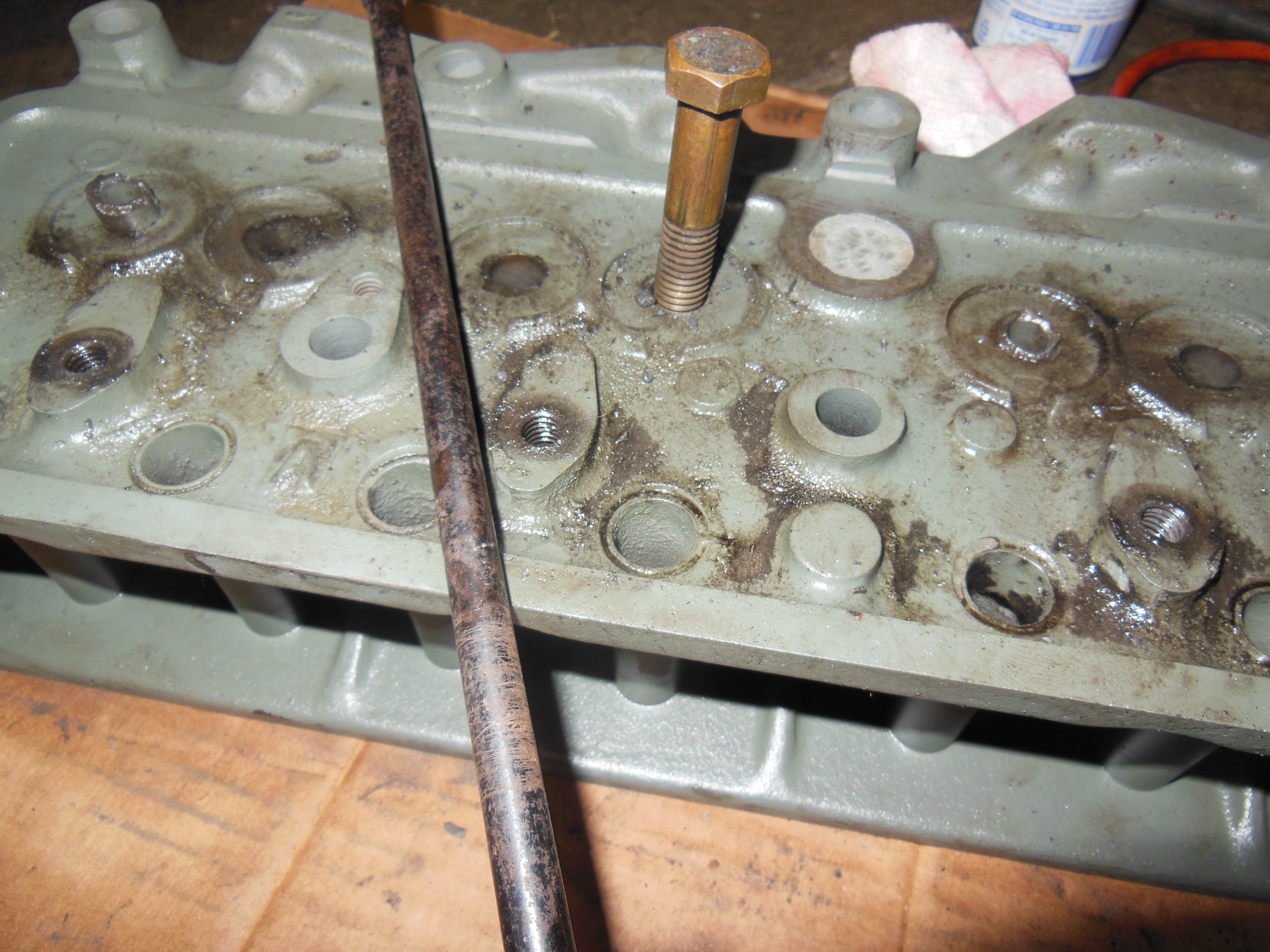

Removing the exhaust valves was not difficult. I used a brass bolt and drove them out with a few whacks. The brass bolt was nice because I used the head of the bolt at first then when the guide went below grade into the hole, I flipped the bolt over.

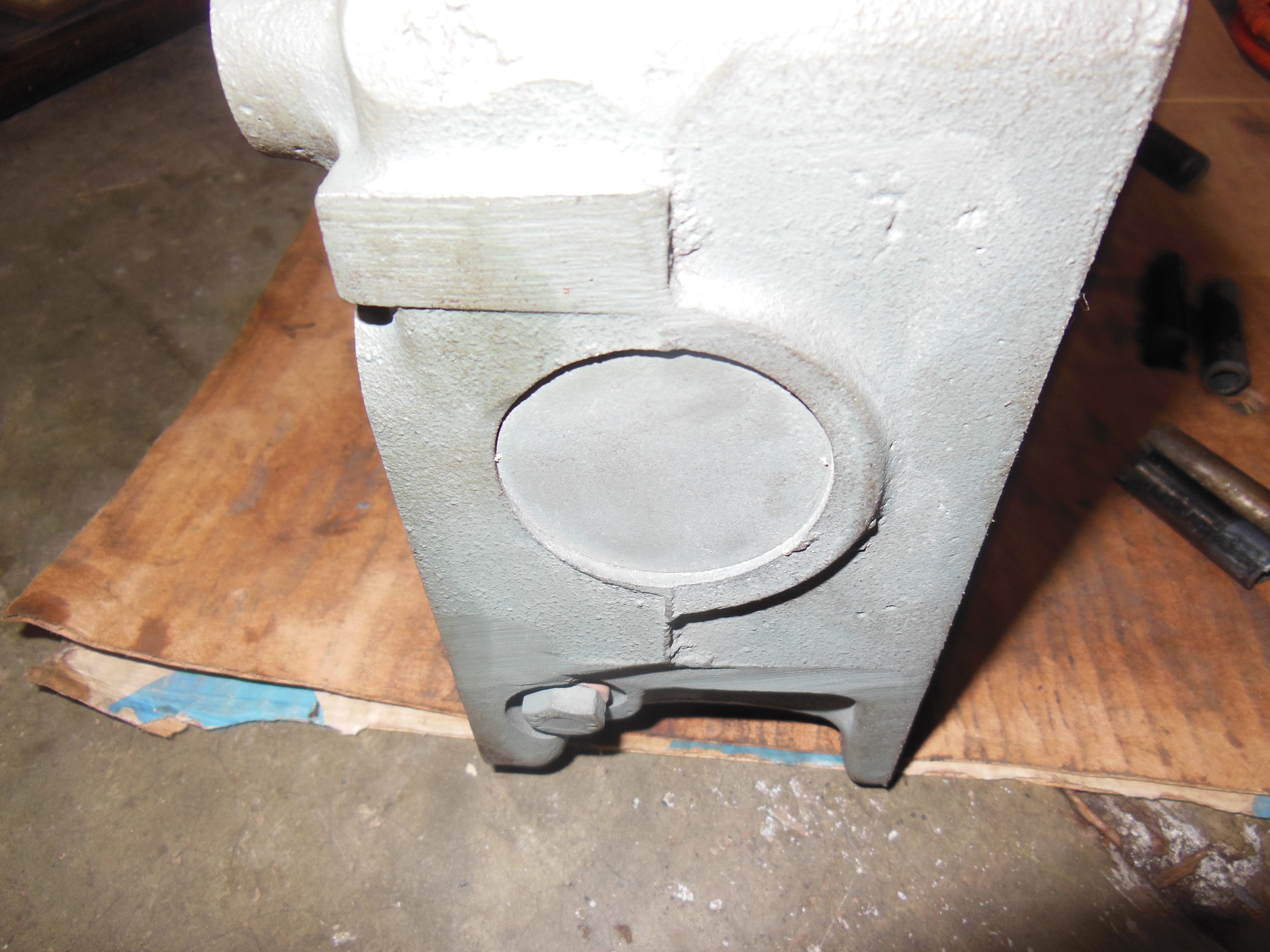

The plugs on the top of the head and end look newly replaced for the head, but difficult to say for sure, but they look good to me. In addition, the PO said he had the head magnafluxed( whatever that means) I guess that checks for crakes. I usually do not believe what I hear from a seller, but I like this guy. He was not a BSer.

Bob I did not use heat on those valves guides because I forgot to; it was when I say this email I remembered to heat them. Just for clarity no heated needed only the brass 4 inch bolt, and wd40.
