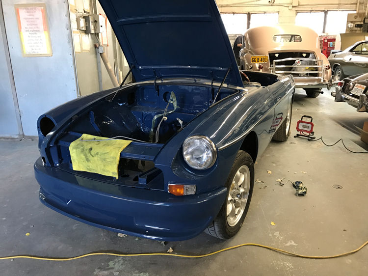

I love that color, Stewart.
Getting closer.

Looking good. That's a really nice color.
Nice. That Mercedes looks good too. What kind of bumpers for you have on there?
They are morspeed bumpers
Almost there just need the windows installed and it can go off to the upholstery shop. Windshield is out being polished and anodized. So looking forward to reassembling it.
What a difference lighting and/or cameras(?) can make? That looks like 2 totally different cars from one set of pictures to the next.

yeah it's a very strange color that's hard to pin down even in person
