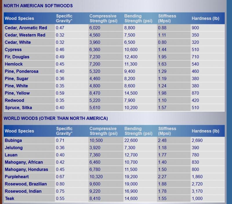

Most of the treated wood for decking is lumber that is not really ideal for direct outside use.
The pressure treating they do to the wood does help with problems regarding termites etc.
With most decks up off the ground.... usually termites usually not the problem.
With most of the composite type decking (Trex etc) there are two things to consider.
First is the initial cost of the material. You will usually find this substantially more than real wood decking.
Secondly the understucture for composite decking (as well as the hardwoods from SoAmerica)
is very different.... much closer together.... usually 16". These products do not have the fiber
strength that real wood does.... thus much shorter span.
When laying wood decking in place always try and orient the board with bark side up.
I have Redwood decking at our home in place for 25+ years with no stain or sealer.
In another location we recently installed a Redwood deck.... and there have used the TWP 1500 sealer.
