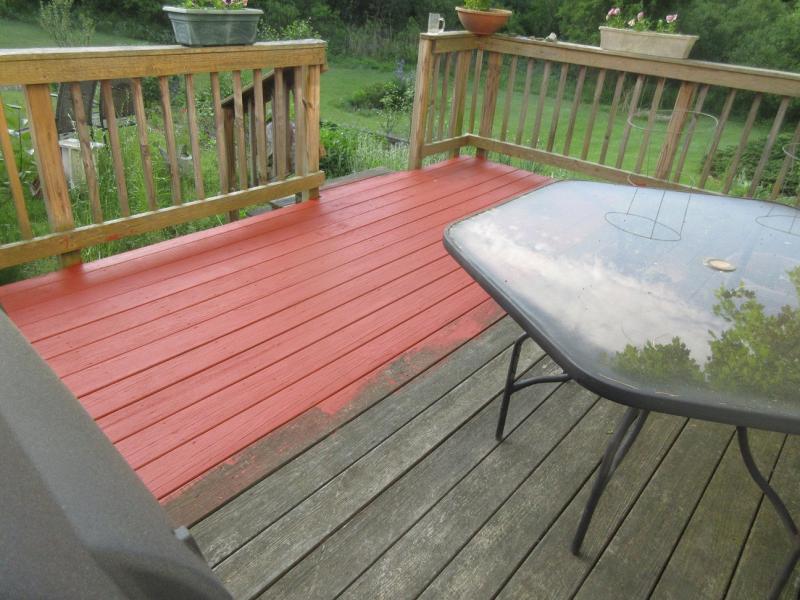

Here's the before, after doing a test patch:

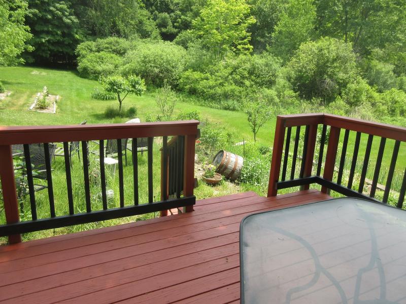

Using Behr solid color redwood and black stains, here's the result:
This post would be about six times longer, but I decided not to mention all the gol dern surprises and failures!

I can't even see the deck ,just can't focus up close with all that yard work that you must be doing in the foreground
Looks great Tom. Pay no attention to don he’s allergic to yard work. He’s hiding under the covers now.
No problem. It's actually just two acres of cement, painted green.
A few WalMart plastic flowers stuck in for good measure.
No front "lawn" here, trees shade it in the summer and cover it with leaves later. AstroTurf has been a consideration.
