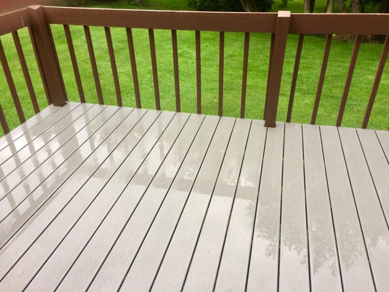

Tom- About three years ago I got tired with the maintenance of my PT deck. I pulled up all the deck boards and installed Trex composite decking. It has held up well and I’m glad I did it. In retrospect, I should have done it ten years earlier.

I used Thompson Water Seal, various stain. One year I rented a floor sander which was a LOT of work. I’m really pleased with the composite.
I just took this pic.... it's raining here; deck is wet.

Elliot - that deck looks *great*. How long would it take to disassemble it, pack, and ship it to me in Connecticut?

The hardest part was pulling up the old PT boards. Installing the new composite boards was very easy.
