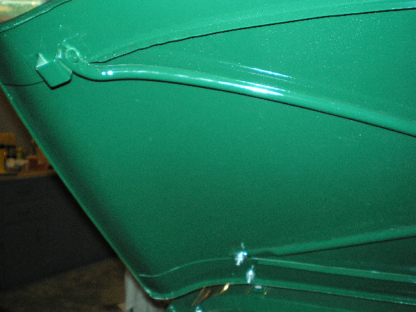

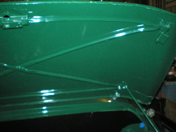

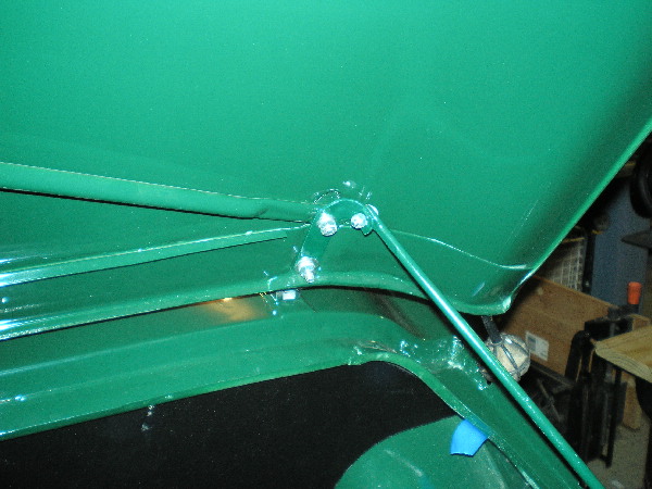

Steve, here are some pics of the interior of my boot lid. My car is a post 60000 3A. The only thing that we took off prior to going toit the body shop was the boot lid stay rod bracket at the hinge area.
Hope this is of some help.

Thanks Dick for the picks they help me see that I bolted it up right despite the way mine pushes the lid up in the back. On yours are they bolts in the back or some other type of hardware, like pin or?
Steve
They are bolts. I just didn't take it apart when it all went to the body shop. I have some other issues but but not on the boot lid.
If you need more pictures let me know.
Dick

Hi Dick and Tom you have both been helpful, Dick for the pics and Tom for information about the rubber piece. However, I cannot find it in the TRF catalog. My mind cannot work with too much of that clicking around to find stuff. I guess that is why I use Moss so much. Having said that I often do like the stuff I get from TRF better. Incidentally, after looking at your pics Dick, I figured out what I did wrong with the brace. I bolted it on the inside of the rear supports and not the outside. I mean it took me and the pope to get that thing in there and know I have to try and get it out. I need higher help again.
