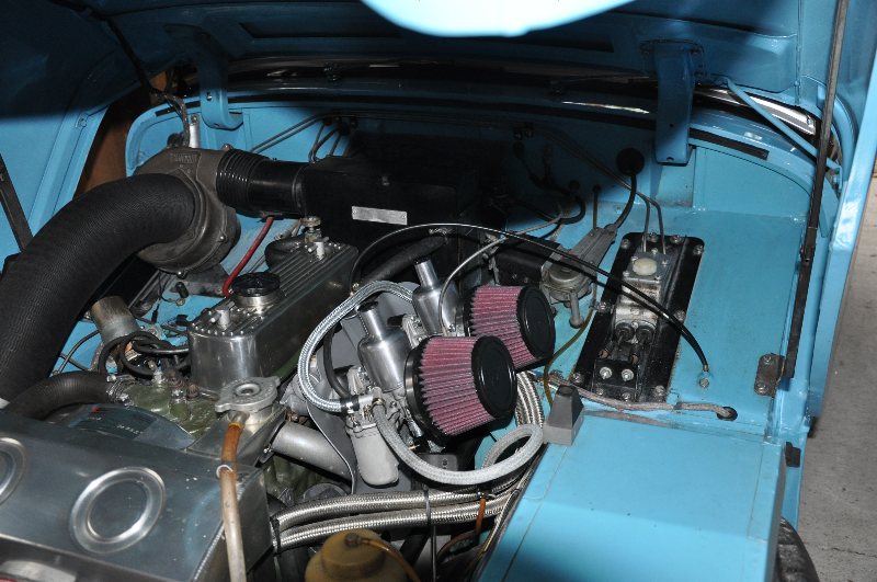

Gundy, you car sounds like it wants to kick some butt! Who built your motor? And is that HS4's on it, or HS2's?
A fellow in California built the engine. Standard hot rod stuff.
Bored to 1380cc w/ GT7 Longman head, hot cam, 10-1 compression, alloy flywheel and harmonic, Aldon ignition,
big bore headers, 2 inch ss exhaust, Vernier timing, ARP throughout, etc. Nothing out of the ordinary. Very similar to the Spridgetmania setups.
The carbs in the video are HS4s w/ Maniflow intake. Not the best for street use IMHO. Really honked on WOT however.
I've since replaced the HS4s with custom HS2s from Hap. Ported early model intake. VERY happy with the HS2s. Impeccable street
manners. Great throttle response.
Here is a pic of the current setup w/ HS2s.
One of these days I'll get Hap to rebuild it for a Supercharger.
I keep saying I'll do that when I blow this one up.
I've put about 3000 miles on it so far and it has held together just fine in spite of my heavy right foot.
