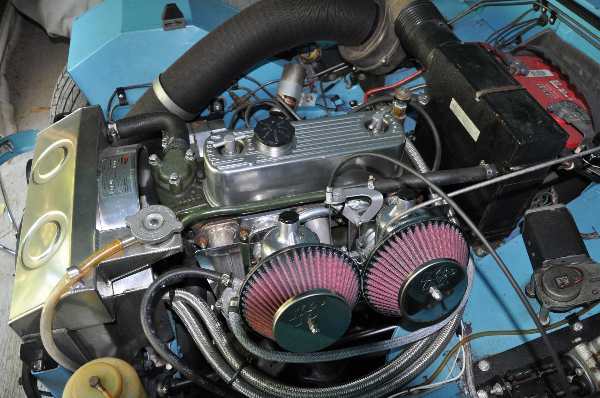

I bought this engine on e-bay for $350 with tranny and installed it in a few weekends. It did cost me a few hundred for the auxiliaries. Costs me more for the brakes and interior than the motor/tanny.
$350 with that carb too?
Either way, seems like a deal!?

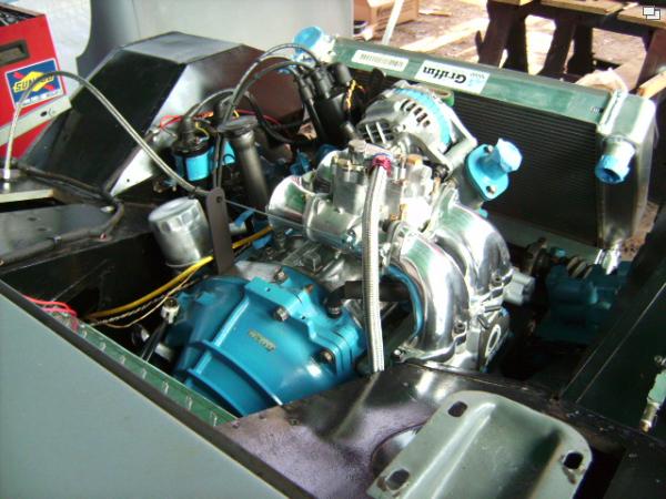

Im in the middle of putting a mazda 12a rotary in my '65 sprite (yes, still in the middle) and in retrospect, I wished I had just built up the 1275 that came with the car. I'd probably have it running by now and be out enjoying it instead of it sitting on jack stands in the garage. someday.
my .02
