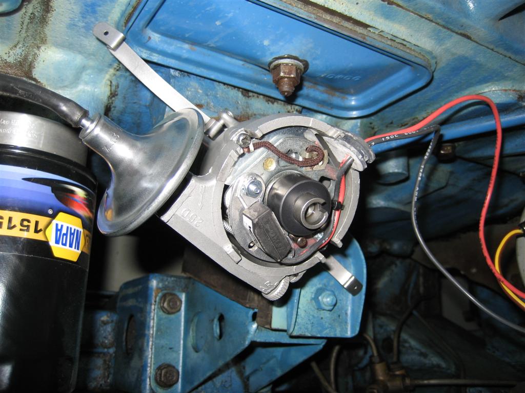

The pigtail is the short reddish wire near the top in your pic. I looks ok.
If the pic is where you have the distributor set for firing number one cylinder, Either you have the engine's number one cylinder on the exhaust stroke instead of the firing stroke, or the distributor is plugged in 180 degrees out. It takes a full engine revolution to get from the firing stroke to the exhaust stroke & vs.
The cutout/notch in the top of the distributor shaft fits the rotor at a position opposite to the business end of the rotor. I assume that the way it is, with the rotor seated correctly on the shaft, the spark end of the rotor is pointing to #6 cylinder instead of #1. Firing order on the cap, CCW, is 1,5,3,6,2,4 & takes two engine revolutions for one distributor revolution.
Recheck for #1 cylinder firing position, both valves closed. If it is wrong, #1's valves will be a little bit open. If it is correct, unplug & turn the distributor shaft 180 degrees so that the firing end of the rotor is pointing to #1 cylinder instead of #6.

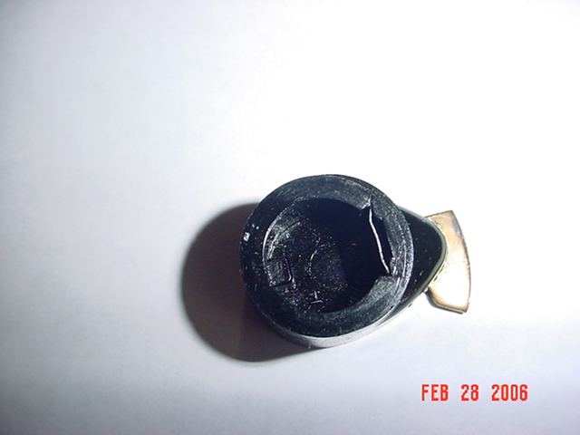

The Brit rotor would look something like the attached pic.

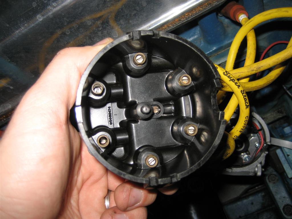

Wait, here goes my complete lack of knowledge. Do I have a rotor? Here is a picture of my distributor and cap. This is all I have...nothing else. I think I may have been referring to the rotor has the arm and the shaft for the rotor as the rotor.

Really - Nothing else. If so talk about going in circles. See the pic in my previous post. This "rotor" goes on the end of the distributor shaft in a very precise location to route the spark from the cap center coil electrode to the plug electrodes.
By all means install the rotor. Make sure that the brass end is pointing to #1 plug electrode on the cap as before.
