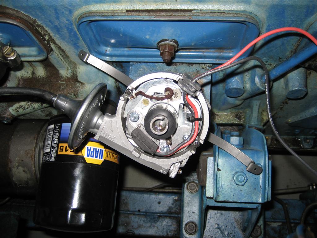

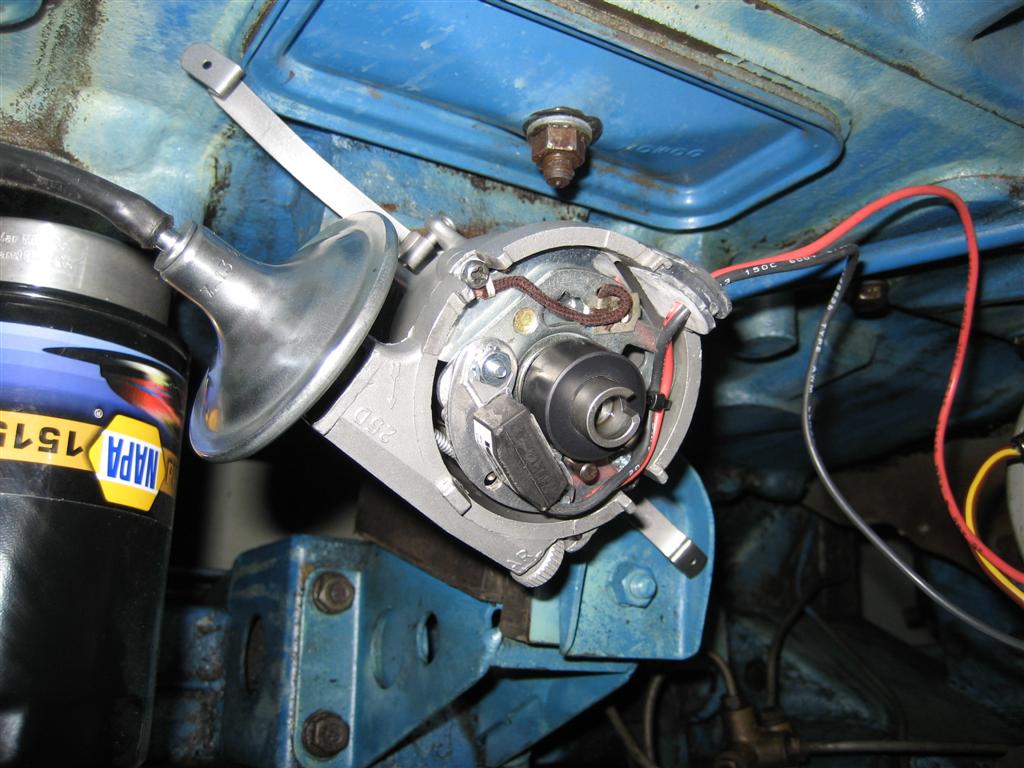

Back up just a bit. Do you only hear the "sparking" when the cap is off. If so, this would be normal. The sparks have to go somewhere. If it's happening with the rotor & cap in place the plugs should be the only place that sparks.
I agree that 10.9V at the coil should allow it to start.
Don't want to confuse you, but there are a lot of possibilities still open.
Is the Pert sleeve correctly seated over the point cam & fully down into place.
Is the rotor firmly seated on it's correct index flat.
Is the rotor clearing the cap contacts & not rubbing them inside.
Is the cap firmly seated on the distributor & in the correct notch.
Are you sure that the rotor is pointing to #1 plug when the cylinder is on the compression stroke & not the exhaust stroke.
Is the small cylindrical spring loaded carbon brush in the cap still in place & contacting the center of the rotor.
D
One other thought. Is the small flexible pigtail that connects the distributor body to the point mounting plate still firmly connected. The Pert requires that it's metal base mounting plate be well grounded.

Not sure about the sleeve and rotor. All seems to be fine, but I'm not familiar with it so I've attached two pictures that may be able to help you see. If not, you may have to tell me what to look for.
The rotor is clearing the cap and the cap looks to be seated fine and in the notch (by notch I assume you mean the two notches on each end where it clamps).
I adjusted the distributor a bit CCW to see if I had it timed in the exhaust stroke and not compression. Tried it again and still had no luck.
The spring loaded brush is in place in the cap. I can't tell if it's contacting the rotor fully.
I'm not sure what the pigtail is you are referring to. Is it the piece that the red/black wires go through?
Thanks!
