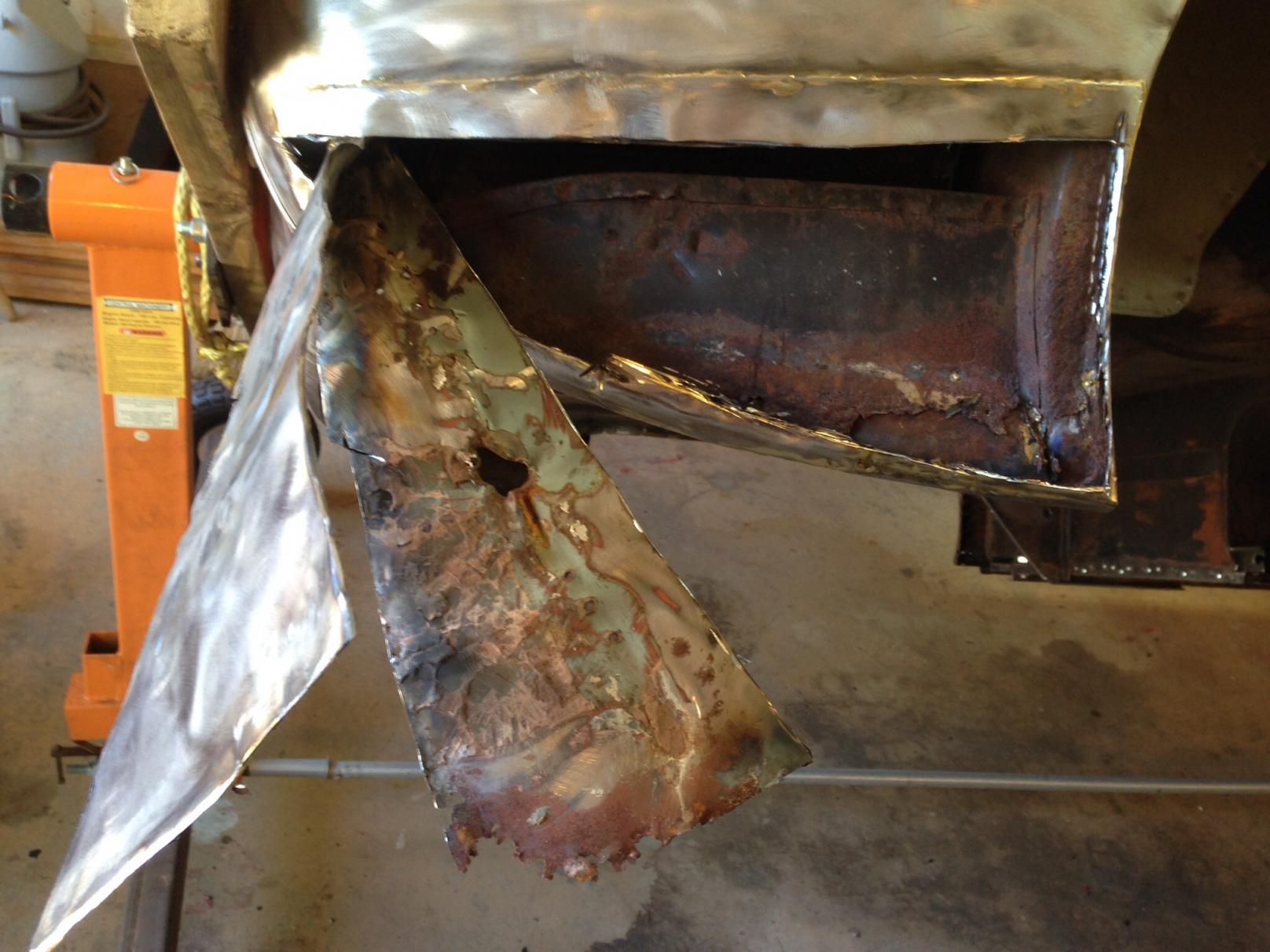

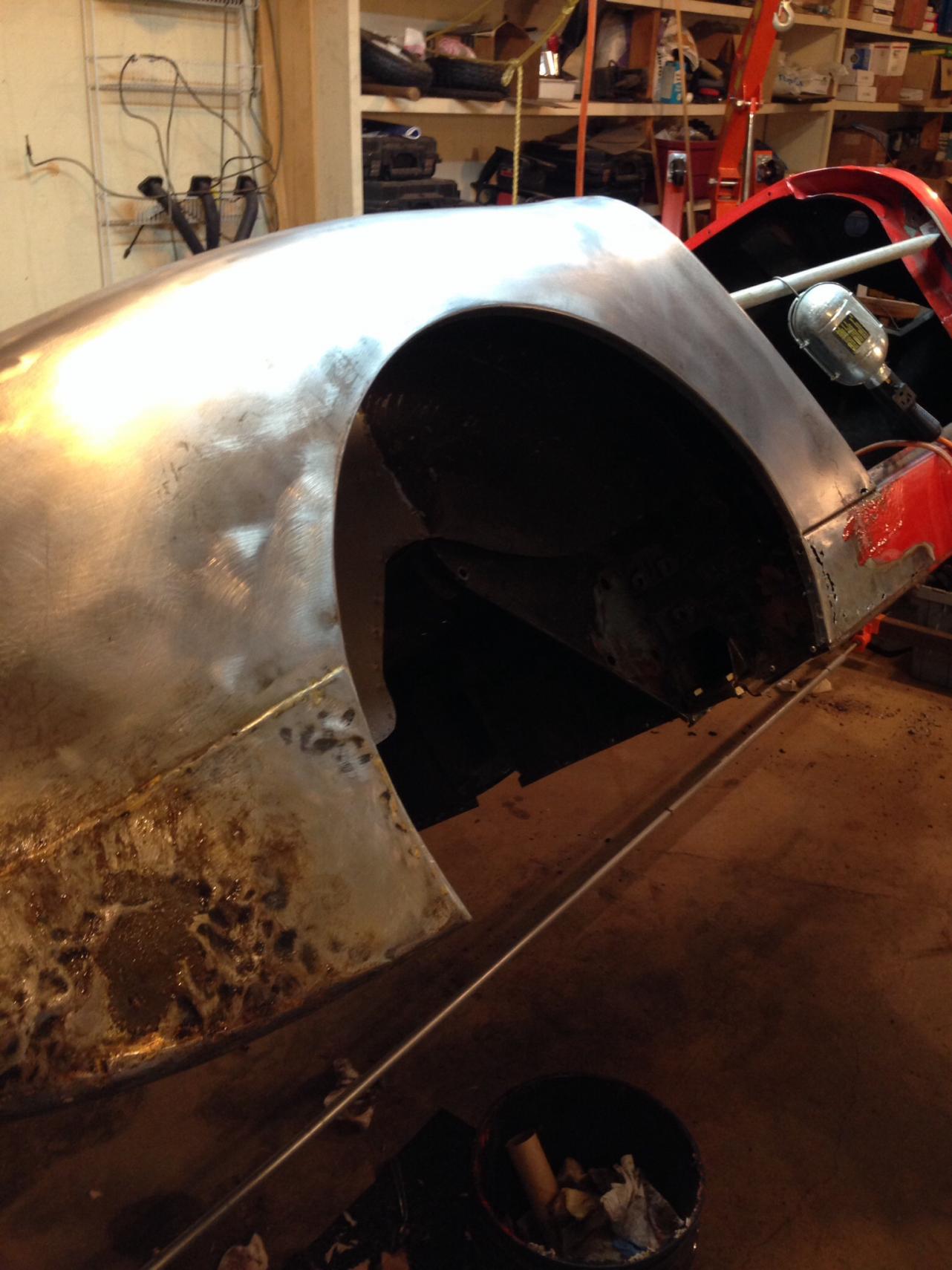

Heard from the shop today and they've been able to make some progress again. They've done a little sorting on the doors and started cutting the rear quarters for the repair panels (still waiting on one of them from the suppliers, will contact them and another source mentioned by a fellow BCFer this week).
They found that the current patch panels were welded right over the old, rusted metal. Guess there were a couple layers of rusted metal under there. I'll swing by at some point this week and take a look. One way or another we'll get it sorted out and solid again.

Drew,
I think that was a pretty common fix back in the day!

At least it's not just poor Penny. :grin:
It'll set the budget back a bit to fix properly, but in the end it'll be done correctly and that's what really matters.
