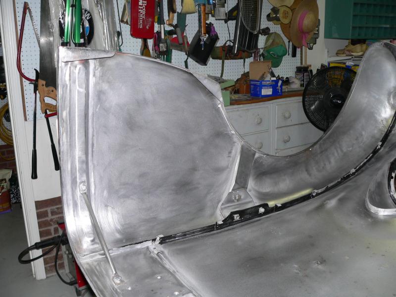

Drew, In the one picture is that glue or some sort of seam sealer coming through on the backside. What did the shop do to ensure rust was gone in the seam between the hood and the fender where the fender bead goes and how did they glue down? Cut the back of the bead so it fits? Just curious.

In all seriousness, we're doing what was recommended by folks here -- ground out as much of the old beading as we could and trim the tang of the new beading to fit. The shop and I talked about rust mitigation, they will treat the remaining area as well as they can. It's the best we can do without separating the panels.
I do believe they are going to glue the new beading in place. It's just decorative at this point, so that should work just fine.
I'll be down at the shop later this week to drop off some patch panels for them, so I'll find out some more and report back.

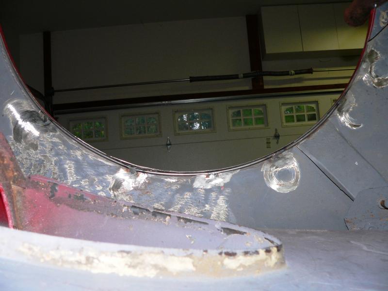

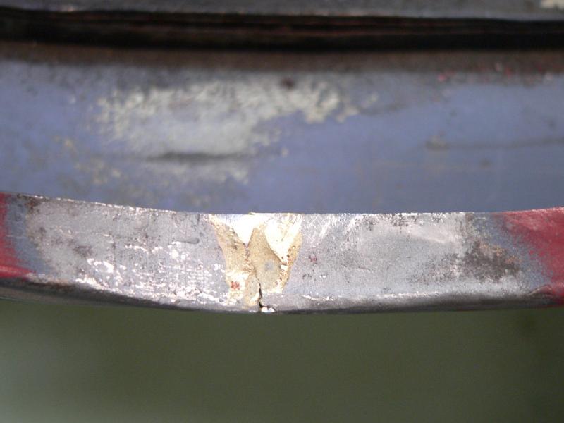

Looking nice Drew! I'm not sure if I mention it? This far along into their work since filler is being applied, may be too late? The apex of front wheel arch is very stressed and cracks can develop in the center. You can use 1/4" or 5/16” round stock to strengthen the wings by tucking tight up into the fold and weld into place.
Got a recommended type of round 1/4" stock and where to find? Frank used to say 1/4"rebar but looking for a source on where to find. Is this something Lowes or HD would carry?
I know JB Weld has also been tried to put this round stock in place. Not sure how it would hold up long term but I need to reinforce a stress track or two on Bugsy's bonnet. Cracks may come from more spirited driving and tires rubbing on inside of fenders as well. The Bonnet I'm using came off of a BE that was using some sort of 13" US type wheel( car was sitting since 1978) and offset and width was far greater than stock BE Rims. Car was auto-Xed. These aren't Vega Wheels something far older with a 4 x 4" bolt pattern.
I have used a piece of 16 gauge flat metal about the same width as the lip. Spot welded it in all the way around the arch. Once finished it was hardly noticeable. The round rod might be stronger. You can get all kinds of metal stock and fasteners from McMaster-Carr. www.mcmaster.com

Thats kinda what I was thinking, a strip that fits the inside width of the lip and spot welded to it...trying to get a 'factory' look.
Thanks for the tip. I'll chat with the shop.
