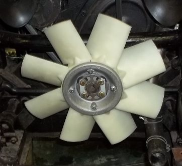

David: Nothing will fit in front of the radiator. You can do a few things, run the TR tropical fan (if you can find one), but a yellow fan and mount it backwards to fit, run a TR6 red fan, install a puller electric fan and delete the TR3 fan all together.

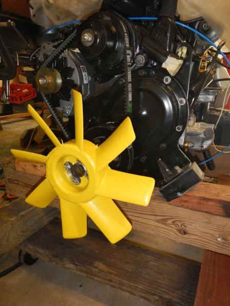

Looking at my Yellow fan it appears as though it is orientated correctly for the engine rotation. Were there some yellow fans that were meant to rotate Counter Clock wise?
David
Mounting a fan backwards does not change the direction the air moves - it's like a nut will thread on a bolt no matter which side of the nut you use.
The reversing of the fan is sometimes needed for clearance -- sometimes spacers are also used. Seems to vary from car-to-car even in the same models. A friend's TR4 was able to use the fan normally, I had to flip it and use a spacer for my TR4.
Do you now have the engine pictured installed in a car? The fouling (if it occurs) is typically that the fan is too close to the cross-member.

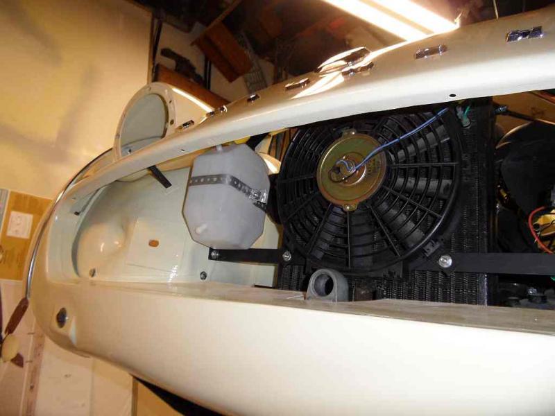

I also have the yellow fan, mounted backwards -and it's still very close to the cross member. Attached is a picture of how two long flat bars were bent to support my electric pusher fan (holes were drilled into the inner fenders). You can also see the temperature probe used to control the fan, and the overflow bottle. On our last west coast trip, we stopped for the day in El Paso, before continuing on thru Tuscon stopping for another day in Los Angeles. We waited until the sun went down and temperatures dropped below 100. Unfortunately, the highway department also waited to repave I-10 until it 'cooled off'. The TR3 never overheated and the stop-n-go traffic allowed us to listen to music for a short period of time.
My TR3 can handle more heat than I can. Living in Houston, it's been tested several times.

The engine pictured is sitting on a test stand at the moment so I did not realize that there was a clearance problem with the cross member. 2 seconds thinking about it and I would have realized that it works the same either way round.
I will find out about the clearance in a few months when I get around to that part of the build.

I have also heard about that BMW fan - certainly a strange looking device:
