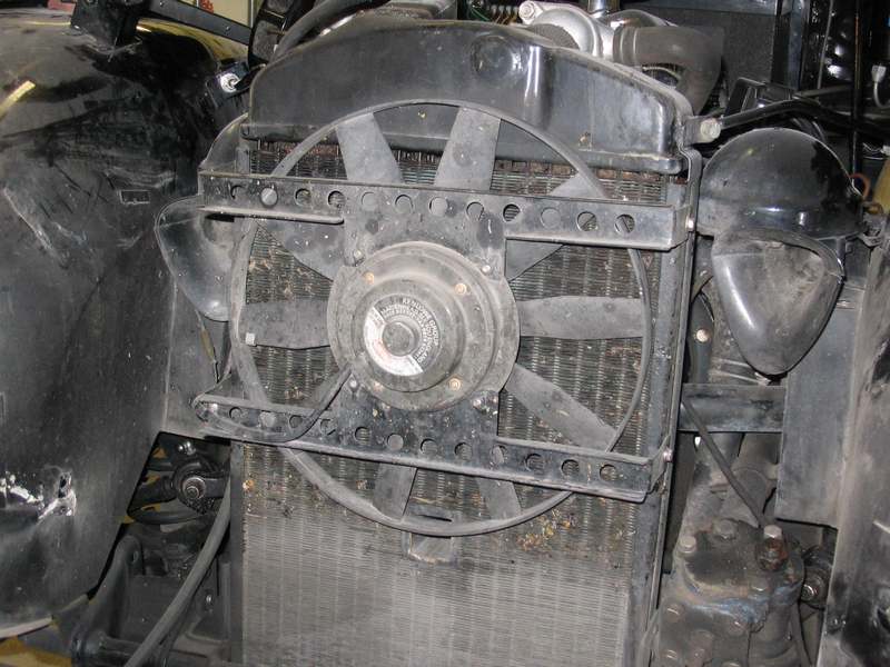

For many years I used electric pusher fans on the front of the radiators to help the stock fans.
The fan I used:
Had to oblong the holes in the mounting tabs to match the width of the radiator:
Used decapitated bolts bent into ells:
Bits of fuel line cushioned the fittings:
Here it is in place:
Wired the hot side to the horn circuit, the ground side to a switch under the dash. Used it for many years w/o problem - just flipped it on when I saw traffic would be slow or when I was starting up the mountain on a hot day.
For the TR3 I had to remove the grille for the install - for the TR4 had to remove the fibreboard duct. Both go back on afterwards of course.
