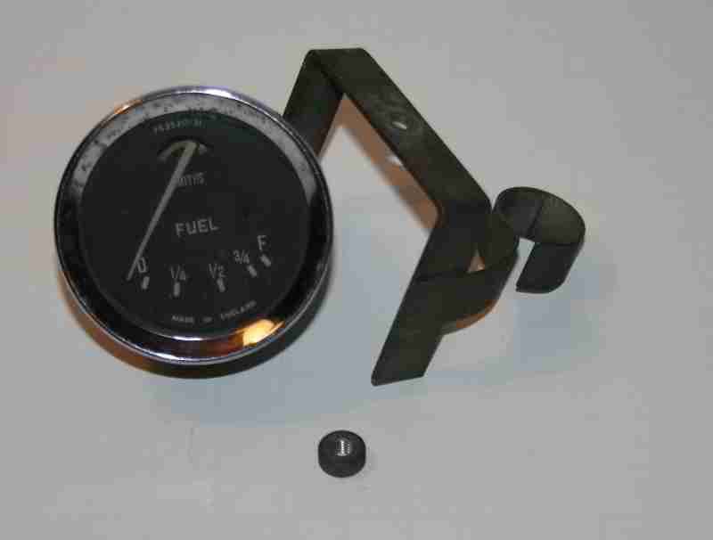

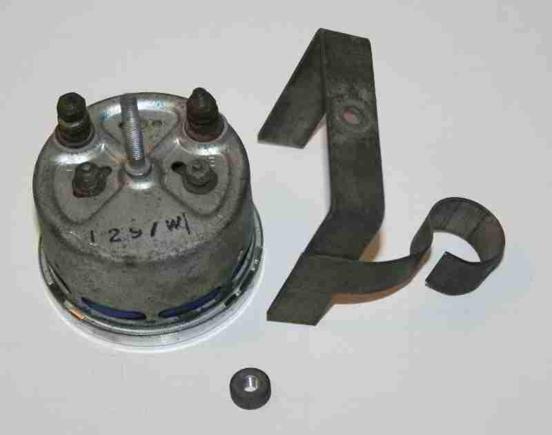

Hey jack, try hooking an ohmeter from the wire that goes to the sender to a good ground and read the resistance. That resistance should change with the fuel level. About any fuel gauge should peg high or low depending on polarity when a hot and ground are applied straight to it. I bet those gauge people will charge a fortune. Be very careful when changing the faces, the inner part you have to work the gauge needle through and not damage the movement.
I think the smoke was coming from the wire that I was using to ground the gauge. The guage seems to be working now. Although it bounces on its way up to 3/4 full. And then bounces back down when I turn off the key.
Oh, one more thing if the resistance of the float sensor is a lot less than that of the meter, the meter might read full voltage even when this realy is not due to the meter not putting enough load on the circuit. Especially a digital meter. Best to work with ohms. Guys you can test a gauge with a 9v battery. It may not go all the way to max but you also are apt to do less damge if it is hooked up wrong. It should move from e across to amost full anyways. At least you can see it move and get your polarity right.
How does the face look Chris? Have you tested it? Whatever seemed to be working earlier is finished. The guage is a 0 and not moving. /bcforum/images/%%GRAEMLIN_URL%%/frown.gif
If it's the induction coil one (and it IS) the needle should move as it is rocked (gauge vertically held) radially side-to-side. It's a central pivot movement.
The needle moves freely from side to side as I roll the gauge in my hand, but unless all my 9v batteries in my "new battery" drawer are dead, this gauge is defunct.
I am very sorry to have raised hopes and then dashed them again.
We have to be able to fix these things and maintain the originality. I know you can send them off and spend megga bucks but there has got to be a better way. Most gauge movements are very simple. I went through my tach when it started hanging up and managed to just bend a piece of metal a slight amount and it freed up. Now that was complicated. Has two coiled springs like a watch. One forward and one reverse. Very good original craftsmanship.
