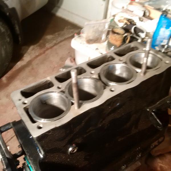

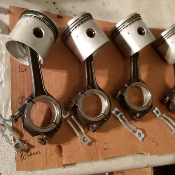

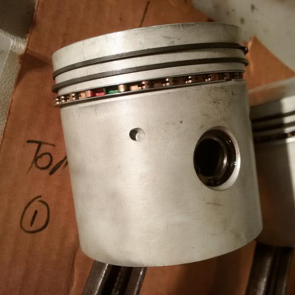

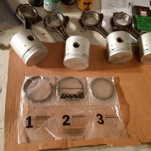

Made some good progress this past weekend. Oiled the heck out of everything and got the liners and pistons in after checking ring tolerances etc. I installed the the crank timing sprocket, but I think i have a challenge with the cam.
The cam spins freely in place and has new bearings including a new front bearing, but, when i try to tighten the sprocket the back of the sprocket rubs the front bearing and rubs... looking at the manual there doesn't seem to be any spacers or anything there... ideas?
Here are some progress pics:

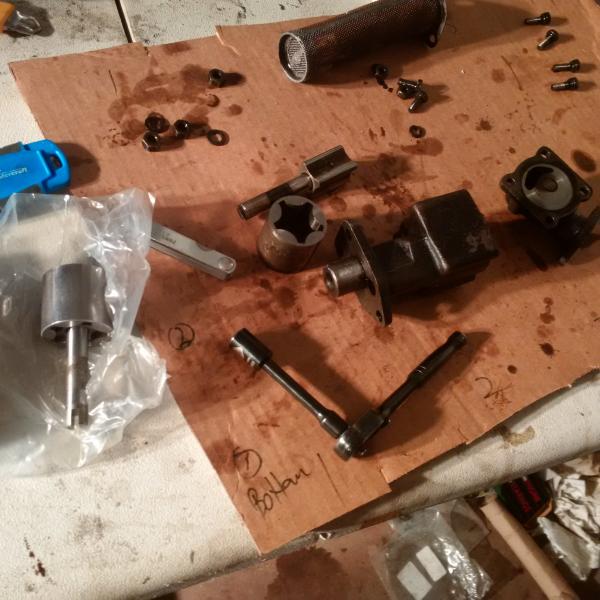

Got the float on the cam dialed in, but in the meantime, and a little OT, that mechanical oil pump is one of the coolest little engineering things I've seen in a while. I looked it up, its called a gerotor derived from generator rotor and, according to wiki, had it's origins in the 16th century, but was significantly advanced by a guy named Myron Hill in the early 1900's - he devoted years to this and worked with another company that had expertise on the manufacturing side (Nichols Portland) - I can't help but think of the creativity and perseverance that went into the development of such an eloquent and robust design...
Yep. If it fails, it's usually due to cracking of the cylinder at the thin points of the star. But even then it still pumps.
