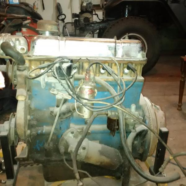

The VIN is 15308LO and I am a total novice with anything inside the head or block. However, I do at least have a target now of trying to get through the machine shop stage prior to the close of the current Moss sale, so I will be diving in this weekend.
I'll be working from the FSM, the Moss blog pages and any other step by step guides I can find. Please feel free to offer basic advice along the way, I find this pretty daunting, but am keen to learn.
I will try to post as many pictures as I can here both to take advice and correction as well as a photo journal for the next person (if this has been done elsewhere, please let me know - I couldn't find any detailed threads)... starting with the engine as it sits today.
Kerry

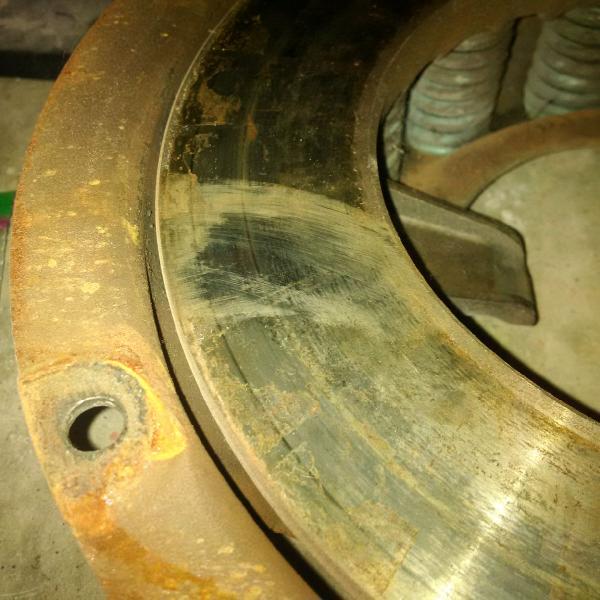

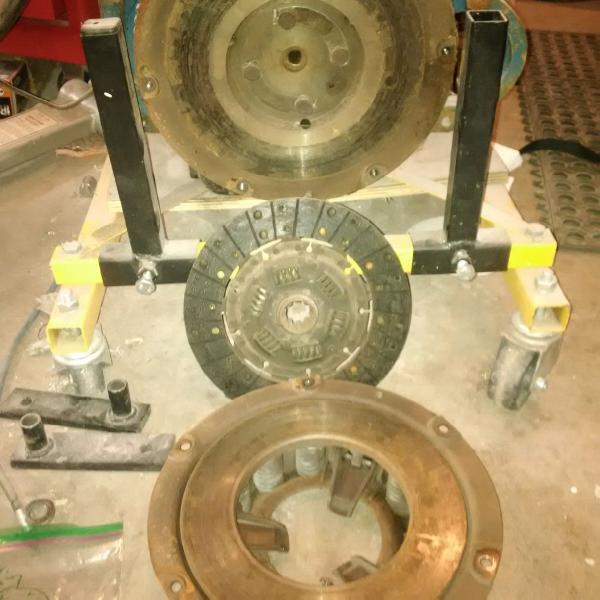

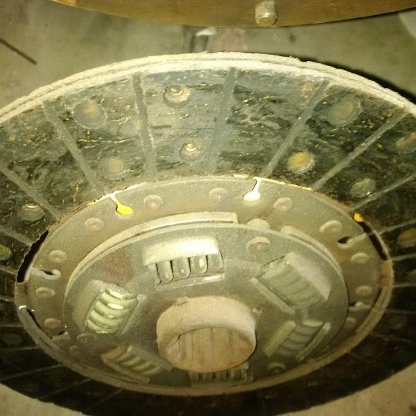

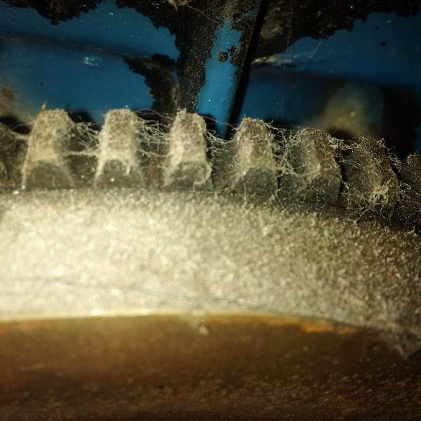

Last night I quickly pulled off the clutch plate cover, pressure plate and disc so I could move toward getting the engine on a stand - I assume the odometer that came with the car was correct at 80,000 miles, is the clutch something you can visually inspect, automatically replace or require a professional opinion on? Despite weight, flywheel looked pretty good to my untrained eye...
Thx!

I had my flywheel surfaced while I was dealing with the shop. Cost of a clutch against the agro of pulling the transmission a few thousand miles down the road.

Replace the disc and pressure plate. (or have them rebuilt). Have the flywheel resurfaced. Do the valve system to deal with unleaded gas. Plane the head. Work clean on the rebuild. Use plastiguage on main and rod journals. Make sure new liners are proud of the block. Don't skip end gapping the new rings. Use STP to lube rod and main bearings. Have the machine shop crack check everything (head, block, crank). Have the machine shop check the rods for straightness. Lots of folks on this forum say to replace all structural fasteners. (Rod bolts and nuts, head studs and nuts; haven't heard such about main bolts). Use a compressible head gasket. Use sealant such as copperkote on head gasket and figure eights. The possible tips are endless, but keep us posted as you go.

I have always replaced the clutch when I had the thing apart for any reason - that is probably why I have never worn out a clutch.
