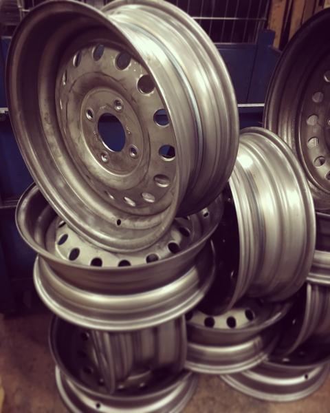

Hi we are currently building brand new sets of 5.5 x 16's and 6 x 15's. These should be built and up on our site early next week if you're interested?
www.wellerwheels.com
