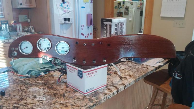

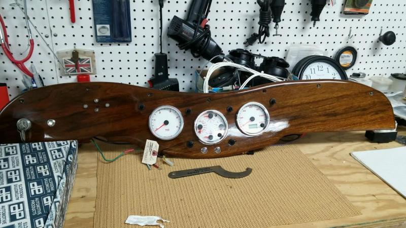

Finally reconfigured the dash, which meant purchasing a new piece of wood which more closely matches the steering wheel. After a woodworker friend planed it down and cut the holes for the gauges, switches and indicator lights, I mounted all the goodies and re-ran the wiring. Pretty pleased with how it came out.
Before and after shots:
Thinking about placing the MG logo from the radio blanking plate on the passenger side for balance. There will also be a grab handle over there as well.
The two push-button switches above the ignition switch are for the turn signals - pretty neat setup. All the indicator lights in the center are Dorman off-the-shelf items; turn signal indicator arrows were lifted from the centers of '69 MGB and JB-Welded in place - they just happened to fit perfectly!
Looking good!
Very nice indeed
Thanks, guys. Although it's hard to tell from the picture, I had the gauge faces, back lighting color and needles changed. They were originally white faced, red background lit, and bright red needles; a bit too flashy for my taste. I sent them off to Speedhut and had them changed to grey faces, green back lighting, and deep red needles. Much more subtle looking.
And the dash came with some black plastic toggle switches, I think from Radio Shack. I put proper Lucas switches in; much truer to form and a lot better feel to their action.
And while I like the idea of having the gauges in the middle, I think the new placement will be better for driving.

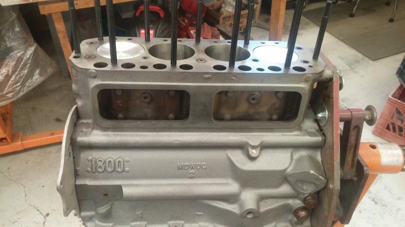

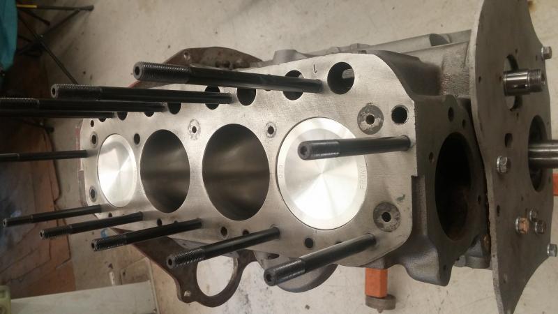

After eight months (!!!) at the machine shop, finally got the motor back. I've begun assembling, and having some fun with it. Took these two pictures this morning; since then, have installed the timing chain and gears, tensioner, and timing cover. Also the oil pump and oil pan. Not in a big hurry, as the paint and body guy still doesn't have an opening, though he ~may~ be able to get to it in a couple weeks. Once I take the body over to him, I'll install the motor and transmission onto the frame and get that all buttoned up - do the startup and break-in while the body's at the paint shop.
May get to drive this thing yet!
ARP head studs?
That's lookin' nice, bro. Have you given thought to CC'ing, port 'n polishing the head? Plenty of info in the "Special Tuning" section of the Bentley MGB manual!
Yep, those are ARP studs. No plans to do anything special to the head; machine shop did the normal work on it. I've no plans to do anything special; just want a decent build on it.
Valve seats?
Valve seats?
Yep - head was completely checked and surfaced. New springs, guides, stem seals, etc. New cam and lifters. .020 on the pistons and .030 on the crank and rod bearings. This is going in a <1700 lb. car and will have overdrive, so performance and drivability should be great. Hope to have the engine buttoned up and painted next week.
