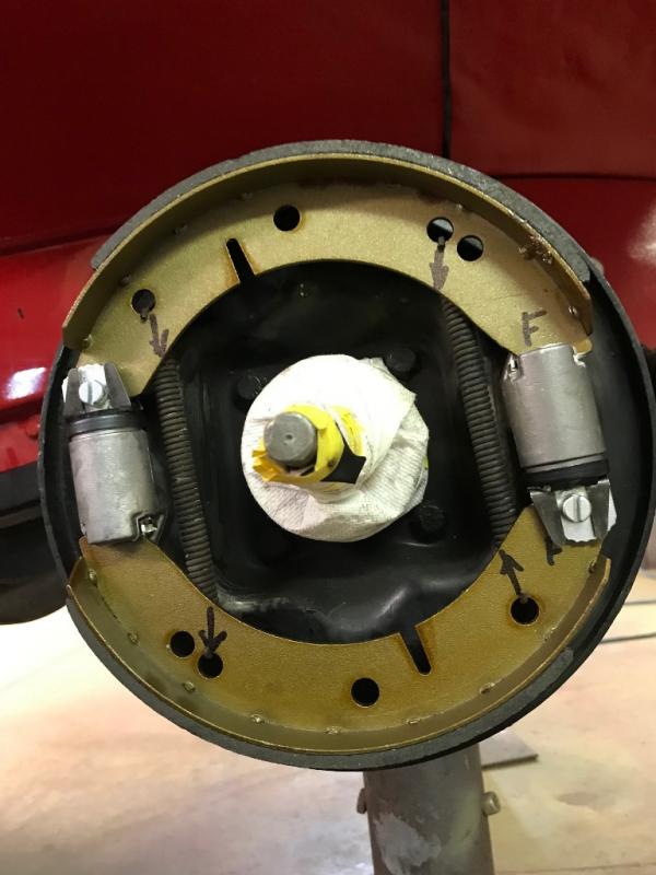

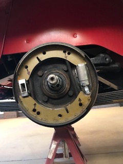

Hello folks, I know it's been a while since I posted but I think I owe you guys an update. The original issues with the TD have been resolved but a few other things have emerged. I'll get to them in a minute. This car has clutch rods and with adjustment the clutch is working fine. I have replaced everything in the brake system and now it is working fine as well. But the rear adjusters are at or near their maximum expanded position. I attribute this to the drums being worn out or the new shoes are not sized as well as they should be. I was not able to get a proper brake drum gauge to measure the brake drums. I can assure you everything is assembled correctly and I am enclosing 2 pictures. The picture of the rear brake assembly shows that the adjuster is very near its fully expanded position and with it in this position I can take the drum on and off with slight drag. There's not much I can do with getting the shoes pushed out further except some "non-conventional" fix which I am not willing to do at this time. I have cleaned and reassembled and tuned the carburetors and they are working perfectly.

See pictures of brakes attached:

Sounds as if your rear drums have been turned one too many times.

I'm still thinking you need to measure the I.D. of the drum. Original was 9". That'll tell you how much they've been shaved down - and if not much, then you know your shoes/linings/adjusters are the problem.

Quite often T owners use a Penney on the pistons under the adjusters to bring back adjustment.
Thank You, I have heard of that.
