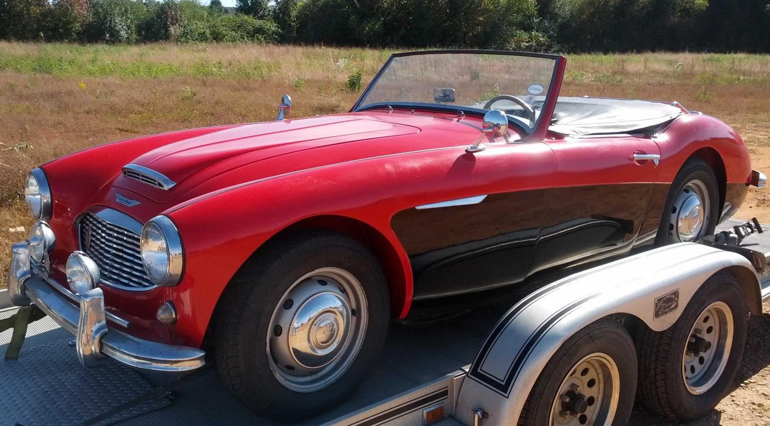

This is mine the day I found it.
BN4L-S-444XX
Built just before yours.

Your car has a non regional engine. The transmission might be original but an overdrive has been added to it. That is a positive and so is the fact that you have a 3000 engine. If your car has wire wheels then that is another upgrade that has been made to the car. All these things can be seen as positive, unless you are interested in creating a concours car based on how it left the factory
