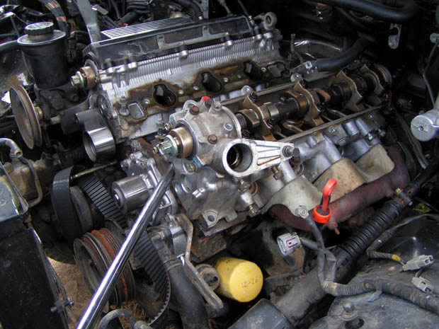

Here's the engine right now...

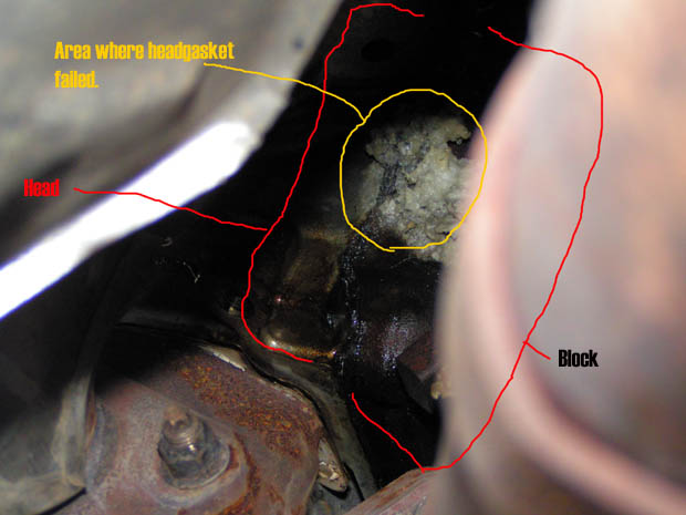

Oh, and while I was under the truck I snapped a pic of the very evil bad headgasket problem on this evil truck engine...

Boy that looks like a boatload of fun Kenny. /ubbthreads/images/graemlins/rolleyes.gif

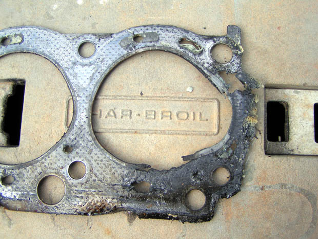

Re: My Toyota - GOT THE HEAD OFF!!!!!
Woohooo! I won't have to do both sides! Man that gasket looks bad...

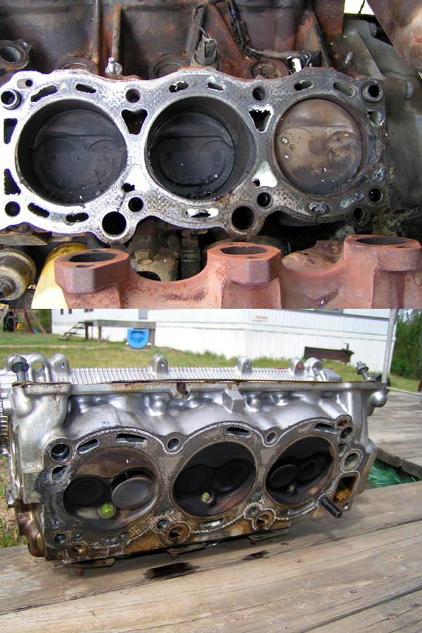

Here's the internals and the head (in case anyone wanted to see...
I had to remove a pipe that runs betwwen the heads - it's bracket wouldn't let me slide the head off of the exhaust... Then lot's of prying and cussing and prying somemore (while being careful not to pry on the mating surfaces)

I was just looking closer at the head... At least the valves are in good shape. I was really worried that the valves, or seats would be burned on that back cylinder. The piston looks a different color, but it's been eating coolant a bit too. Of course the thing that scared me most about it was corrosion in the cylinder wall... But that looks good too. There is some carbon build-up where the gasket ring had moved about a 1/4 inch to the rear of the block, but I think I can scrape it down - no problem. The fact that the plugs said Denso on them makes me think they've never been changed (they are really hard to get to)... but the one in that cylinder had a split insulator, and closed (clogged with crud) gap on it. I really wonder how long it was only firing on 5 cylinders?

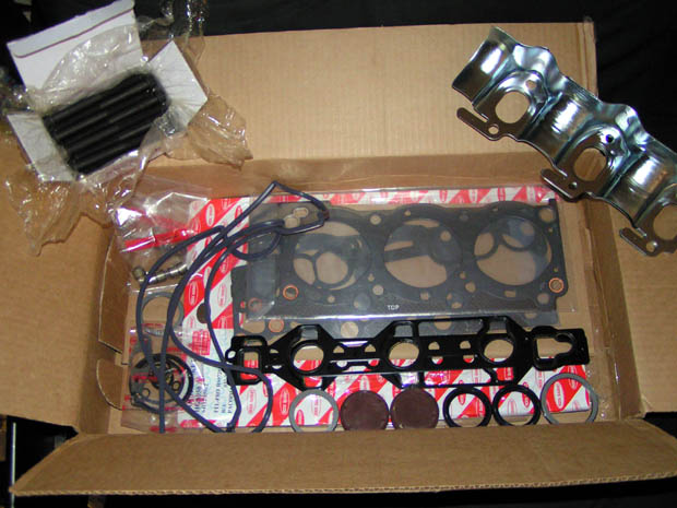

Re: My Toyota - Parts here!!
Wooohoooo!!! Finally! The man in the big brown truck just showed up, and brought me a box full of pretty parts! Rock Gasket head gaskets, intake gaskets, lot's of o-rings, exhaust manifold gaskets (the shiny metal things), valve cover gaskets, cam seals, new head bolts, and a few things I won't get to use like new valve stem seals. /ubbthreads/images/graemlins/thumbsup.gif
Here's the pretty stuff! /ubbthreads/images/graemlins/grin.gif /ubbthreads/images/graemlins/grin.gif /ubbthreads/images/graemlins/thumbsup.gif /ubbthreads/images/graemlins/thirsty.gif /ubbthreads/images/graemlins/cheers.gif
I'll start puting it in next thursday. I hadn't really geared myself up for reassembly yet... And I figured out I will have to remove the cams to get 4 of the head bolts out all the way, and I have one (isn't there always one) cam bolt that the head is stripped and I can't get loose. /ubbthreads/images/graemlins/rolleyes.gif
