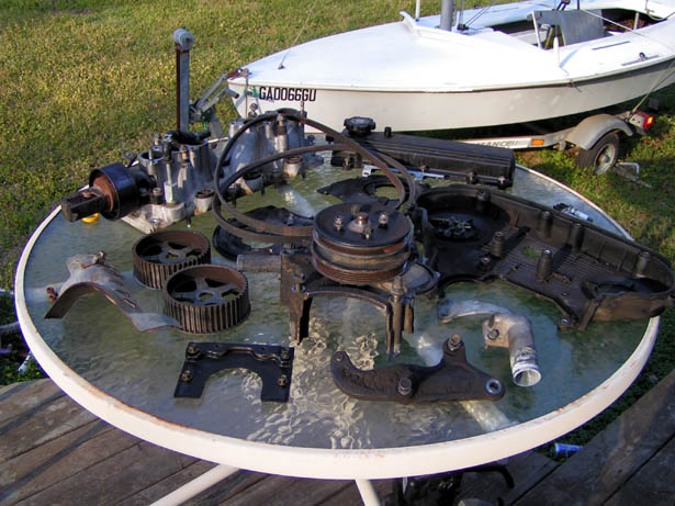

well, I'm done for today... Got the left head loose (this is the one that had the headgasket blow), but the exhaust studs won't let me get it off /ubbthreads/images/graemlins/rolleyes.gif
Oh, well - here's todays parts table...

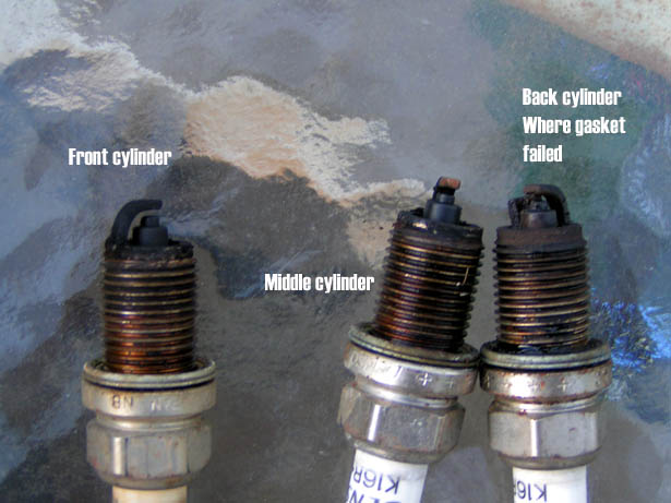

Interestingly.. I figured you guys might like to see what the plugs in this head looked like...
The one that was in the rear cylinder, looks like it's been through heck.
