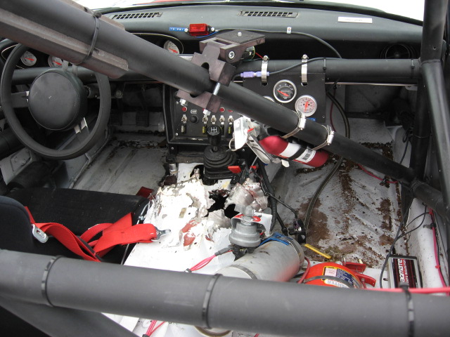

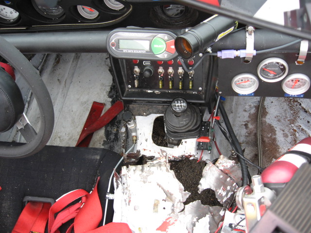

If you decide to make your own, please look at these pictures of a JH that threw its half-assed homemade driveshaft. Remember that when you are turning 7000 RPM in top gear that the driveshaft is also turning 7000 RPM!!! Balance is critical.

eeep. That coulda been a ~REALLY~ bad day. Femurs don't grow on trees, y'know...
I've only ever had ONE piece of driveline let go: inner +2 "donut" at low speed. THAT made a mess. Can't imagine what it would be like to try gatherin' up somethin' like that at racing speeds. Off-roading as a first consequence, I guess. /bcforum/images/%%GRAEMLIN_URL%%/jester.gif
