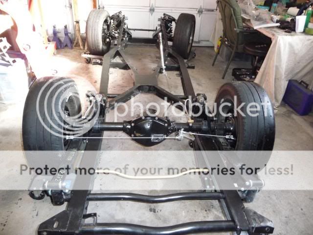

The chassis looks very good. I do agree with Peter about the lag screws. I think I would thru bolt the mounts to the frame with a plate welded to both sides so you don't crush the frame. Or at least weld one plate on the bottom of the frame and thread the holes. Over time those lags will come loose and damage the frame. Everything else looks great.
PeterK said:
Eeek - lag screws, really?.... Lag screws are for joining wood and most certainly rip out of your frame taking bits of frame with it.
I second Peter's Eeek!!!
That's cat-arse-trophy waitin' to emerge. It'd be better to solidly mount it now rather than do damage control later, IMO.
When I break the welder out to work on the body, I will weld on some plates top and bottom and come up with a better solution as suggested.
Will do it at the same time that I weld in anothe tube inside where the rear shackles mount.
Thanks for the feedback.

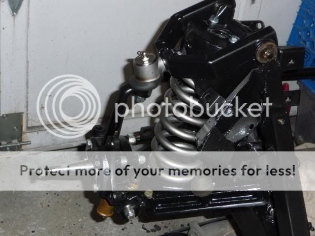

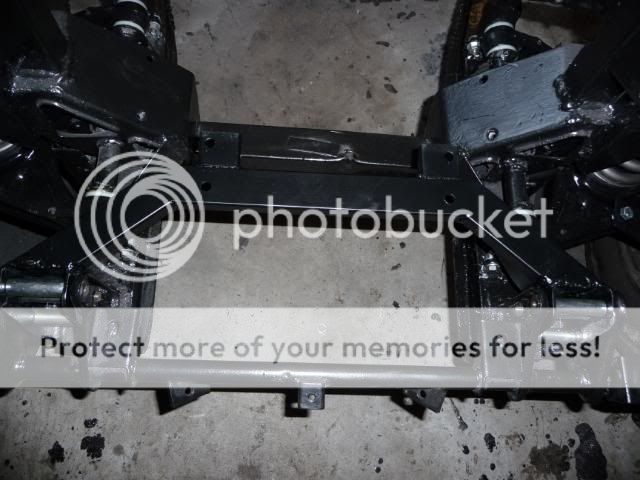

Quick Update.....
Finished Up the front suspension this evening and will fit the new steering rack tomorrow....steering arms have been reversed as instructed for installation of the rack conversion.
Please excuse the rusty rotors.....I resisted the urge to buy some new ones...

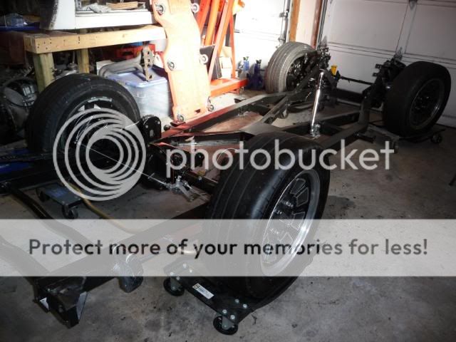

Nice to get it back on 4 wheels!

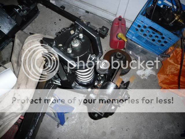

Started working on the Rack and Pinion Conversion today as well. I installed the mounting plate and test fitted the rack and then took it off again...I think that I will install it fully after I drop the engine back in it.
Cheers,
M. Pied Lourd
Looks to be on 12 wheels from here... :jester:

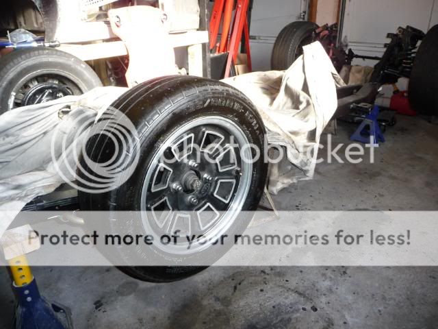

In the last six weeks I've managed to clean and PAINT the pieces for the last of the suspension rebuild.
*sheesh*
Very nice!
Have you shown those rims before? Can't remember drooling at them earlier, but I am now. What are they?
Also- noticed you didn't opt for the later style ball joint / 3 degree trunnion - was that intentional, or just not considered? Rims look pretty wide, maybe that later style would give interference up front?
Keep those shots coming!
Randy

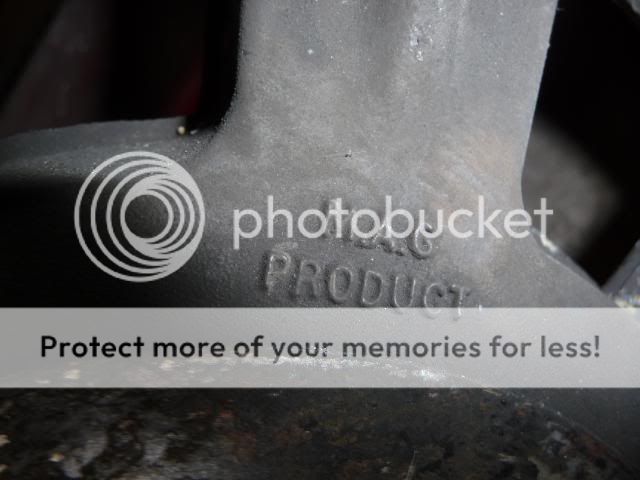

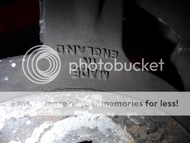

Hi Randy,

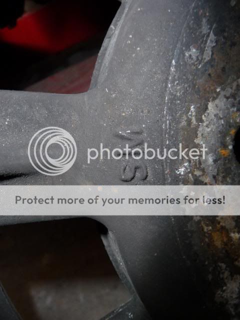

I did post once asking if anyone knew the origin of the rims when I first bought the car.
I found out a little more about them after I dug them out of the storage shed this morning. Wondering if anyone is familar with these rims or the company that produced them. Here are some pics of the backside.
I cleaned one up a little bit just for fun. I plan on re-painting and polishing the aluminum . I wasn't intending on using them, but I have to admit that they are growing on me....
Here they are in action
I didn't consider the later suspension set up as I am trying to build this car with the parts I have on hand between the good car and the parts car.
Cheers,
M. Pied Lourd
I hadn't seen them before, but they may be Dunlop's, as shown by Quiller:
Dunlop 13"
Just my opinion, but I think the look works, especially if you are staying with a racer look.

Also be sure those wheels are aluminum and not mags.
Hi Folks,
I`ve seen those rims on an MGB (I Think). I`m quite certain they are a "Stock" rim to somesort of Car but Which one ????????
Regards, Russ
Hi Folks,
I just thought of one. Would it be to an "MG Midget"? "Na"; Their not "15" inchers on a Midget!
