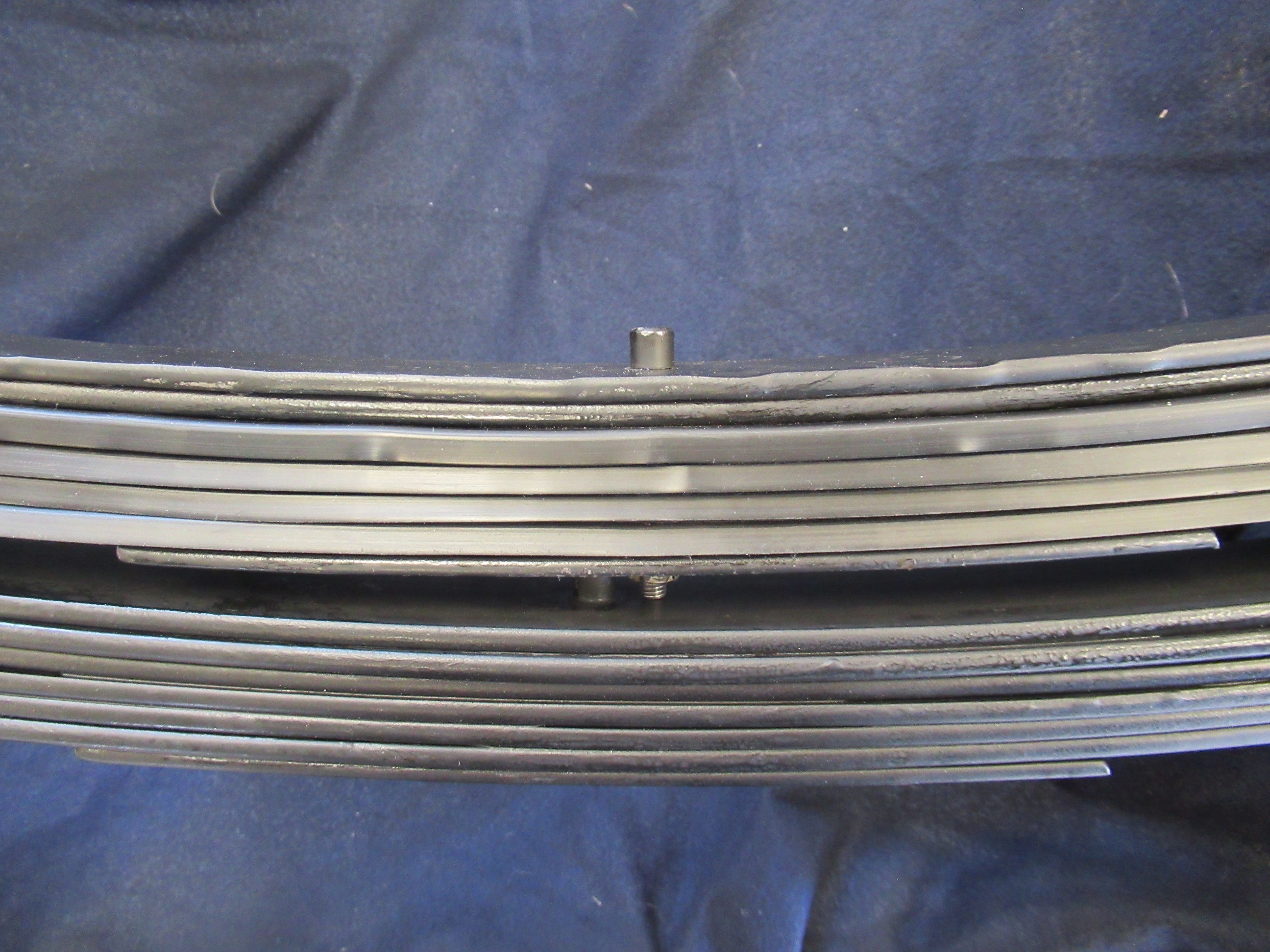

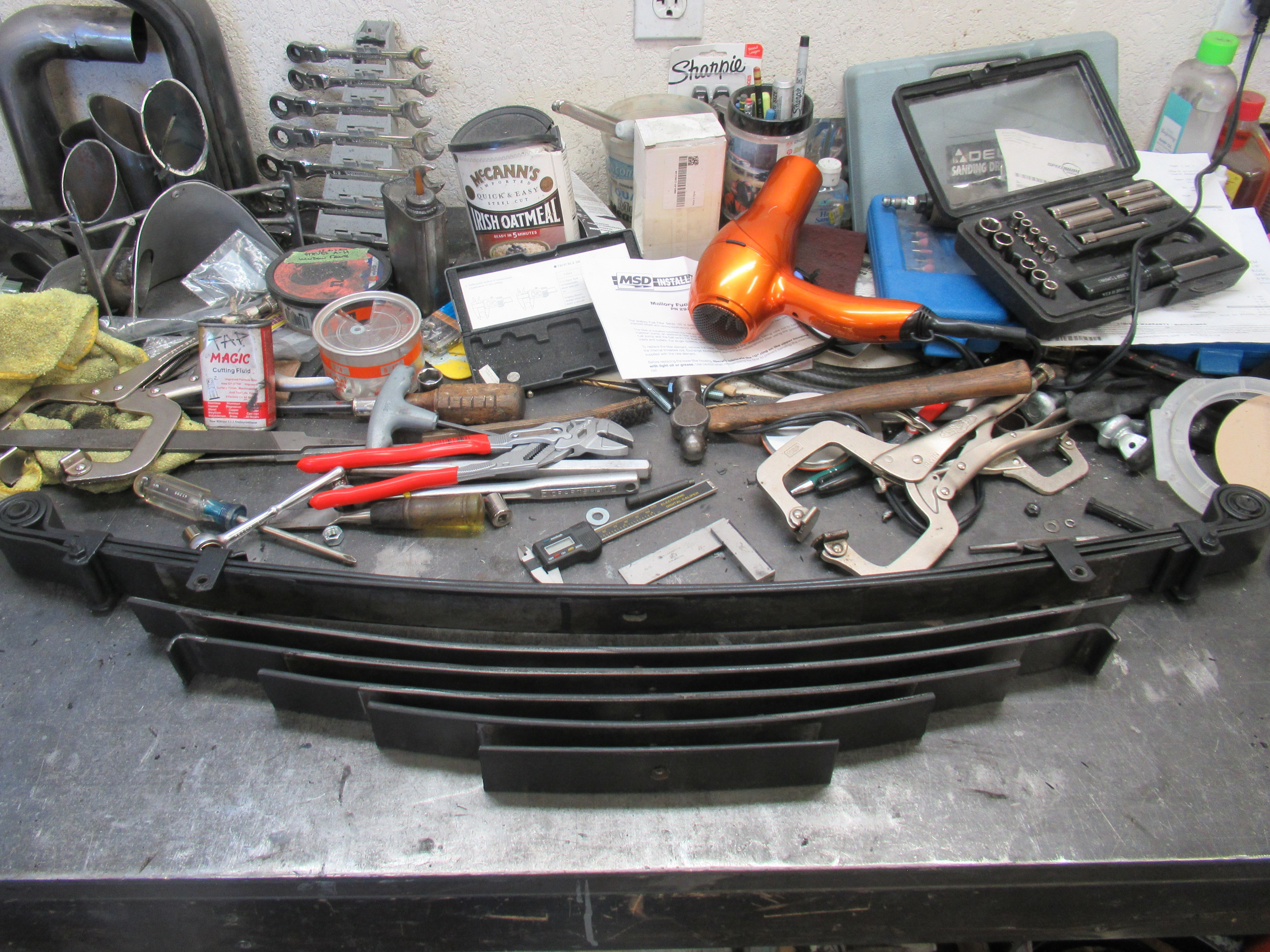

I've installed them. The car is undergoing full restoration and it's not on the street yet. Write up was in November 2022 HM.Has anybody tried the leaf spring liners? Cut to fit. They might add a bit of height also. View attachment 86495

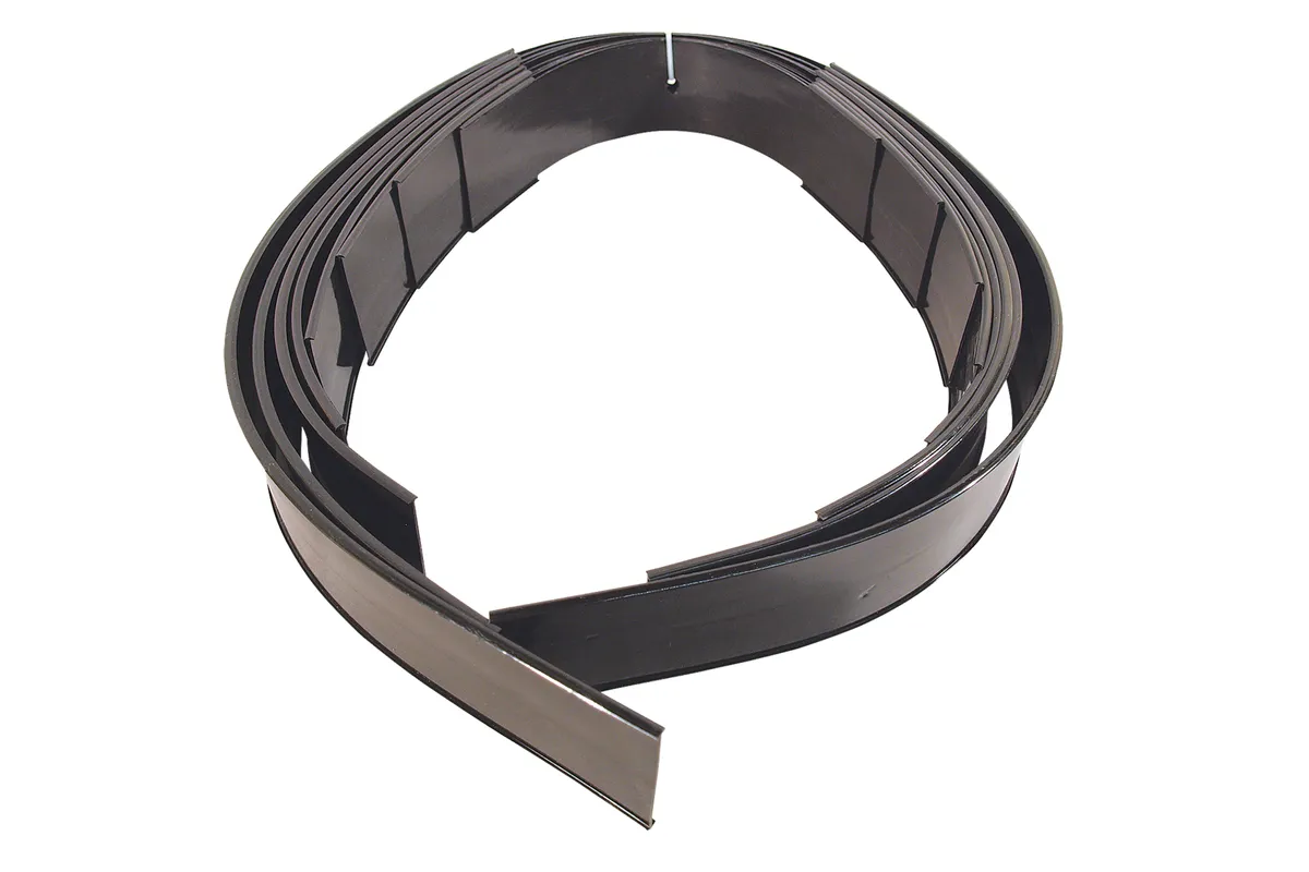

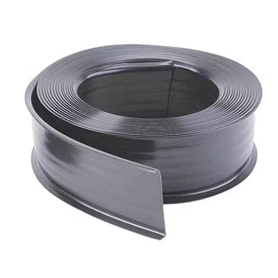

The advantage, at least theoretical advantage, of the lip is that it keeps the liner in place.View attachment 86592There are other liners that don't have such a large edge on them. I think they would look a little better on the finished spring.
