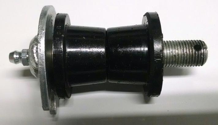

Tom's sells flexible poly bushings without center tubes, which he says have lasted 20 years on his car. In their shop, they've started drilling the pins and fitting grease fittings.

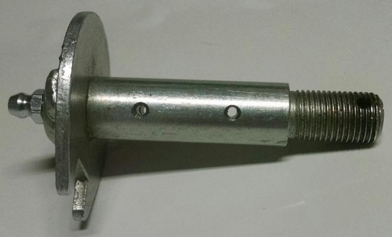

I performed a proof-of-concept on a spare pin. Lengthwise drill - 7/64", cross drills - 3/32":
Is there, or would it benefit from, a grease track on the bush ID?
Danny
I don't think it's necessary as the extreme hydraulic pressure from the grease gun (combined with flexible bush material) forces the grease around the inside bore of the bushes. It certainly did that on the bench.
Like the designers in Detroit used to say: "Too much is just enough."
Addendum: when one goes to all the trouble to remove the sqeaking bushings from the lower suspension arms, if one has the tools (drill press, v-block, 1/4-28 tap, grease fittings) not that much additional effort is involved to add grease fittings and ensure not having to disassemble the bushings ever again.
Got one side done. Noticed the sway bar bushes are also a source of squeaking. Easy to fix with Copaslip or the like.
After spring removal, removal of pins with old poly bushings is a piece of cake compared to original rusted-sleeve design.
