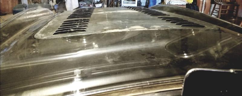

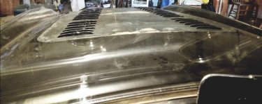

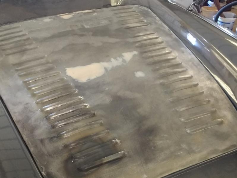

There are some photos earlier in this thread. The one that Ray sent in looks to be something that was either an original die or one that a machine shop made. That is the only way to get absolutely uniform louvers. With the dimensions given previously in this thread you could have someone make a die or buy one from Mitler (they do make a 5 " die that is probably very close to what the 100Ms used). There is also a photo in one of my posts of the simple female die I made that I am now using with enough success to make me happy. I made my own forming hammers for use in a 2X aircraft rivet gun and using my female die can make a louver in about 2 minutes, once a slit has been cut. On close inspection they will look a bit rougher than the punched louvers but so far I am pleased and will end up reassembling and painting my modified bonnet. I've stopped for some coffee (probably a bad idea) but should finish this afternoon and will post a photo of the unpainted job.
Coffee did the trick, finished up sooner than I thought. Here are some photos that are the rough louvers . I still have a little hammer and dolly work to do to even out the crowns. A byproduct of hammering these out is that the metal inbetween each louver actually gets stretched a small amount and that also need to be shrunk back down although I could leave it. I've tried it both with and without using heat and it is such a small amount that it almost makes no difference so I'll cold work everything. The edge of each louver also needs to be touched with a file.
