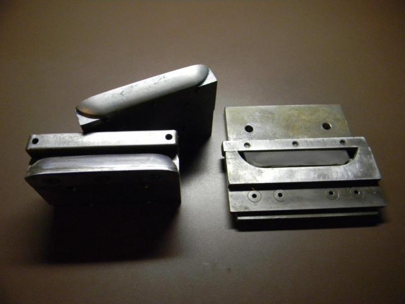

I think we talked about this fairly recently but in any case I distinctly remember a fellow who used to advertise in the classifieds of either "Healey Marque", the AHCA magazine, or "Austin-Healey", the one put out by AHCUSA. His first name was Paul and he was from the Denver area. He claimed to have the proper dies for the M louvers and assumedly if you sent him your hood he would do his magic. He also advertised some of the harder-to-get tools in the 100 kit.

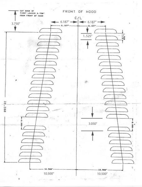

Here's a layout and pics I received from Kent Lacy:

Rick, I cant thank you enough. Is it possible that there is anthing you have on the dimensions of the louvers themselves? I can get close enough from the scale drawing in terms of length and I know they are flat topped louvers but iI don't know the louver height. I'm not a concourse guy but if I can get something to look proper I will. If I can obtain the louver drawing I'd consider making a die. Thanks again.

Jon,

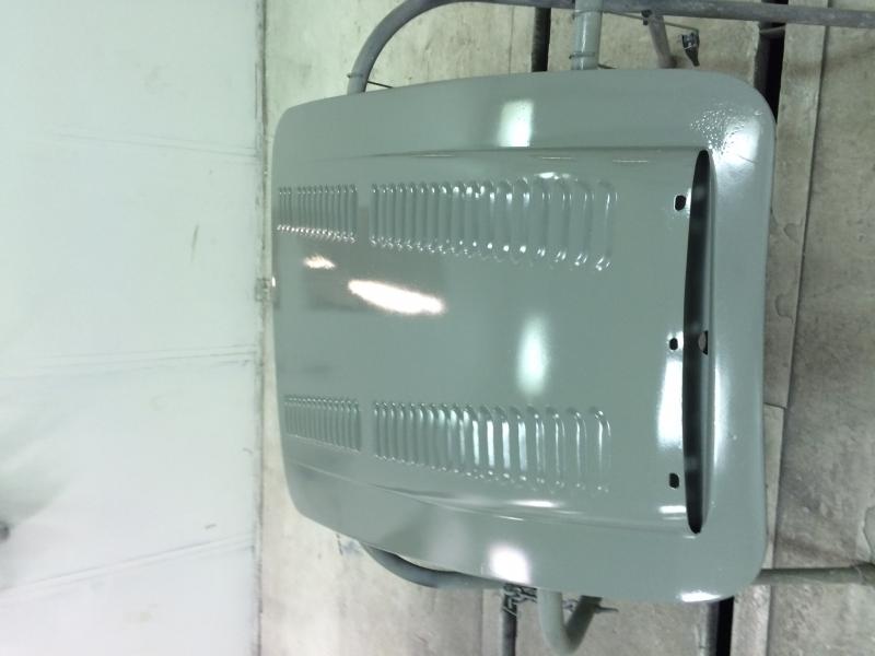

I don't have any further information, but I've PMed Kent Lacy's email to you and he should be able to help. I do know the proper "M" style louvers have a different profile than American ones. Good luck on your project. I opted to have a local hot rod guy punch them for me in the hood of my BJ7. Still working on all the hand sanding that goes along with getting it ready for paint. Tedious.

That looks very nicely done. Yep, it's almost all in the prep work. It is almost scary how little time it actually takes to shoot a project if you only consider spray gun time.

Do you have what you need?
Kent
roscoe
roscoe
Absolutely, thank you. I think I sent you a PM. I will probably make my my own die set but you have supplied what I need to get started.

There was an old hot-rod guy in Toledo that stamped everybody's louvres. 1950's prices, something like a couple dollars a strike (he drove the delivery truck for the local autobody paint store).
THE ONE criteria, was that he would only punch them on stripped/smooth-sanded panels; I'm sure that was for the benefit of the novice that didn't understand the gravity of the situation, though I didn't question him on it (it already made plenty of sense to me).

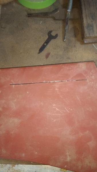

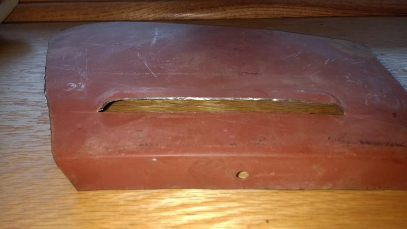

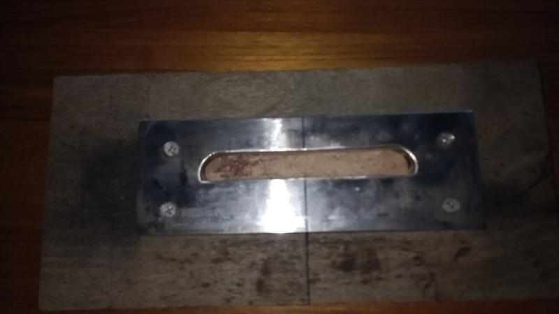

This how I imagined retirement. Not digging trenches, working on farm equipment, or dealing with one of the 6 toilets on my property. Thanks to the generous help of those who responded to my inquiry about hood louvers I have banged out my first prototype using only the tools and materials I had on hand. My shop is pretty low tech compared to some of the BCF regulars.
The first ones I made using the die in the photo were using .020" steel because I figured it would be easier to find the procedural errors. They did not end well. Forming the basic shape was not too bad but both ends cracked. I was pleased to find that issue went away when I used a scrap of a dogleg repair which is about .040" and essentially the same as the bonnet material. The die is 3/8" plain steel screwed to some oak. This is essentially the method that is found on the Mad About Morgans web site. I regret I can't tell who wrote the piece but the louvers shown in the short article were beautifully done in the same manner. I did use an aircraft rivet gun with a brass set in it to do most of the forming and reverted to a body hammer and an assortment of bits and pieces for dollies that I shaped to get the corners close to what I want. The only thing I am not pleased with is the method of cutting the slit that replaces the punch cutting edge when a press with matching louver dies is used. I made the slit using a very thin cutting wheel in a dremel tool; it is about as thin as you can get, short of using a sharp chisel to chisel the slit. I didn't want to do that to avoid deformming the metal but in thinner steel people do that. The steel is forgiving. Anyway, I will chronicle any further developments and I hope to have a louvered bonnet by the time really good driving weather rolls around. I figure by the 35th louver (there are 40) I might be pretty good at this.
