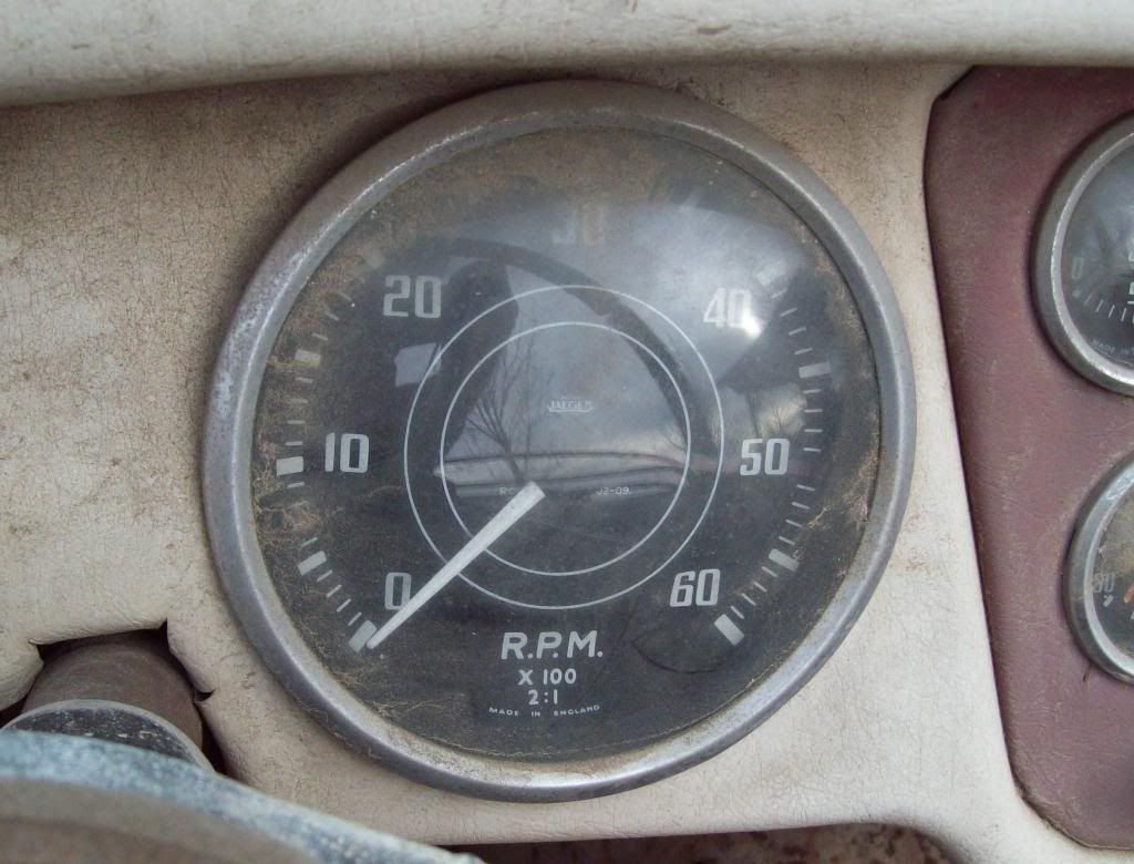

Mine started really nasty. The car sat outdoors for 25 years, and there were water marks showing the tach had filled at some point. I removed the scale with very fine steel wool. I polished a few scratches with a buffing wheel on a drill press, and then finished with windex.

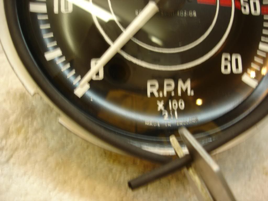

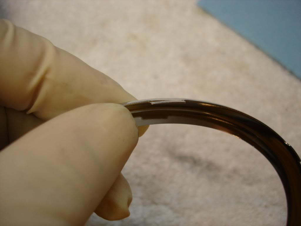

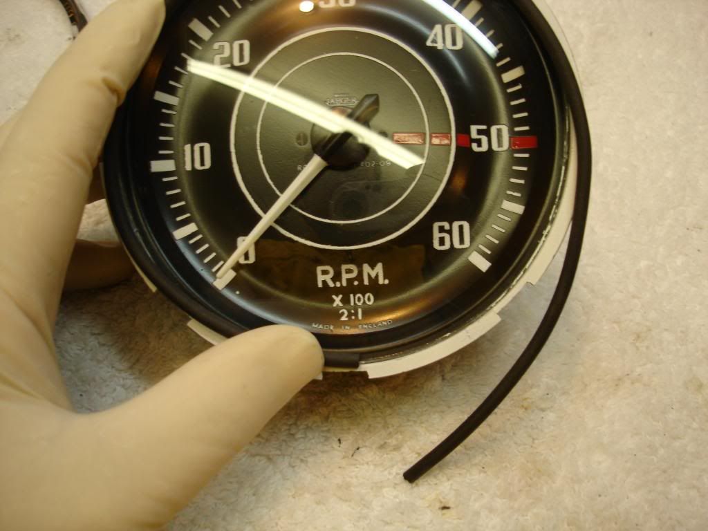

The rubber seal fits in the gap between the glass and the case, so it touches both. This is important, as it seems like it should go farther outward, just touching the case. It must touch the glass to protect it. Trim the end for a good fit.

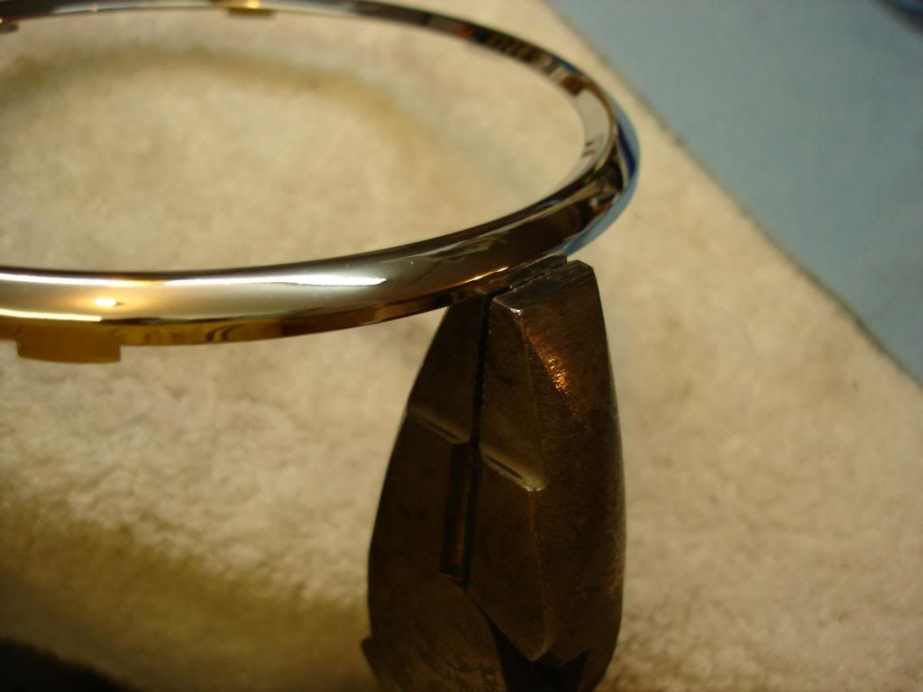

The bezels come with the locking tabs straight out. The tabs will need to be bent inward. Start this with a large set of pliers, bending about 30 to 45 degrees into each tab.
Then carefully place the bezel over the tach. Care must be used to keep the rubber seal in place, all the way until the bezel is fully locked. The little thing makes a run for it at every opportunity! Once the bezel is in place, flip the tach face down on a padded table. You now must finish bending the tabs the full 90 degrees to lock the bezel in place. Work around the bezel using a dift or screw driver and only hand force. Do not hammer, as you could knock the needle off. A firm push is all it takes since you already started the bend. It also helps if you rock the tach towards the tab you are working on, so the bezel is on the table, instead of just the domed glass on the table.

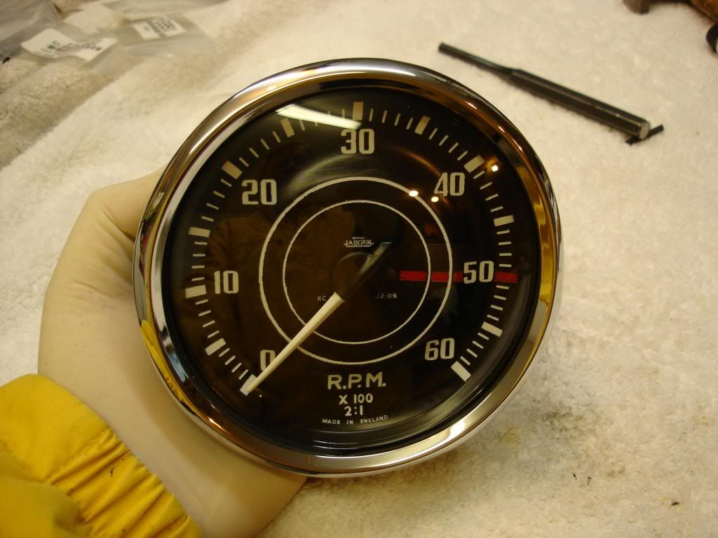

And...the tach is done and ready to go in storage for the next couple years. One down, and 5 to go! Here is a before and after shot...
Next I move to the speedo...stay tuned!

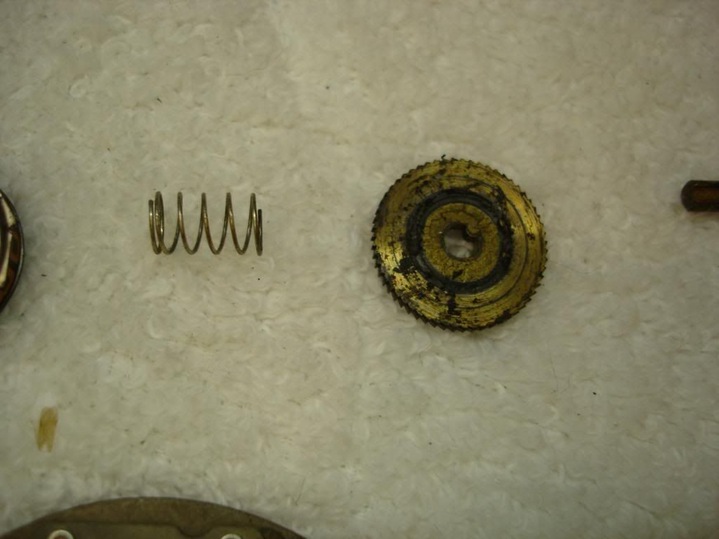

The large brass disc on the spinner is the worm gear for the odometers. There are 2 gears that slide into the housing to mesh with the worm gear...one on each side. One is for the top trip ododmeter, and the other for the lower mileage odometer.
These gears have little cogs on the opposite end, which wobble...
The wobbling cogs transfer this wobble to an arm...
Which simply pushes on a brass ratchet gear that you can see on the end of the number wheels...
The brass ratchet gear spins the shaft for the number wheels, but the wheels are held from spinning constantly by the shape of the edges of the wheels, which catch on these little reeds on the housing...

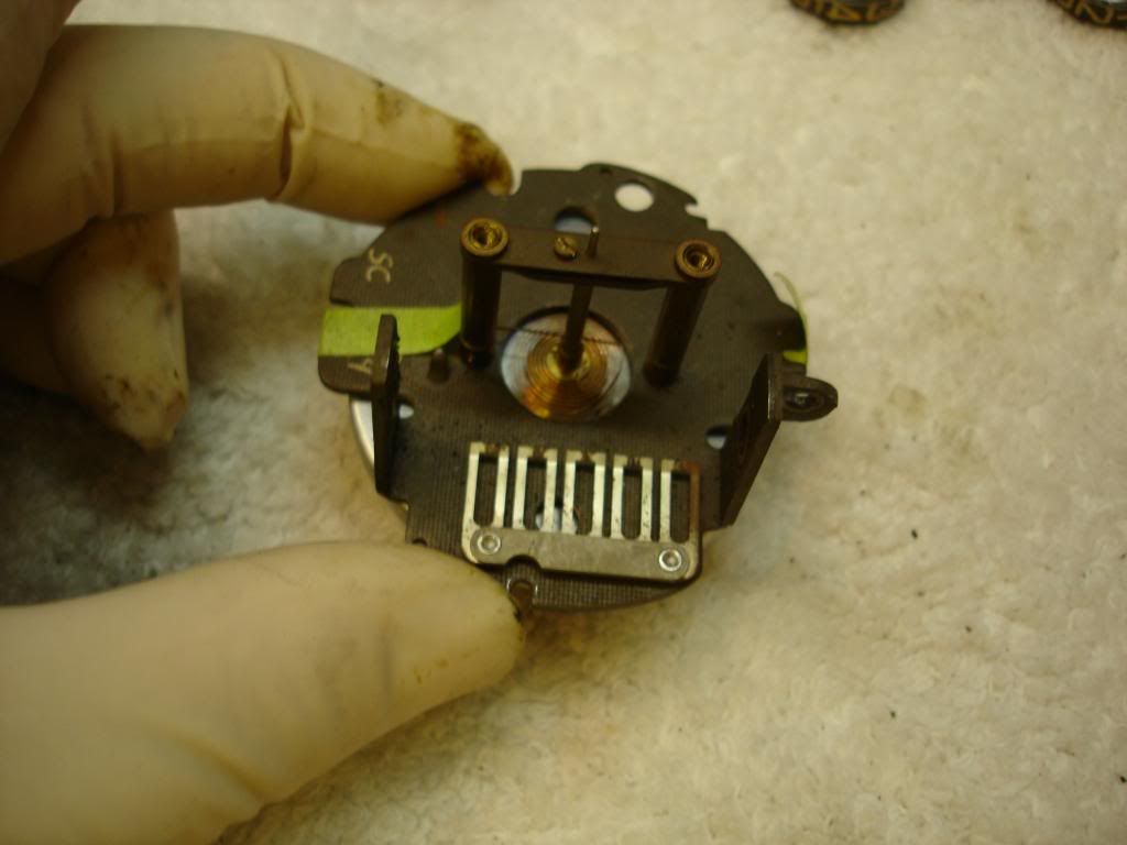

The initial disassembly is identical to the tach...so I won't bore you again. Once you have the assembly out of the case, needle removed, and face removed, you are looking at this...

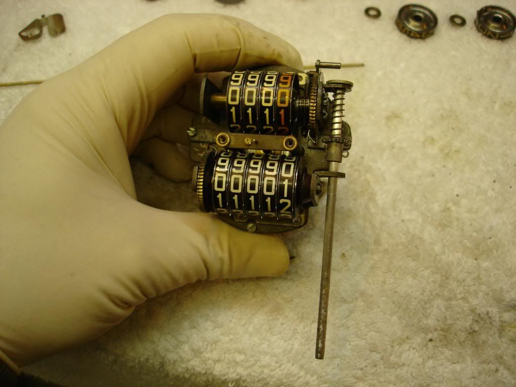

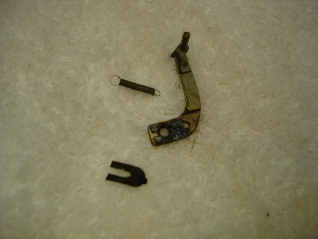

The long rod is the reset shaft for the trip odometer. I have 4 old Smith's Jaeger speedos, and all 4 had broken reset shafts when I got them. There is a hole through the shaft to hold the reset knob, and the shaft breaks at this weak point. I will cover how to fix the shaft later. The reset shaft slides out once you pry the little cotter key off. These are the parts that slide off with it. Set them aside.

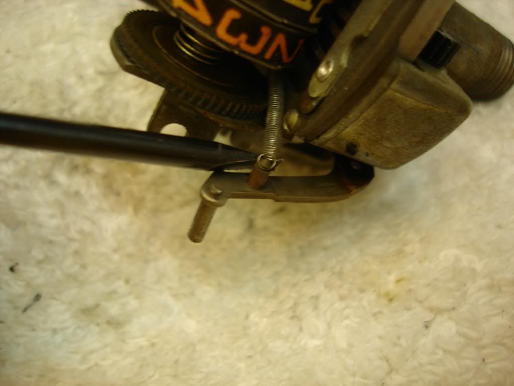

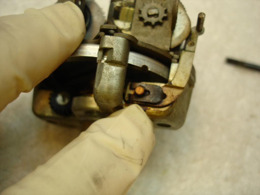

Each side of the housing has a toggle arm, held with a clip. Simply lift and slide the clip to remove. There is a small sping, which has to be unhooked before removing each arm.
This is the trip odometer arm...it is distinct in that there is a bar at the top for the reset shaft to press while you spin the numbers to zero.
The mileage arm is shorter and has no bar at the top...

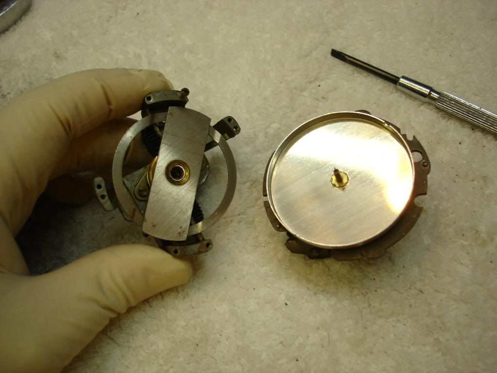

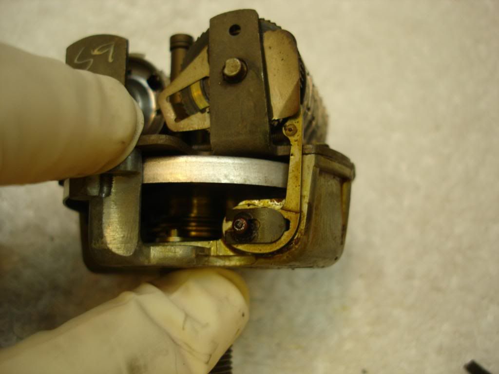

Now, by removing 4 screws, the housing can be separated from the needle/odometer plate...
The trip odometer assembly falls free at this point...

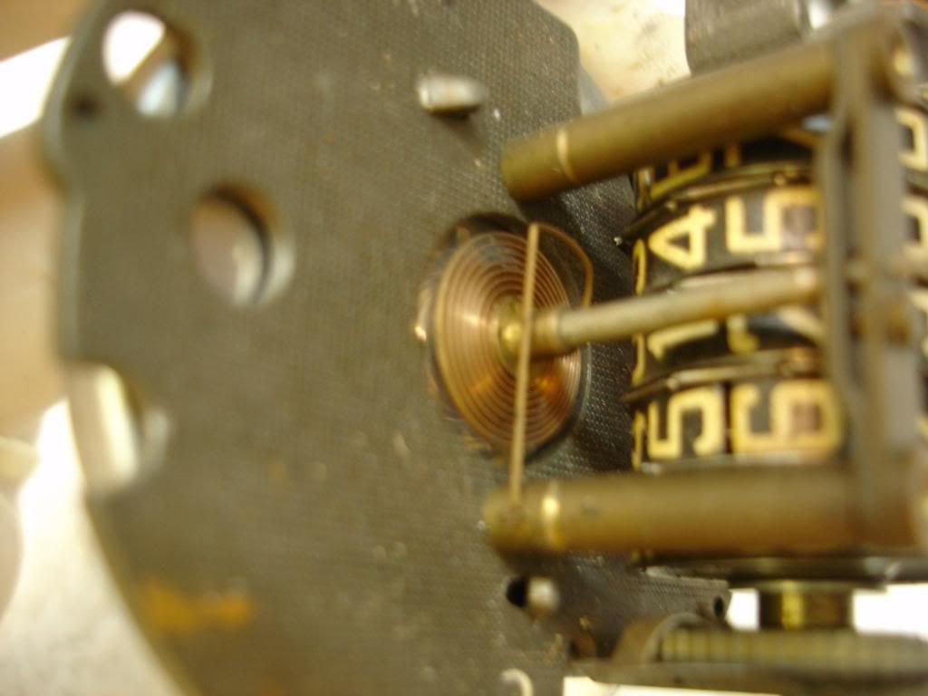

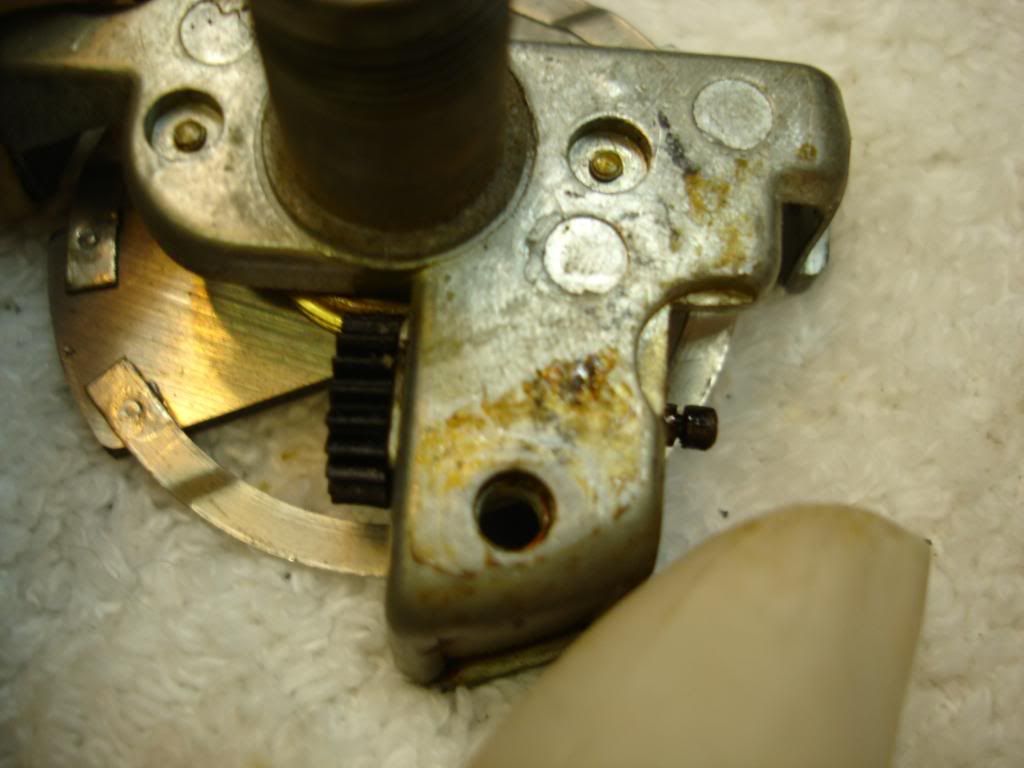

Once again, as with the tach, the aluminum disc is only being held by the fragile clock spring. Support the disc until you place some tape to hold it from getting "sprung"

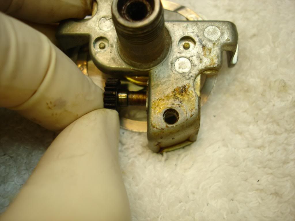

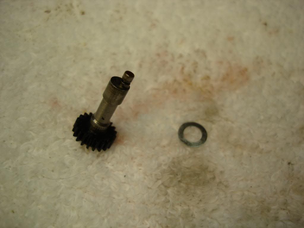

The 2 drive gears can now be removed. If the grease is hard, you may have to tap them out. Note that the gears are plastic, so look for a broken tooth at this point. You need a replacement if you have lost a tooth...
This shot shows the gear, and the eccentric shaft coming off the end.

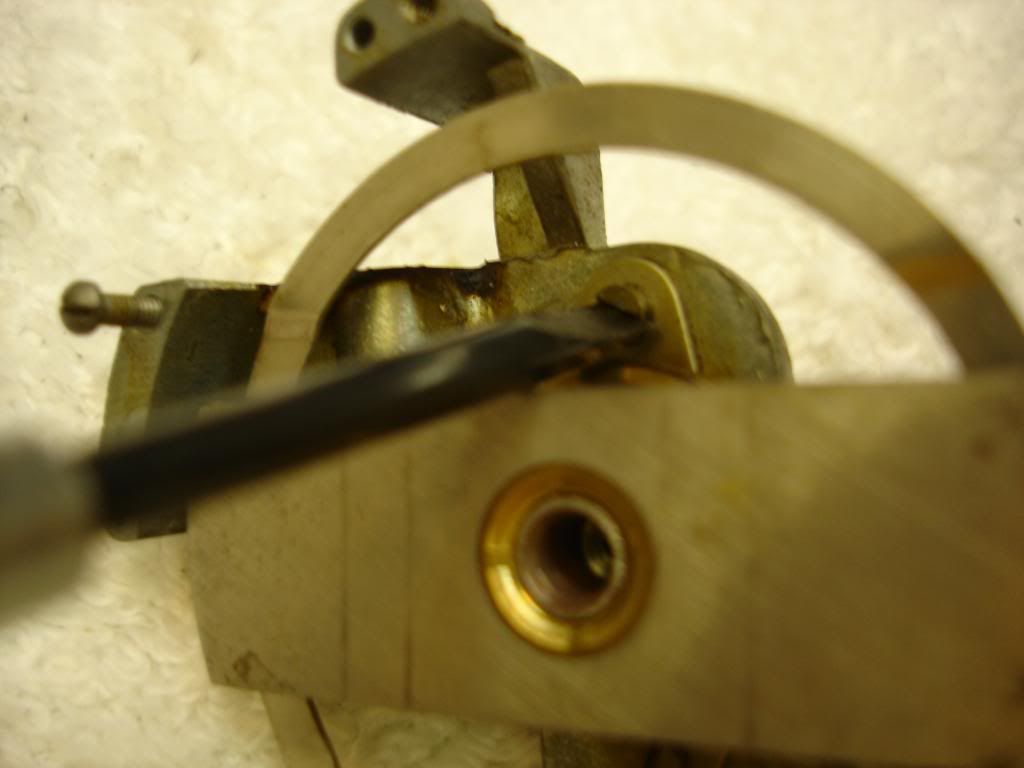

Now the rotor can be remove by reaching through it to the retaining plate, just like on the tach...

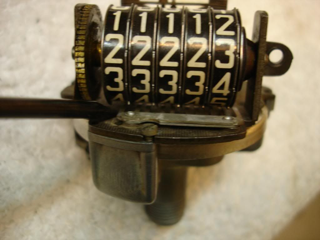

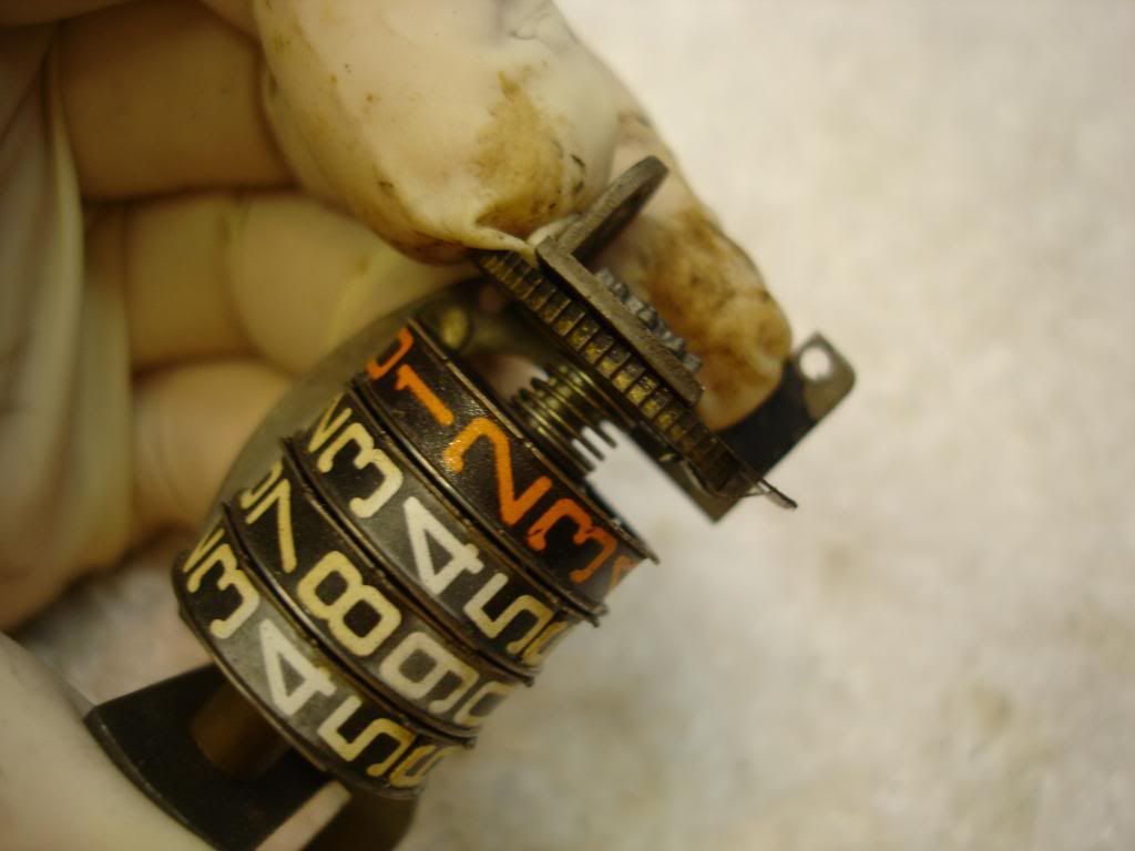

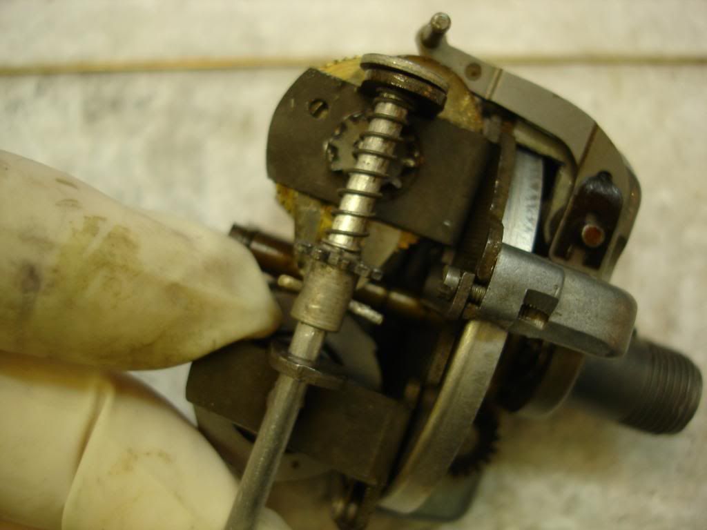

Now, back to the number wheels. We'll start with the smaller, trip wheel. This is what you are looking at...
(you'll notice it seems like I'm being obsessive with the number of pics and angles. Although the wheel assemblies are simple, there are a LOT of small parts. You will need as many picks as posible to avoid confusion when it comes time to reassemble!)

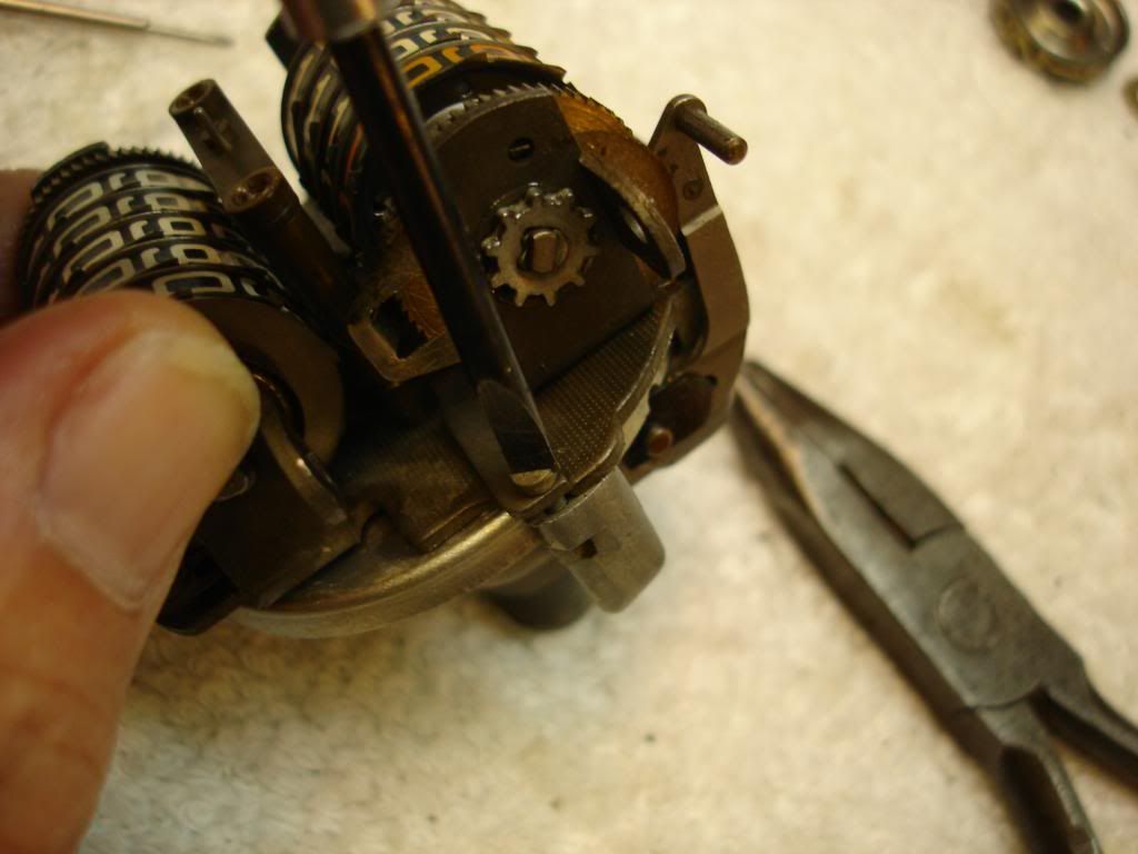

This is the end of the wheel with the brass ratchet gear. Press the brass gear towards the numbers, and this clip plate can be pulled up and out...
Now the shaft can be slowly removed, carefully removing each wheel one at a time. There is a small brass washer between each wheel...remove these now, or they will fall off the number wheel when you are not looking. They are easy to loose...

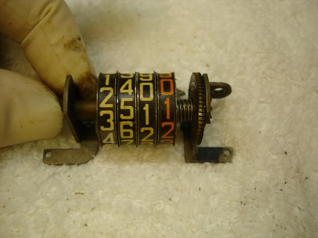

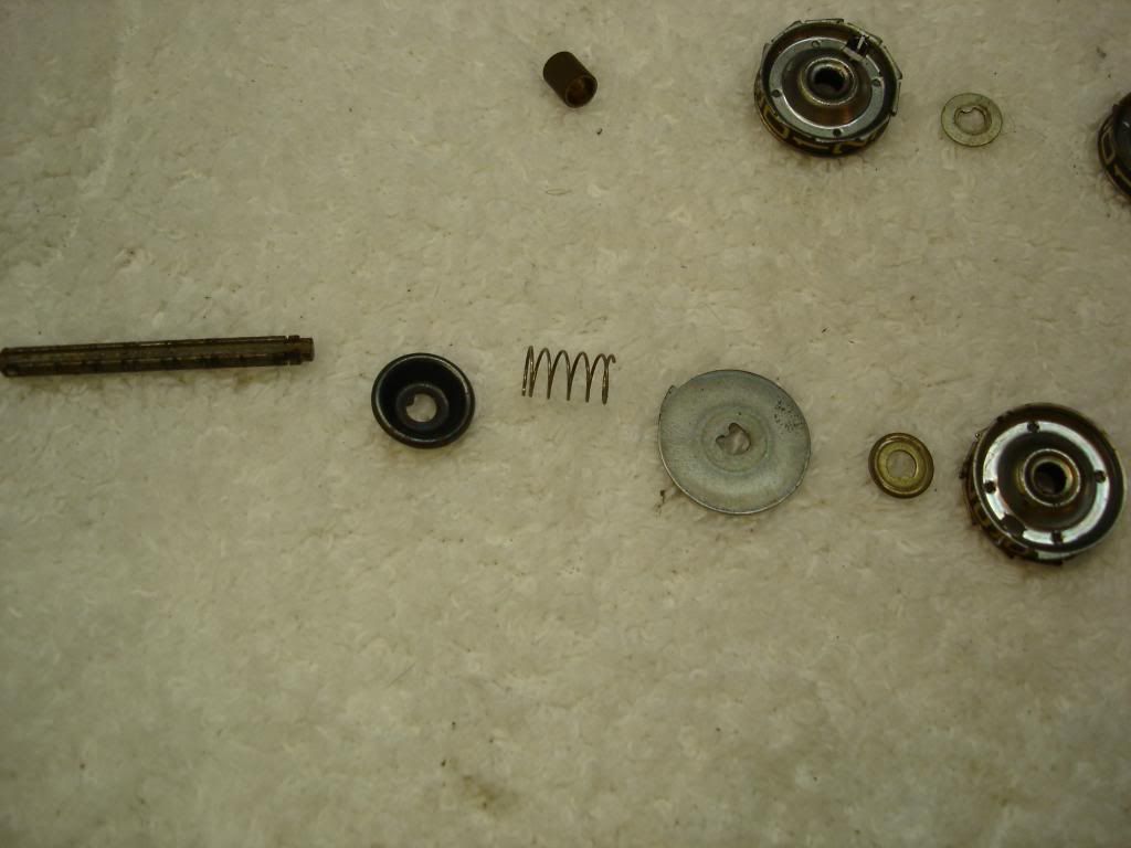

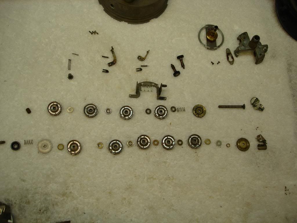

And this is what you end up with...

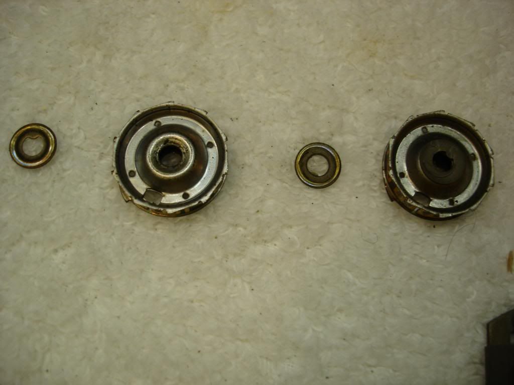

Notice there is a small keyed washer between EVERY wheel! Lay them out as I have and you will not have nay trouble when it comes time to reassemble.

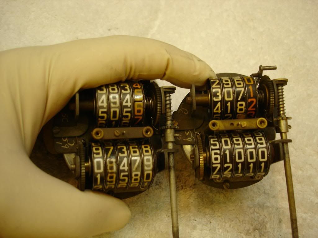

Now we move onto the mileage wheel. It is almost identical. Remove the clip on the brass gear side by pressing the gear inward. Note the clip plate is shaped differently...
Here is another difference. This plane plate is on the "one's" digit wheel side. Its purpose is to prevent the ones from turning at the same speed as the tenth's wheel on the trip odometer. Notice it has a single ratchet, so it lifts the reed for the one's wheel once each revolution.
And you are now fully disassembled! Here is what you should be looking at...

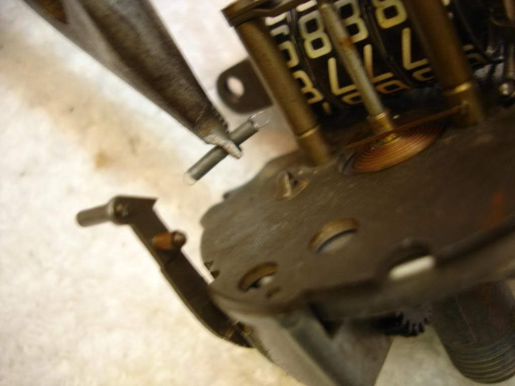

If there is a hard part to this whole assembly, this is it. The tiny springs on the toggle arms have to feed through the number wheel assemblies. Be patient...walk away if you get frustrated! I finally had to fashion a hook to pull the springs through. Even then it is tedious at best.
Don't forget the arm retaining clips...

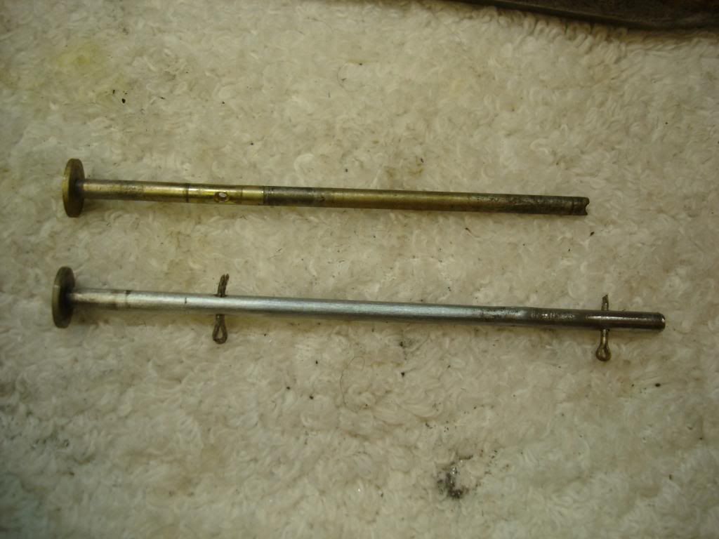

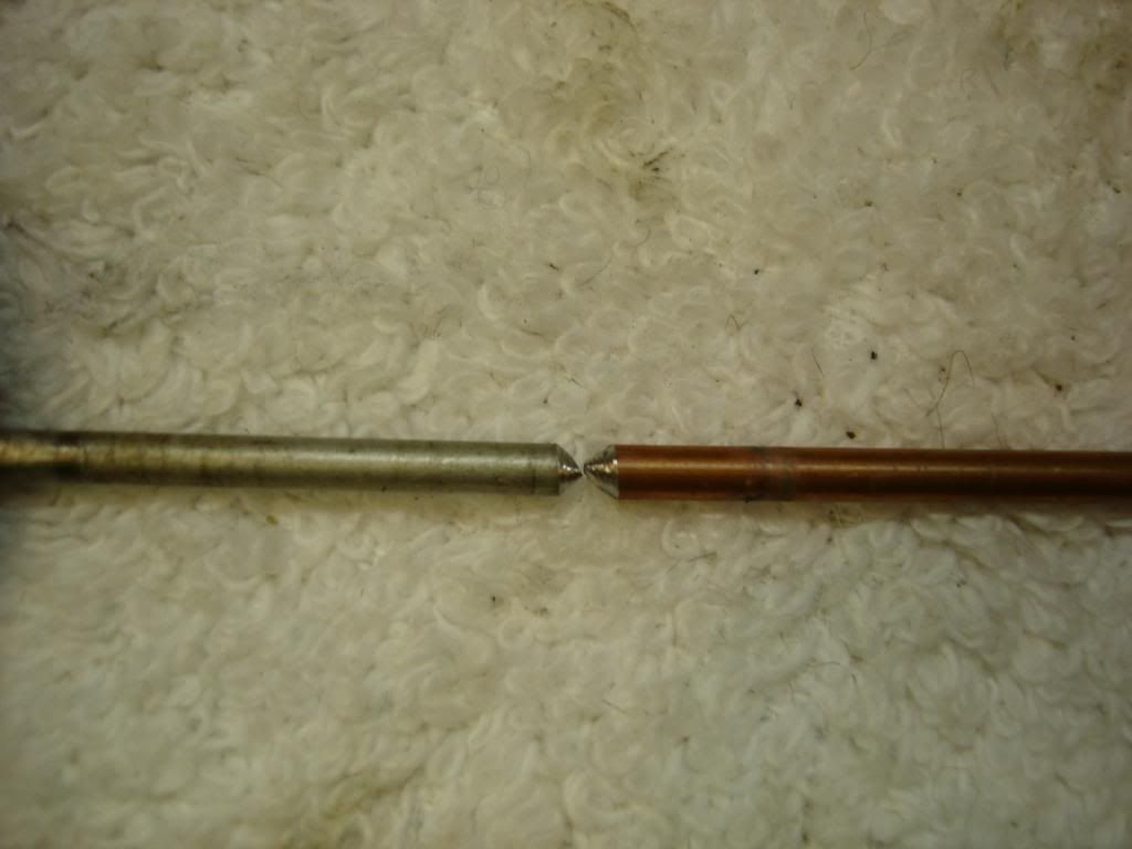

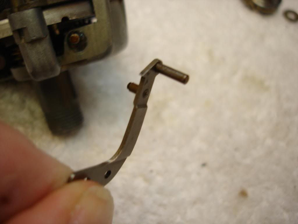

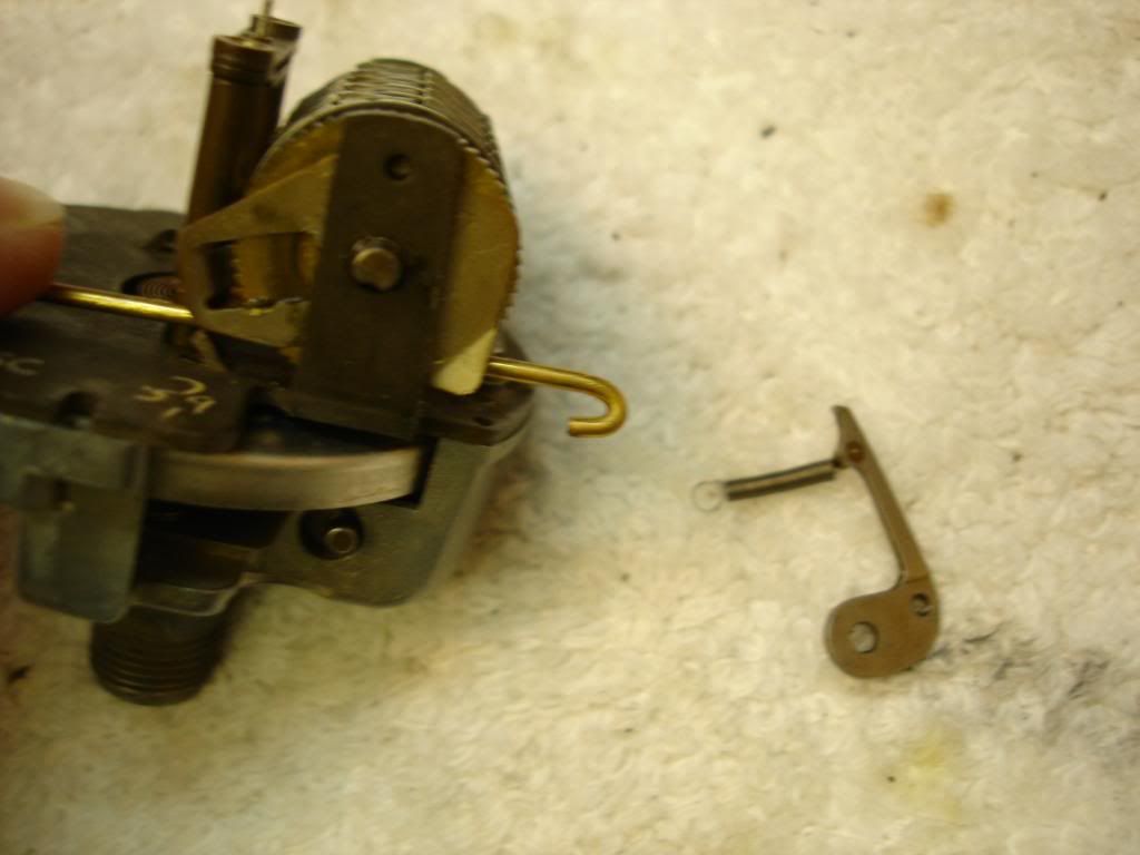

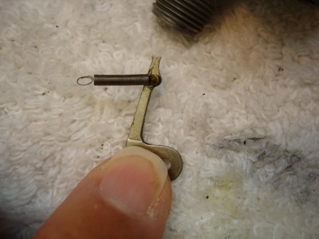

Remember the broken trip reset shaft? Now it's time to address that. My choices were to call Marv and wait a week, or fix the one I have. I decided to go the quick route. I cut about an inch off the end, after measuring exactly where the hole would have to be. I then welded an extension, drilled the new hole, and contnued the speedo assembly...
Note you feed the shaft from the top, so the toggle arm has to be moved out of the way...
And it's done! Next is the face plate, the needle, and time to recalibrate...

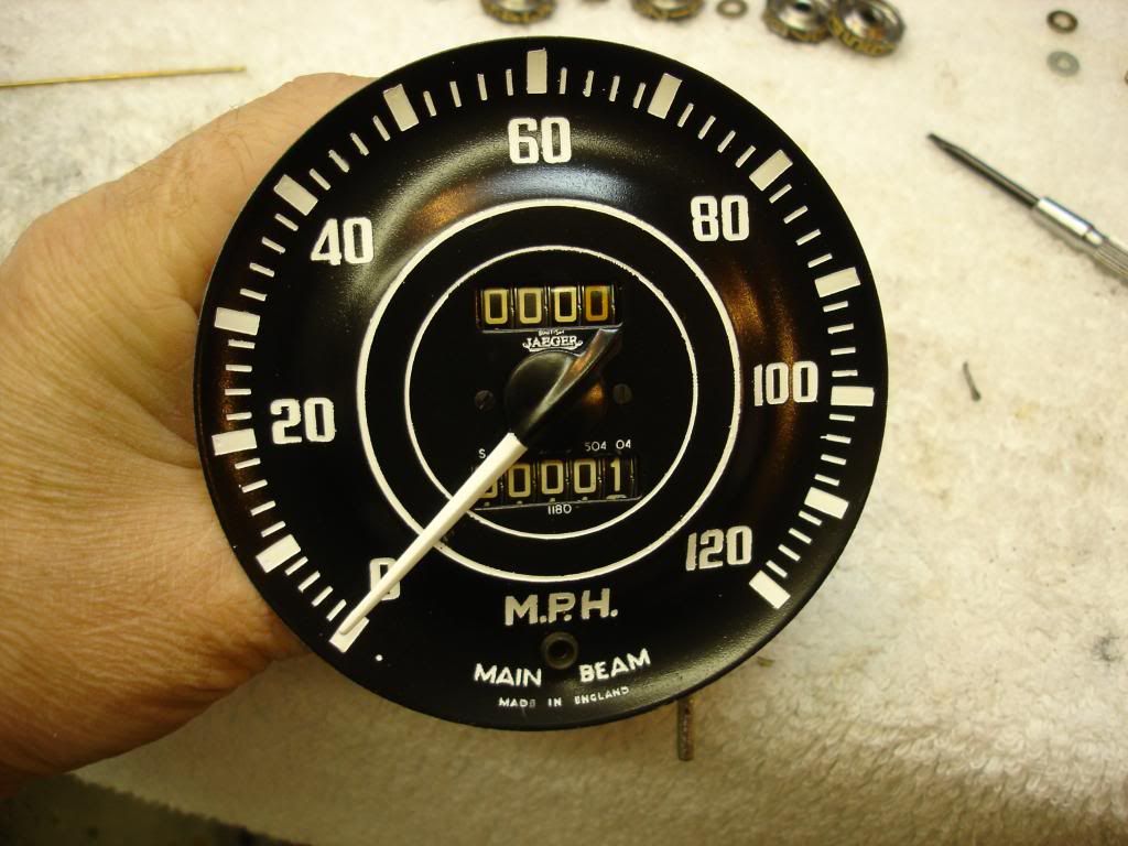

Here is my finished speedo. I started with the odometer at zero, so you can see exactly how many trials it took to get it calibrated...one mile per trial. 22 trials.

And finally, the starting point, for old times sake:
