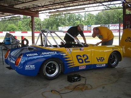

I never much cared for a yellow metallics, kinda looks like it belongs on dune buggy or a bowling ball, but that's just my opinion. It you want to see a really nice solid yellow, here's one, this is Viper yellow, we used it on this race we built, if you look through a chip book, you'll see it it on about 2004 Chrysler colors.
Good looking car Hap, shame it only has 62 HP, lol.
