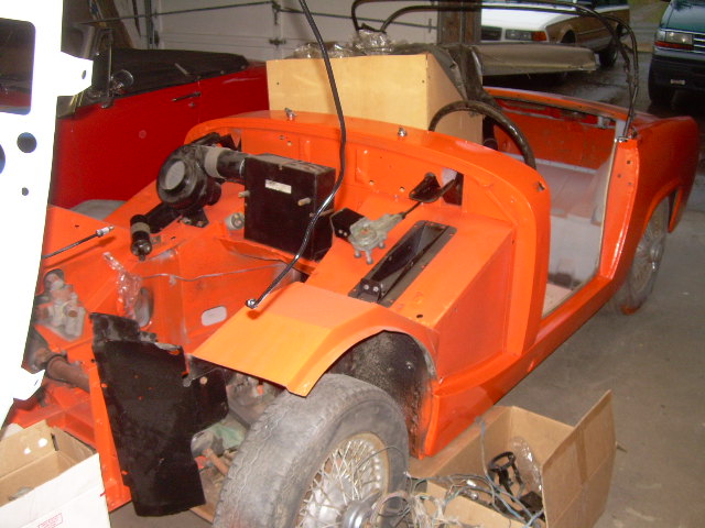

The Midget today (yesterday) with 99.9% less Astroturf!!

Full of rust? Where?
You just can't see it, it is hidden by wirebrushing and primer (remember that my comment is from a Southern Californian who has trashed Bugeye bodies for only having some rust bubbling behind the rear wheels- 30 years ago!!)

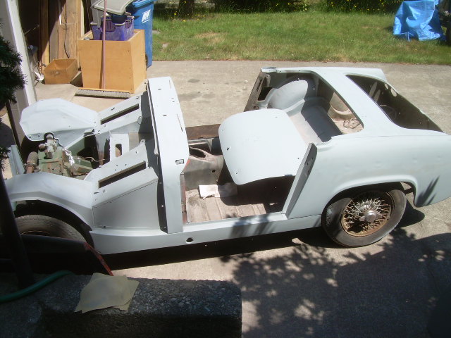

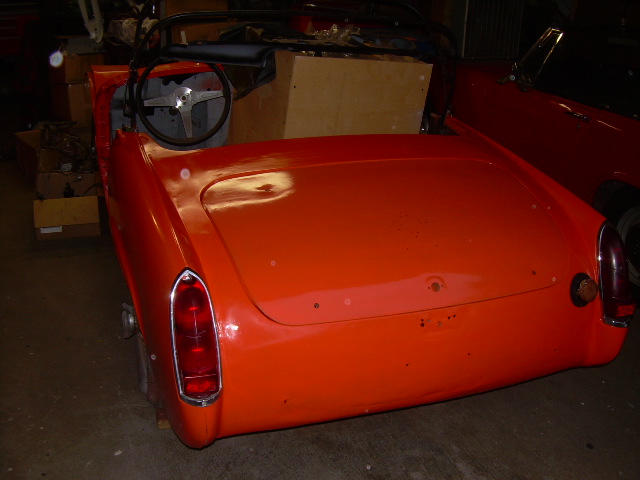

Since I got hit in my red Sprite I decided to go with a color on my '65 Midget that even SUV drivers might be able to see:
BillM

And it is looking good so far.
Wow Bill, you've been working!!
I remember that rust bucket from a little while ago when we last pulled my Midget's power plant... seems like only yesterday... :wink:
If anyone wants to maintain the illusion that it looks good then he needs to never stand any closer than 20 feet to the car!
At least it is getting closer to one color and is as sealed against wet weather as I can make it.

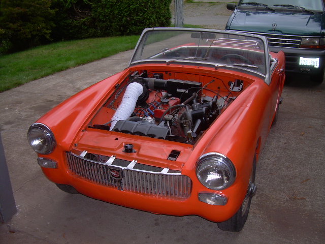

I now have brakes!
The 3/4" dual master that came with the car was so totally hosed that I couldn't even get all of the pieces out of the bores so I rebuilt one of the 7/8" bore ones that came with my MGA(s).
I know that this isn't perfectly correct but it is what I used for years in old Sprites that I swapped for disk brakes and never let me down (more peddle pressure required but always worked).
Next is to put in the engine/trans and see if it will run (tomorrow I hope!)
Bill
I'm running a 7/8" in my '63 too.

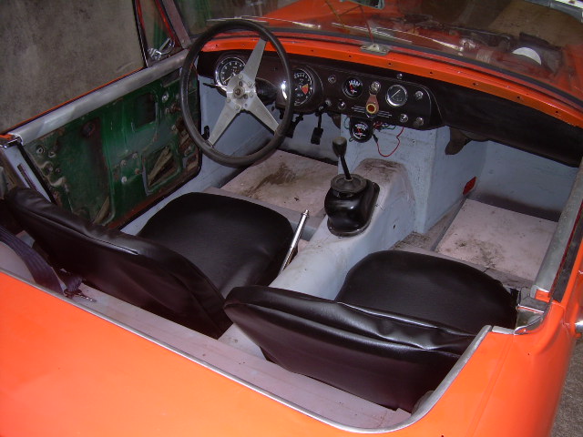

It's not a "VAROOM" post, that happened about 2 weeks ago but today I drove the "Orange Crate" (my wife's name for the lovely beast) around the block a few times and all systems worked except for the brake lights (bad switch I am guessing).
The engine is a $125.00 junker from Craigslist that just had a stuck #3 exhaust valve (now fixed) and runs great with no visible smoke so far.
The tranny is the original that came with my '69 Sprite (it now has a Datsun).
I just recovered the seats yesterday with $25.00 worth of vinyl from JoAnn's fabric, it will only last a couple of years but it was fun to figure out how to do it (really easy!!).
I'll post some pictures that I took as soon as I can kick my daughter off of the other computer.
Bill

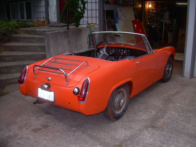

A few pictures-
Lookin' good. Fantastic job, but I notice that the front fenders MATCH?..
(I still haven't changed out my windscreen for ya.. hopefully this winter)
Really looks good in orange. Well done.
You go Bill - WooHoo another Midget on the road!!!

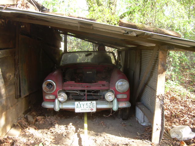

I saw an ad for a '64 Sprite, went to look and came back with a hardtop for the Midget and some extras-----
This is the shed that it has been in for 40 YEARS!! since 1970.
BillM

Wow Bill - WTG!!!
Hey - looks like antique plates, be sure to keep them!!
What's the condition of that red bonnet?
