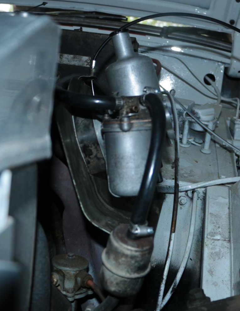

The float bowls should be level when installed on the intake manifold. If they are not, let us know.
The fuel weeping into the carb may be an indication that the float valve on that carb is not completely closing. When you remove the suction chamber from the top of the carb, you should be able to look down into the jet and see gas but the gas should not be at the top of the tube. If the float valve is leaking, that could also be affecting the idle.
New float valve. Tested for closing and opening. They did do that. Cannot adjust float height, they are fixed
It does appear the float bowl is not straight up and down. I can modify the float grommet to get them straight up and down. Should I?

I don't know what angle is correct for Spridgets. Mini, Spridget, and (I think) Austin America intake manifolds look similar but are cut at different angles so SU makes different angle grommets to set the float bowl vertical. Others will have to comment on what combination of grommets and manifold are correct for your car.
I assume that when you say the float level is not adjustable... you mean the carb has the all plastic float, not the plastic float with the metal arm. Setting the float height on with the metal/plastic floats is done by bending the metal float arm. If you have the all plastic floats, there still is adjustment but I don't know that it is described in any manual that I have ever seen and the rebuild kits never come with what you need (always save old parts). To set the all plastic float height, change the thickness and number of fiber washers between the float valve and the bowl lid. Ideally, if you run the engine, switch off, and remove the float bowl lid with float, the bowl will be between 1/2 and 2/3 full of gas. If the level is higher than 2/3 you need to add fiber washers.
You say the float valves are new. Are they "traditional" all metal, Viton tipped brass, or ball-bearing type Grose Jets? If Grose jets, remove them and either: 1) throw them away, or 2) as a minimum, soak them in carb cleaner, then flush them out with spray carb cleaner and compressed air. New ones ship with a protective coating to keep the balls from rusting in storage. The coating can prevent the balls from sealing or can cause them to stick in place. Personally, I prefer the Viton tipped needles but there is nothing wrong with the all brass OEM type.
Assuming the float valves are closing and the level is set "right", you may have some drainage into/out of the jet if the rubber fuel line connected to the carbs is routed higher than the lids. Any residual fuel in the hose above the lid has got to go somewhere when you stop the engine and even with good float valves you can expect a little to seep past the float valves. Keep the rubber lines as low as possible.

OK I need to reroute the fuel lines. I will then remove a little of the float gromit so I can rotate the float bowls to vertical. I did install the new jets that came with the master rebuild kit. I will check floats to see . I think right now I need to add washers
Thanks
very much Rod
You can buy the correct bowl grommets when you figure out what angle you need. If you shave or alter the existing grommets the bowl is going to be a bit "loose" on its mountings. Google the following list of part numbers once you determine the angle you need. Since you are in CA, places like Mini Mania and Seven Enterprises should have them.

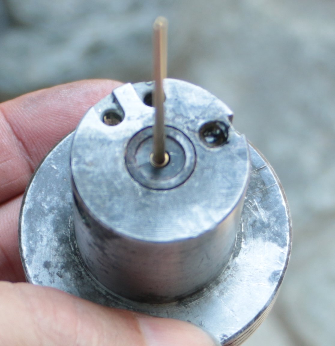

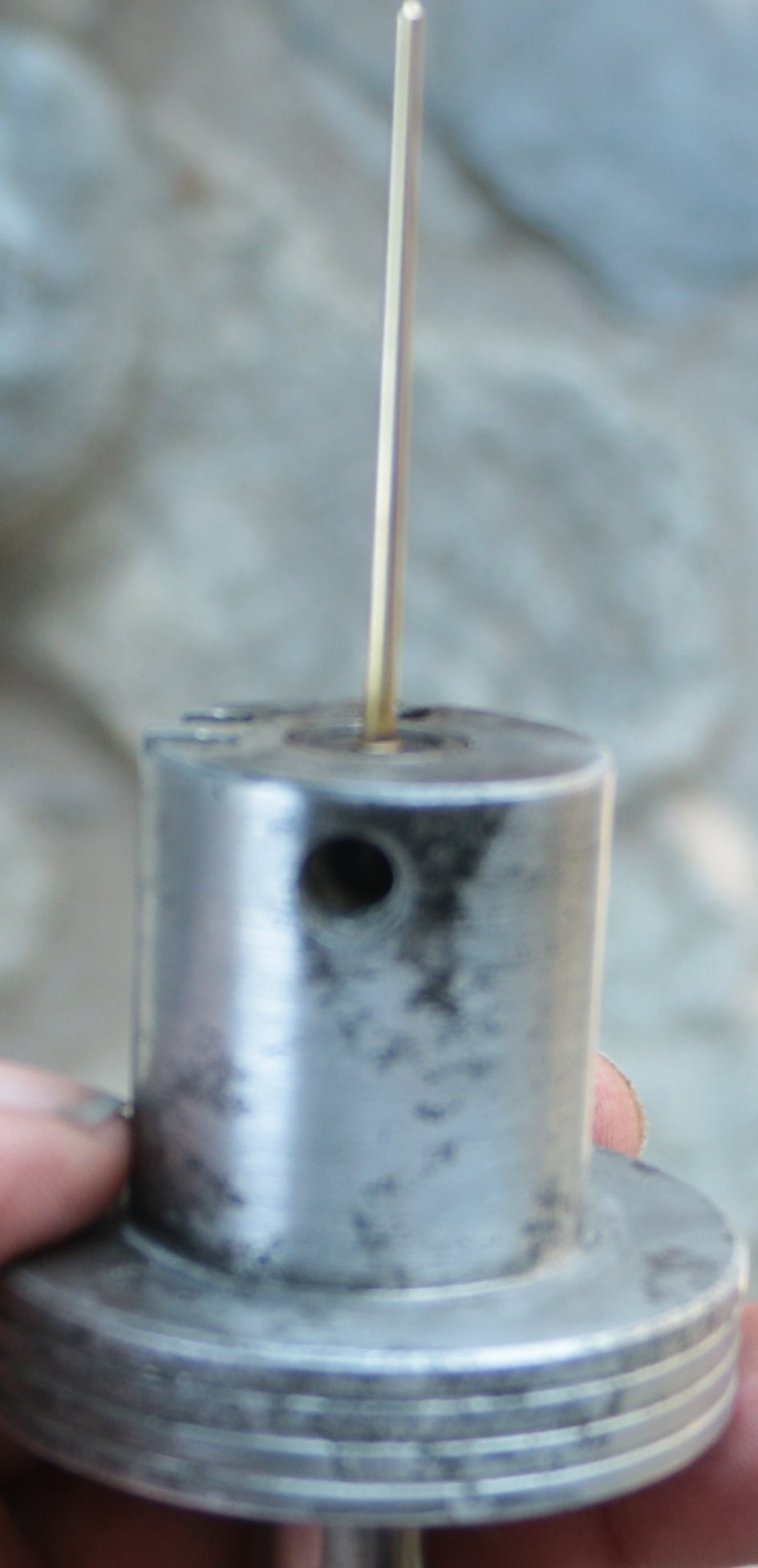

View attachment 34120 I am having a time trying to remove the needle from the body. I have heated it several times. cooled it with carb cleaner and it still will not move. This is the spring loade needle for self centering. Any suggestions?
When you heated the piston/needle, it looks to me like you burned out the nylon plug. (2 o'clock position in bottom pic). I wonder if that could be the cause of the run/die/bad idle etc...? Also, did you change the throttle shafts?
Yes did change the throttle shafts.
I will check the plug but did not see any smoke or anything melting . I do not think I got it past 300 F
