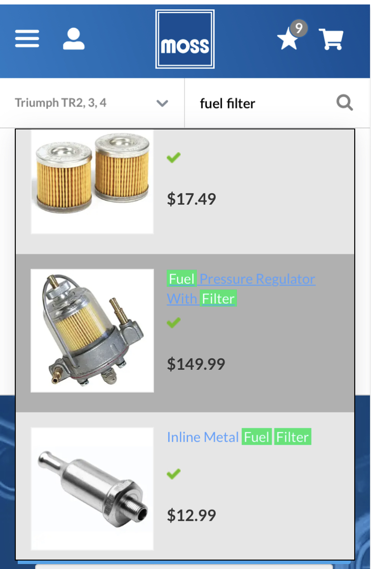

Anyone wishing to respond, would you recommend one or the other type of fuel filter here from Moss?
Our time is not wasted. I come from a people who find vapor lock and 'the station sold me watery gas' as the cause of all problems. Both are actually rare. Cheap see through plastic fuel filters are the proper choice. The only way to see if the filter is clogged. TR3 fuel pumps are up to the volume required. Try blowing some air backward from the fuel pump supply to the tank.

None of the Moss filters shown I would recommend. Try your local auto parts store. Again the plastic ones are very good. If you put the filter just before the carbs you need a 1/4" in &out size. If you are going to put it before the fuel pump you need a 5/16" in &out size.
