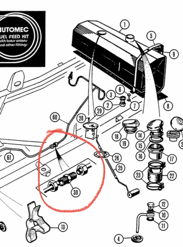

I had a fuel delivery issue and it was a small rubber connection tube near the rear.some cars have a brass connector a lot have a plain rubber pipe to join the 2 metal pipe runs. It’s tucked away under the car running along the chassis and often forgotten about.

see the picture.
