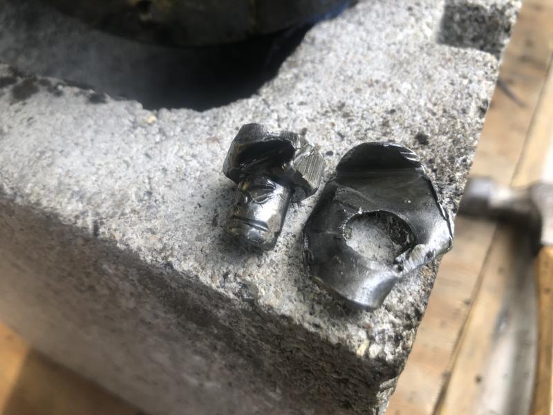

Well..... booger.
So... as you can see... a good bit more messed up than the axel. The differential bearing cap cracked.... not surprisingly, on the broken axle side. Additionally, there are a series of bolts that go into the gear set and have a retaining bracket on each one. In the pic showing the crack in the cap, you can see one still intact. One of the bolts sheared off and the bolt head and retainer were rolling around in there... clearly somewhat chewed up. I can't tell what failed first, but I'll bet it all happened in the same minute or two.
Moss doesn't seem to sell the bearing caps.... what thoughts do you guys have? Is the diff trashed since that bolt sheared off? Would it be better to swap out a new gear set?
