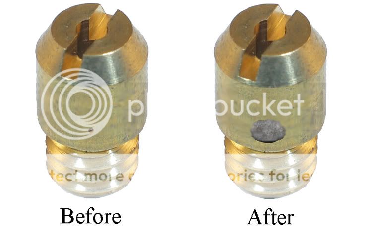

Ok here is what I did, the dicharge pump valve is located on the inside bottom of the DCOE fuel bowl. The one I have is a 50, or .5mm hole on the side of it, the before picture. I used JB weld to plug it and let it set 24hrs, after picture. We shall see if this corrects the problem.
The weber tech told me the hole should be pluged for MG engines. Which allows for maximum delivery of gas during rapid throttle movment.
I will post the results tonight once I install the "Plugged" valve and test run her.
I'm so excited!!!! God I hope this works!

YEAH!!!!!!! Ok now it bogs slightly and then catches up, I suppose this is the hesitation thing people talk about. But its 100 times better, does not bog and die. Only bogs then goes!! Yipppeeeeeeeeee
Will buy the #61-80 drill bits and start playing with the jets.
Thanks to all!
