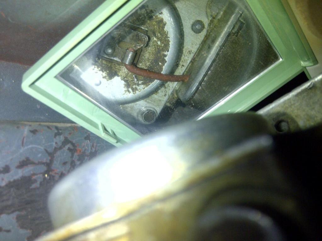

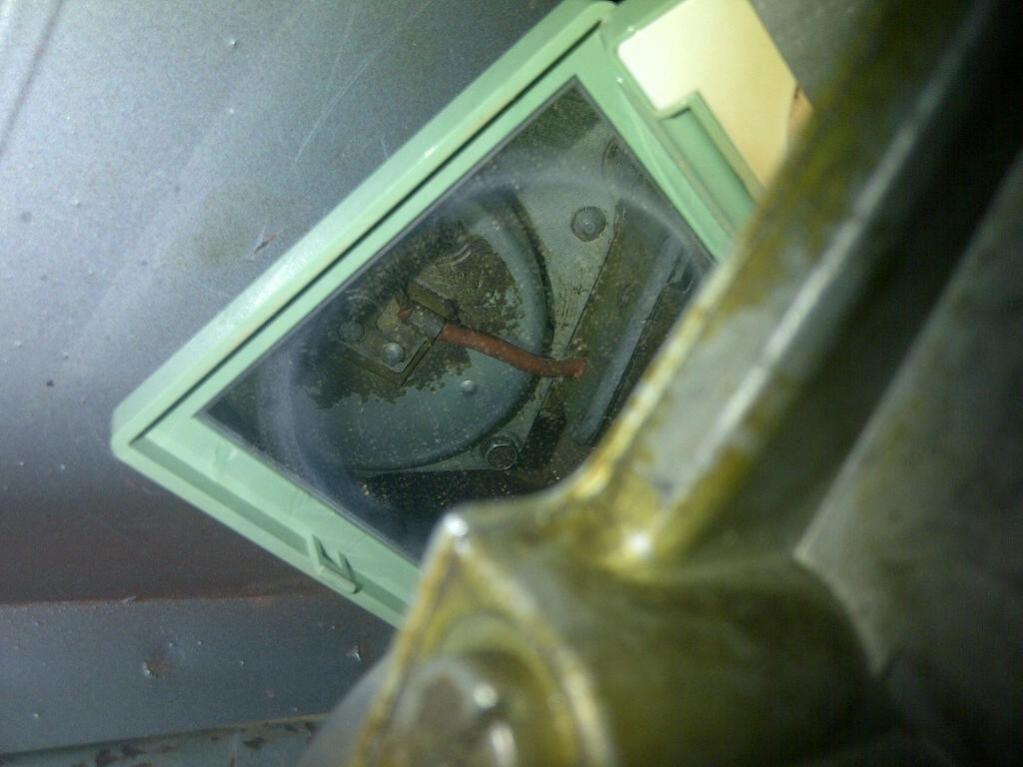

Park location is my issue now. I've loosened the gearbox and rotated the cap in all directions. The park adjusts but all within a few degrees towards the passenger size. Should you be able to rotate the cap 360'? I feel like I can only rotate about 120' or so.
Thanks! Almost there!!!
Here's two pictures (using a nifty mirror) of the full range of motion I have with the cap. I wonder if I don't have enough slack in my wire. Could that be it?
That was it. I loosened the screws of the gearbox and motor and pulled the wire a bit which allowed me to rotate the cap fully. Wipers are working and parked correctly!!
