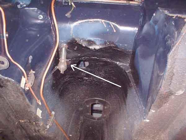

I was looking for the drain in the air box, located behind the dashboard, because I thought there must be one, but I could not find one no matter how hard I looked. I looked on line and found some great photos from a guy in UK showing where it should be (attached photos). I finally found the problem, mine was completely full of sand and dust, like concrete, from apparently being driven in Arizona. The dust had completely filled the pipe and opening so it looked like one had never existed! Using coat hangers and drill bits now to clean it out. Good lesson and I will work to keep this open at all times.

The duck tail will collect dirt also if the car is in dusty conditions and where small tree foliage can fall into the air vent, once it does, the tube will clog up again. I removed the duct tail for a clean passage in the tube. The duck tail is only needed if it's a concurs car and a judge want's to crawl underneath. :highly_amused: PJ

During my investigation online I found a lot of debate about keeping the bob or duck tail on the end or taking it off. Some said it was necessary to keep out fumes. Mine is coming off as well, I would rather have a free flow than take a chance!

I use a piece of bicycle innertube at the end of a hose for the "ducktail."

Once I cleaned out the "concrete" from the drain it worked great. Several large glasses of water poured through a funnel went right on out. No wonder the floor was so soaked when I drove all day in a rainstorm!

Agreed, water will run out if the tube is clean. But if the car is exposed to dust, dirt and debris from trees, the tube can clog with the bulb/duck tail in place and cause problems later. I never heard of anyone smelling fumes coming from the heater because the duck tail was removed. If that were the case, there are other problems present. PJ
