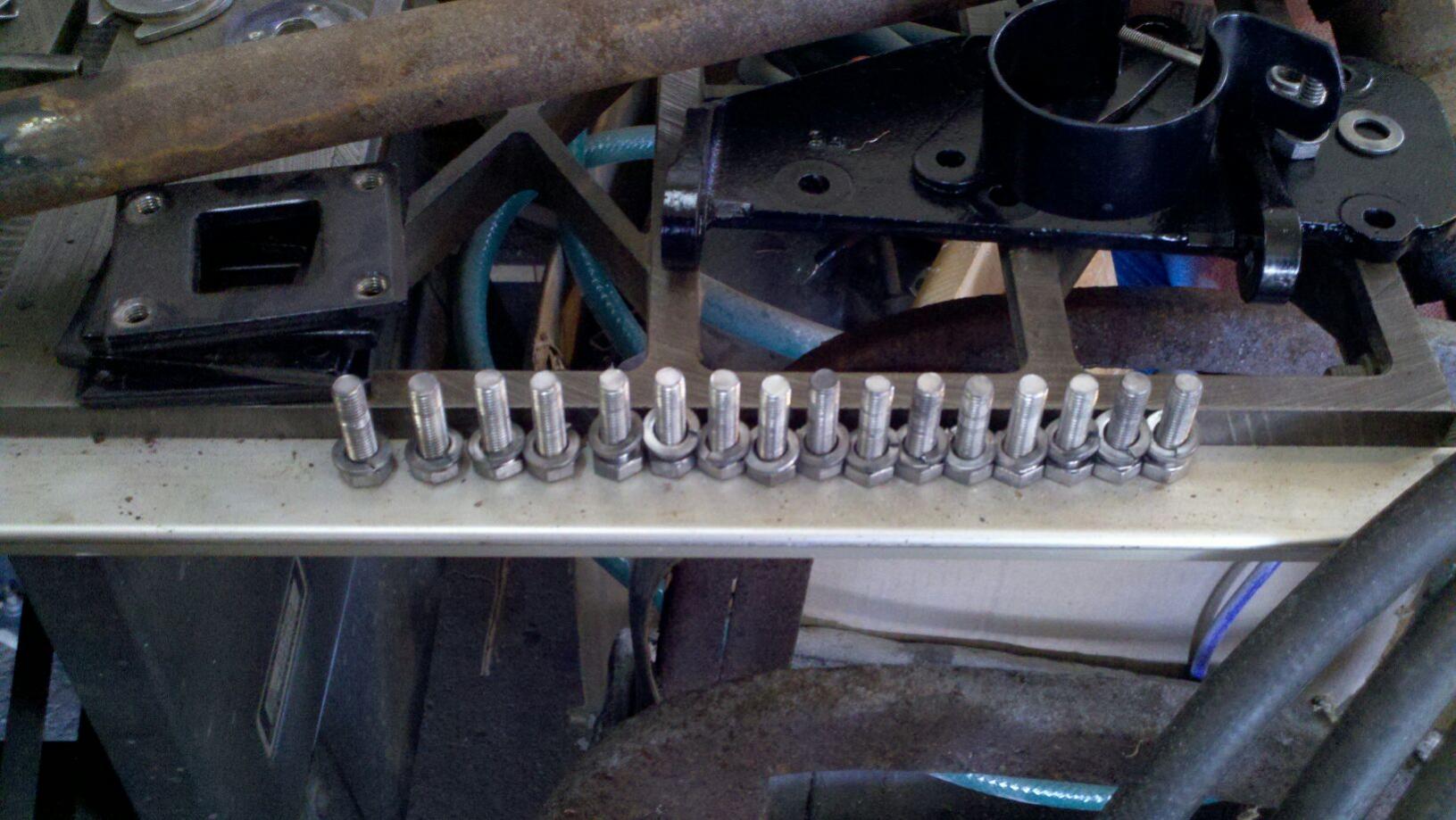

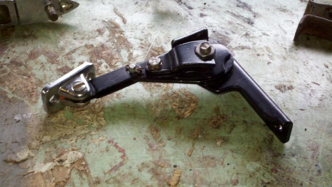

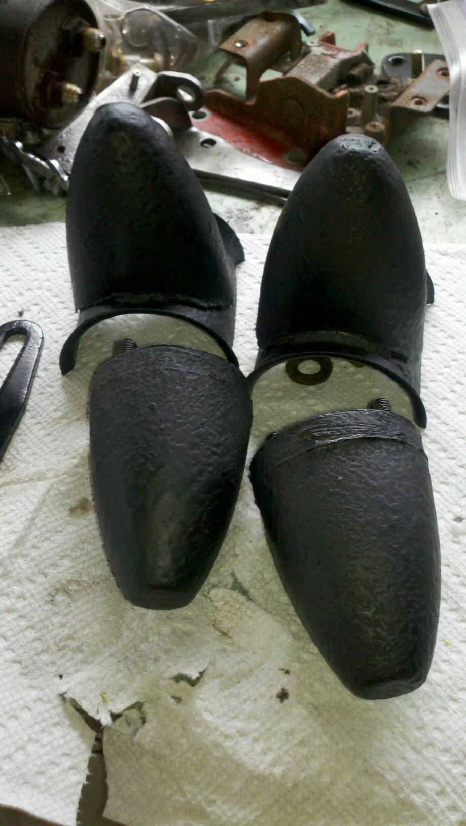

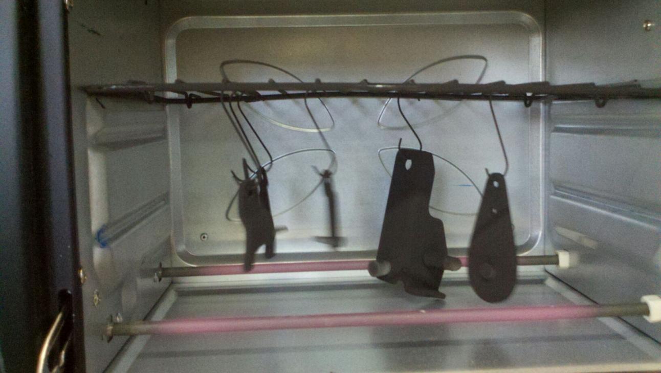

Check strap parts baking, finished check strap, some cleaned up bolts and the refinished front buffers

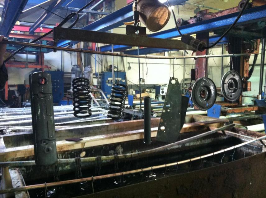

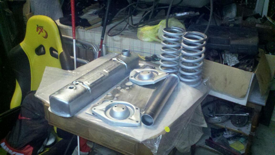

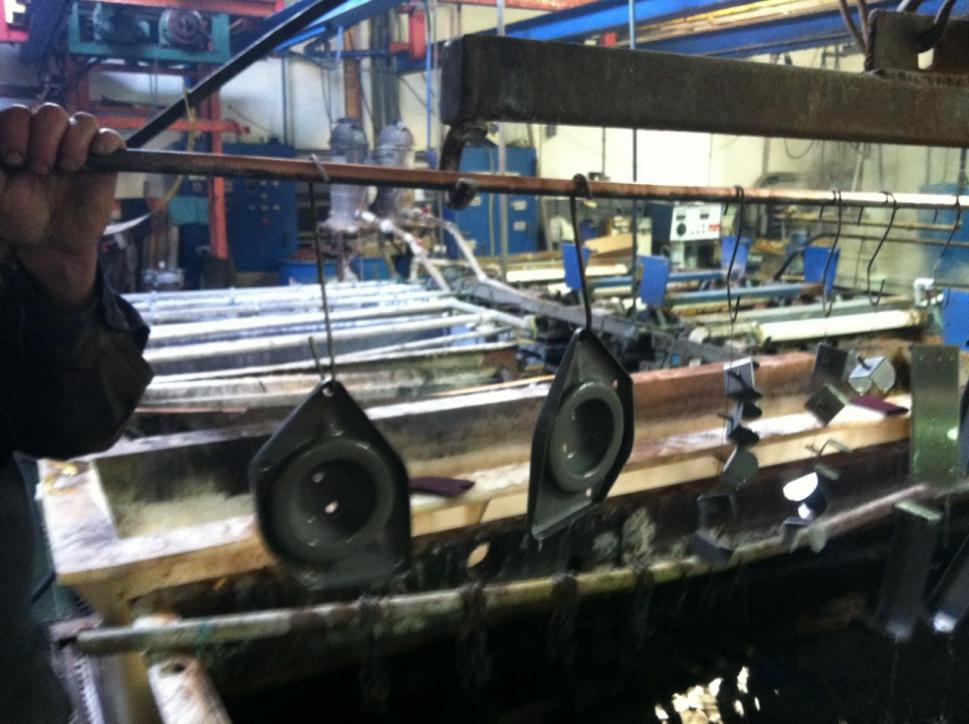

I had some parts cleaned and zinc plated:
Valve Cover
Springs
Gas Tank Filler Tube
Shock mounts
Sway Bar (Nickel)
Exhaust manifolds
Rear brake backs

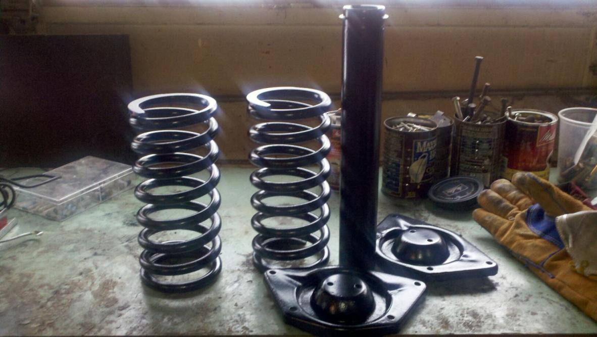

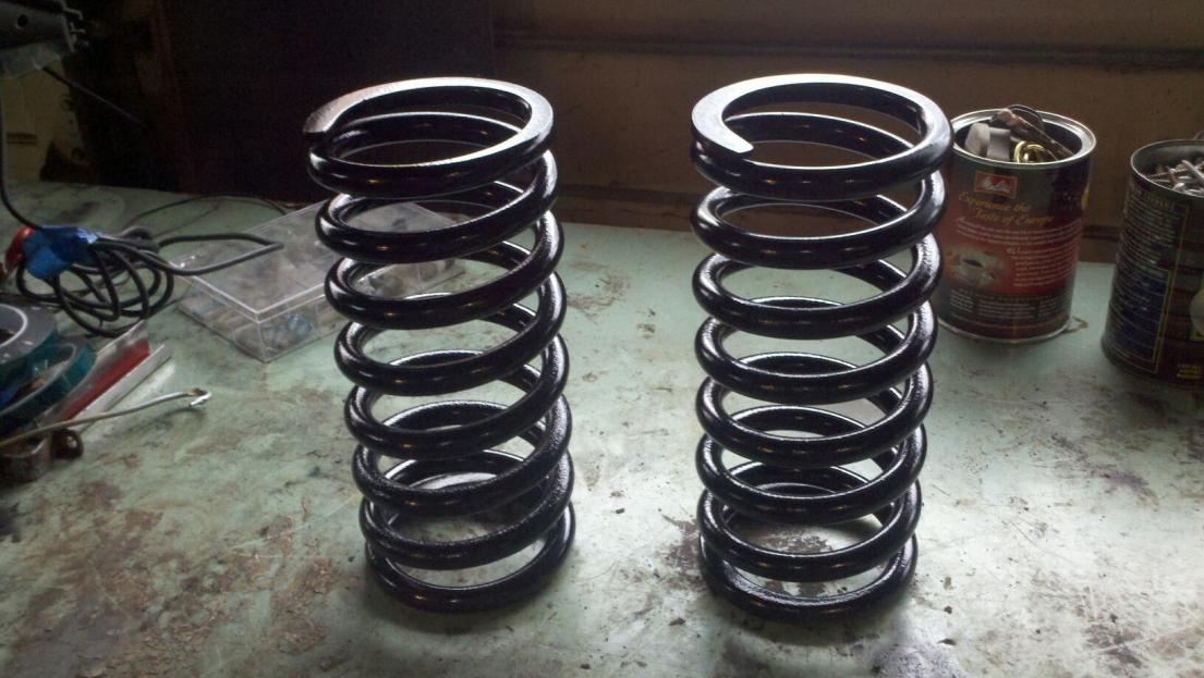

(Have much more to do) I then decided to powder coat a couple parts in addition to the plating... im not messing around!
Some good friends of mine own a plating shop so free plating and acid baths are coming in handy
