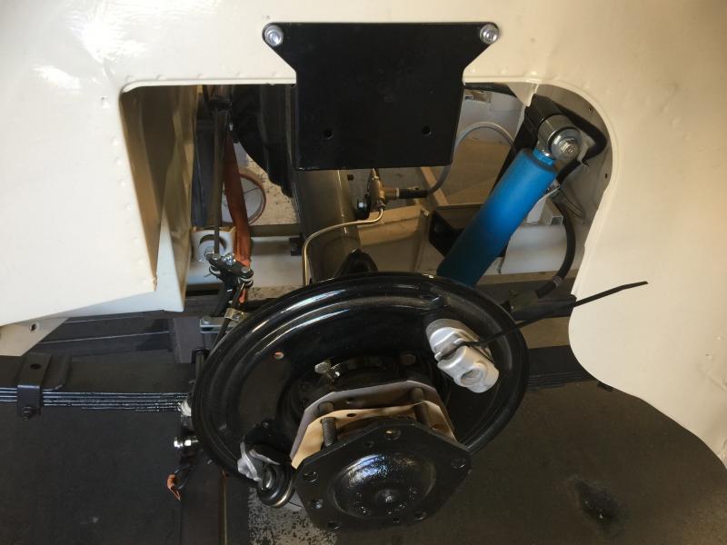

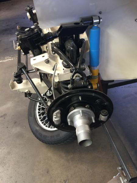

Here's two good shots of another car from the tech session David Nock had yesterday at British Car Specialists for the Golden Gate Austin Healey Club. It's a BN1. Mine's a BN2 but it was awesome to see what my car looks like under the skin.
You can see the shock setup really well. Stronger and cheaper that new levers and adjustable. You can keep the old levers up front and even get the new shocks painted to match.
