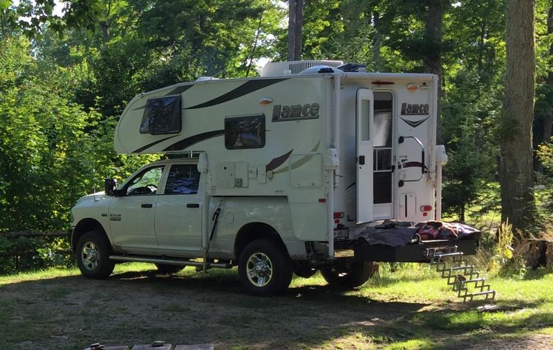

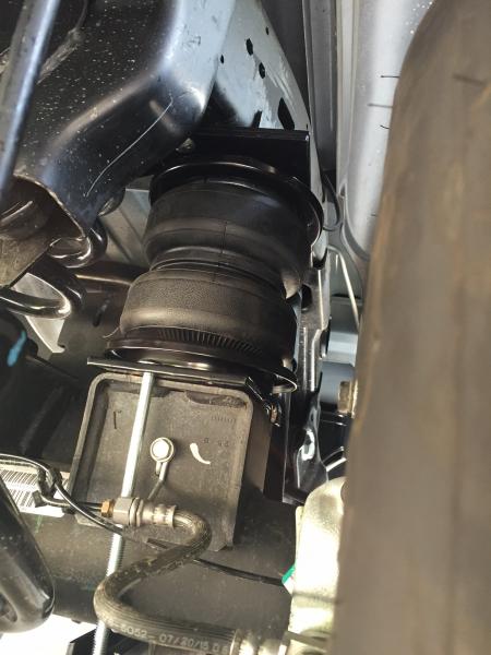

I have often thought about air bags on the back of the Healey. I have 5000lb capacity bags on the rear of my RAM 2500 for when I drop the camper in. They level the truck and improve weight management and control while on the move. To avoid redesigning or replacing the suspension of the Healey, air helper springs might work well. The stock leaf spring suspension still does most of the work, and locates the axle, but the helper is used to control height, and would improve control (which might be helpful at speed while going over dips, which can bottom the Healey suspension pretty easily). Bags for the Healey would have to be pretty small to fit the space and because they don’t need to handle much weight, compared to a bag for a truck. Pretty cool idea.
EDIT: Adding some pictures. The bags on my truck replace the bump stops on the axle, which you could probably do on the Healey too. Controls height and load really nicely.

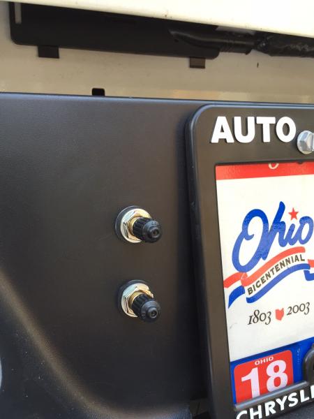

Ray, the bags can be inflated in several ways. There are on-board compressors with in-cab controls to inflate/adjust at the push of a button. Or, you can inflate with an external compressor or basic pump. I mounted the two Schrader valves in my rear bumper for easy access (one for each bag). I air up with my compressor and I'm good to go. I have not experienced any leak down, even after a week of travel. It would be easy enough to mount the Schraders in the boot.

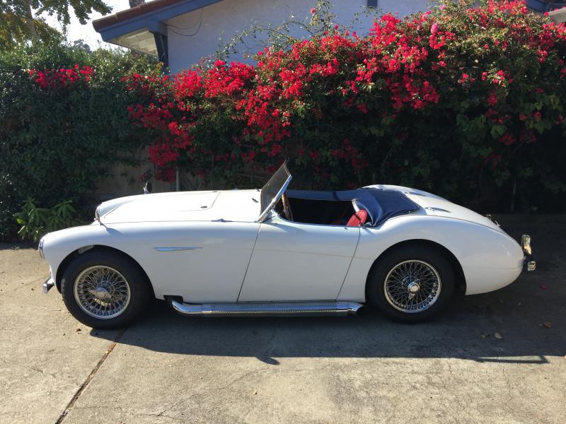

My BN2 has a SBC400. The weight is about the same as the original 4cyl. My firewall was removed and reformed around the engine which was pushed as far back as possible. I would describe it as a front mid-engine car in this configuration. The car is very much a GT.
The balance is near perfect and the car handles very well at speed; light and responsive steering even with the original box. Proper application of throttle helps to steer through the twists and turns. Tires are 185/70 so they are about as tall as the originals but much wider. The car does not like going slow so parking is a work-out. I might go with the rack and pinion eventually to get rid of the peg and grove.
Lever shocks up front but the back are adjustable shocks over the leafs. They book end a very stout Ford 9". It looks just right to me.
