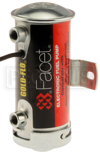

I've had one of these Facet cylindrical style pumps on mine since the early 90s (exact date unknown). It DELIVERS the fuel at lowish pressure AND the sound you'd expect to hear when turning on the Healey's ignition. Plumbing? Well how original do you want it to look when you're at a standstill off in the desert somewhere...?
https://www.pegasusautoracing.com/productdetails.asp?RecID=8674
I'd moved mine to the RH-side of the car, as sitting over the exhaust pipes didn't seem that logical to me!
That's a clean installation (as we'd expect :encouragement:). Looking at the top photo, at first I thought it was mounted horizontally.

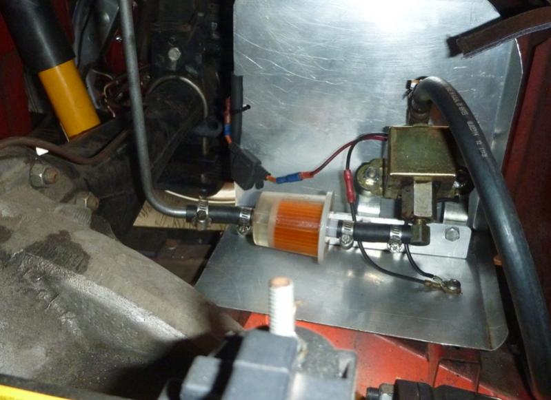

Ray, Yes, I have been running two pumps in series for 5 years, with separate switches on the dash. The system works very well. My reason for building it this way was because of potential failure of a fuel pump. As for dirt. Yes you are right again. But If you build a new car, as I have with a new tank, dirt should be of little concern. But 2 characteristics in the system should also assauge any concern. One is that SU pumps with their coarse internal filter will pass most boulders on through. :smile: Second, you could just install a filter ahead of the first pump as Steve did. Here is a pic of my set up although it doesn't show both sides the left side is identical to the right side.

The Facet pump I referenced a few posts back also includes a built in filter, rated at 74 microns (there IS a 400 micron filter available, but their most commonly used pumps have the 74). The last time I inspected mine__let's just say not in recent memory__it was spotless; I mean I couldn't even find a spec in it (and my eyesight was, at least back then, better than my memory...).
I have a fabricated aluminum tank (28.8 gl) but the car had sat in Tsikuris' shop over a year, so I drained & flushed it, along with cleaning the varnish out of the carbs. Since that was around 2004, that's probably the last time I took the end-cap off the pump to check the filter. If I'd ever remember to include a new gasket or two with an order, I might (?) check its condition more often.

Electrical connector. It's probably a late 80s/early 90s version (?). I have it in my mind that it's a bayonet-type connection (like a tail light bulb) but I've been wrong before (haven't touched it in quite a while...).
