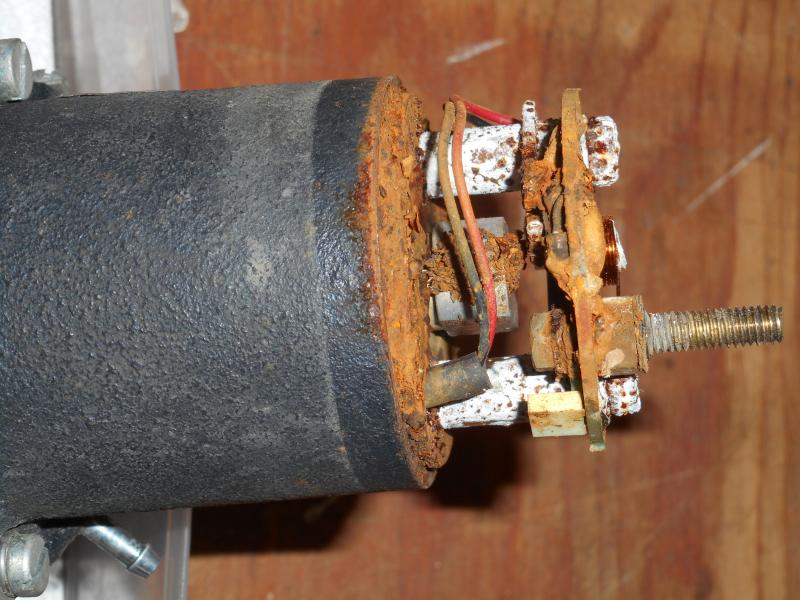

Thanks for the reply, Ray. I used points-based pumps for years with nothing, capacitors, diodes, transistors and TSVs for arc suppression. For the last few years I've been using pumps converted to opto-electrical switching built by Dave DuBois. I've had mixed results; I think the longest one lasted was 15K miles, which is surprising because the design and Dave's work is impeccable. One ingested water, somehow, probably through the vent on the plastic cap:
One failed on the road this summer after only a few hundred miles, and no water that I recall, which confounds me, but I swapped another in on the side of the road which gave me over 5K miles but was dead after sitting for about 5 months. I'm down to the last functioning pump which, of course makes me nervous since I usually carry 2 spares (we often drive in the middle of nowhere, and out of cell range; the rest of my drive train is pretty much bulletproof at this point).
I'm just cursed, I guess, since some report many thousands of miles on points-based pumps. I ran those for years and did a couple emergency resuscitations in hotel rooms. My BJ8 has the original plumbing, and the tank is coated and, last I checked, free of contaminants. Maybe I'll know more when I perform postmortems on the two failed pumps. Ordinarily, I'd send the pumps back to Dave but I hear he has health issues and is not doing pump work for the time being, at least.

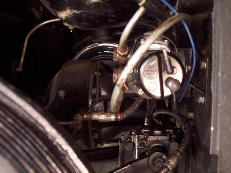

If you are going non original then it’s time to move the pump from it’s impractical and exposed location. Install a Facet in the left side boot well and carry a spare just in case. Much cleaner and simpler than the original set up.

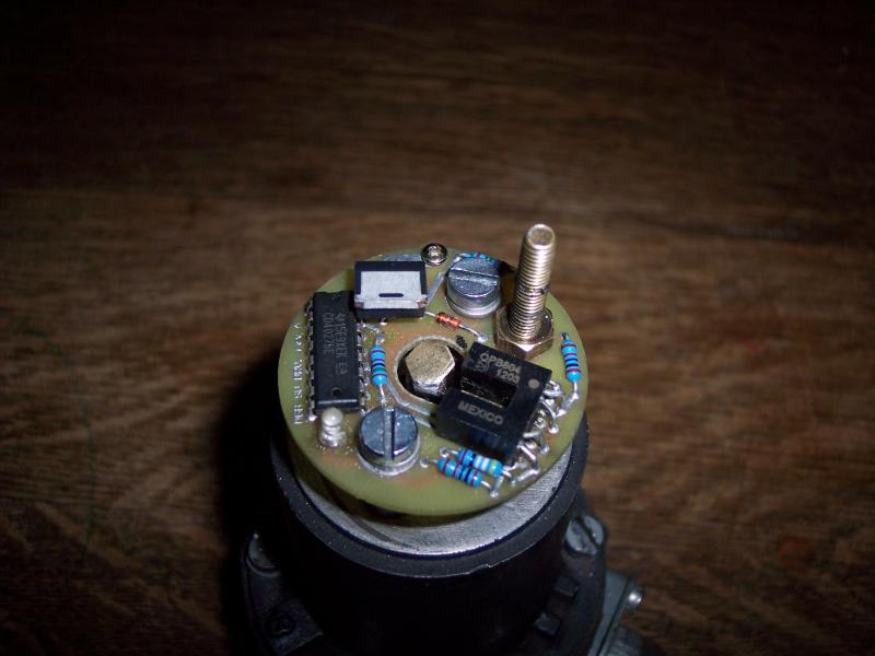

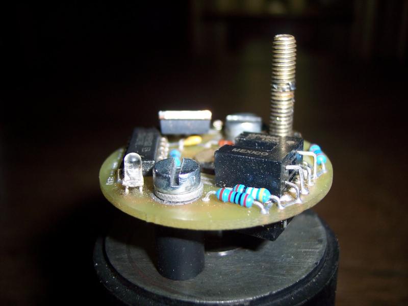

Having driven my car since new and having required its operation as fun and family car, dependability was a critical factor and maintenance a key activity. Back in the late 1980, I preemptively replaced my square SU pump with the unit used on the Phase 2 model of the BJ8 and it has been installed and running well with the inclusion of many of the prevailing additional components Bob mentioned for extending point life. I can't say they all worked as expected but I can say that over the years I have only installed 2 sets of points and found the best point stability with the TSV which maintained a high volt of 20v (sufficient for oxidation removal) and sending to ground all voltage above (coil generated as much as 200v).
However, I do carry a backup but not a full pump as the weak link in the SU pump seems to be the triggering mechanism. A while back, when the transistorized/solid state SU pumps were exhibiting sudden failures, 2 west cost friends and I worked on designing an optical trigger that could fit under the cap of an SU pump and started practical testing of a preliminary prototype (Rev. -1). Shortly after testing began, SU's solid state issues seemed to be resolved and work stopped on our optical trigger.
However, to this day, my on-board SU backup remains that optically triggered head for the installed SU (points) pump. In actual tests, I found I could more easily remove the wheel and change the head of the SU pump then replace the whole pump and, in my younger days it would take about 10 minutes (if I remember correctly). By changing only the trigger head, you eliminate the possibility of cross threading the fuel lines and as well as having gas leaking from the lines and pump when removing the pump. Since you maintain the body and coil in tack, no pump removal or disruption of the fuel path is created and pre-start setup is almost automatic. Yes, there a risk that the body could have problems but the coil and body of the SU pump is the most reliable portion with triggering posing a multi-times high probability of failure.
Just my approach to SU backup and I would take it using a spare points or solid state head as well,

On my 100 I used to have an SU with a Facet cube backup installed at the top of the left wheel arch but about two years back I installed an SU double-headed pump that DD rebuilt for me, fastening it to the rear of the bulkhead in the approximate spot where the original SU was mounted, with an On-Off-On switch behind the driver's seat.
