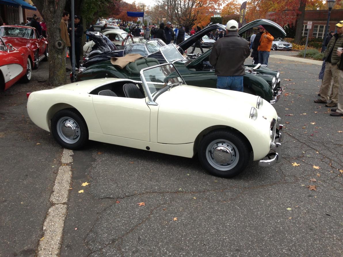

The car was finished in August and I've been able to use it a little bit - even made it to a cruise night with my folks... It came out beautiful - Jay did an incredible job. I havent had a chance to really photograph it yet, so far this is all I can come up with... when I made it to Caffeine and Carburetors in New Canaan. Such nice cars there. Some amazing XK120s, 150s and big Healeys... I was the only Bugeye...

It's really nice, good job!
Wow, very nice! Post more pictures when you get a chance.

Very nice, congratulations for getting it done and on the road! :cheers:
Great job! Say, where did you get (what looks like) the new BE windshield wash bottle? been looking high and low for one that "new"
thanks for the compliments.
the rubber tunnel mat is original to the car. it was in horrible shape and i was going to toss it! jay was able to repair it and piece it back together - and did a **** fine job too! the floormats are from ahspares. not original, but in my opinion excellent ampco reproductions.
the washer bottle is also original to the car. jay just cleaned it up and sourced a new Tudor sticker.
