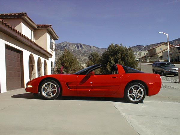

Oh I dunno, I kinda felt that way about the C5:
[/ QUOTE ]
Right on Bas! /ubbthreads/images/graemlins/patriot.gif
R6MGS
BTW; Beautiful Vette Basil....and the perfect environment for it!
