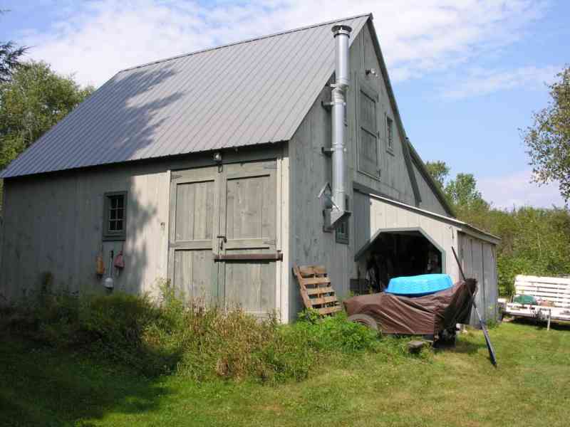

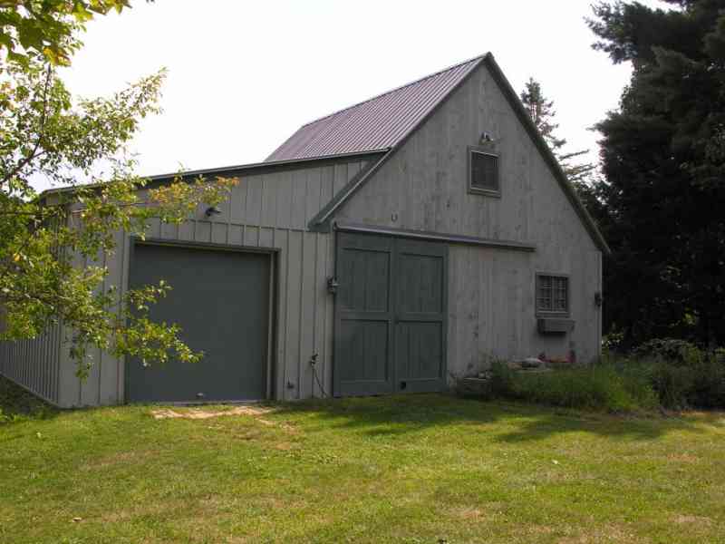

I built this myself with help from a couple of friends. But I had the pros do the slab. It is a modern post and beam design using treated 6x6 posts.
Front
Rear photo showing entrance overhang, the front clip of a TR4A, and my aluma trailer.

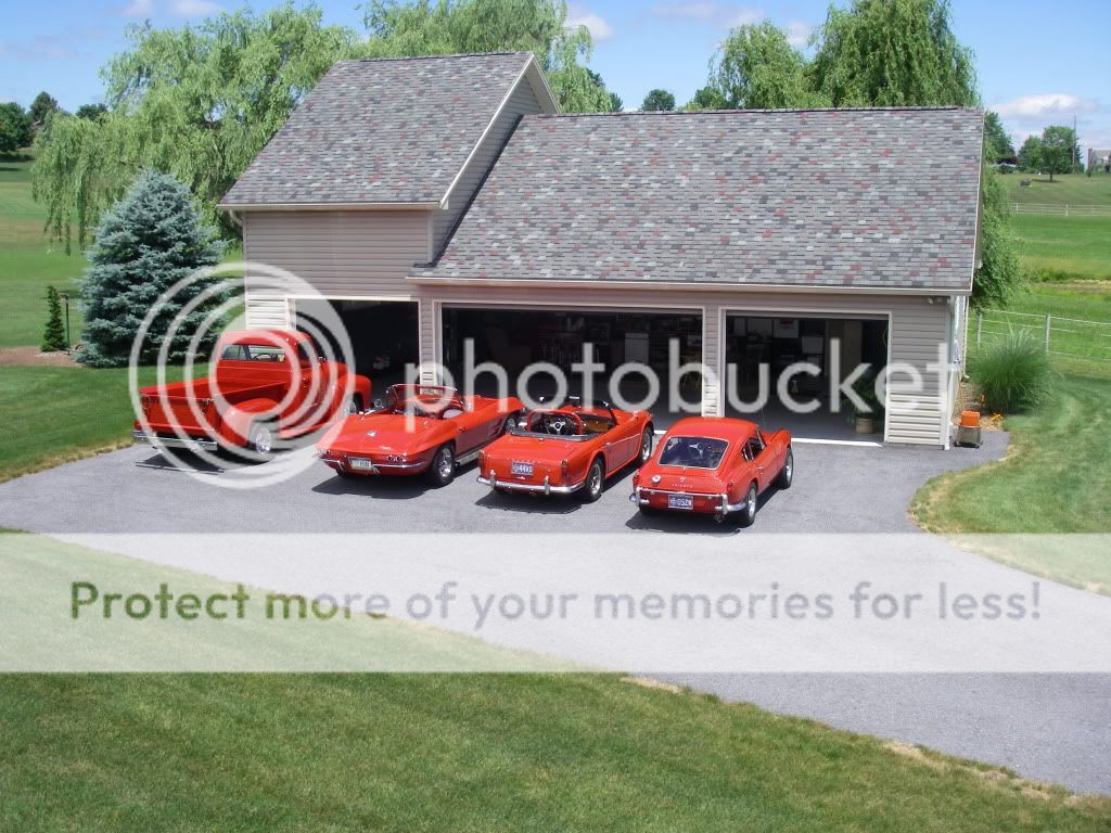

I'd also recommend checking what others have done over at garagejournal.com - it's amazing what some have come up with. Here's mine.

We are in the process of building a detached garage. I call it the garagemajal. Tomorrow is for putting in the lift, electricians will be finishing the final connections, plumbers finishing their finals. It is hoped that we will be able to turn on the lights and open the water taps on Saturday. It is 40X40 with three bays. The center bay is where the 4 post lift is and it has a commercial door - straight up. As this made the garage very tall, we took the back section and created a 15X17 loft which is going to be the 'media' room. There are 4 rooms in the back that connect to the garage with french doors and the left room is the office with a window looking into the garage area, the right room is for just sitting and the center is a kitchenette and a full bathroom (shower, toilet and sink). Husband acid etched the entire floor and this will stay in the kitchenette and bathroom. The loft and the other two rooms will be carpeted. As we wanted this to complimeent our home, it is a wood frame building with log siding that matches the log of our home and the metal roof matches as well. House is a real log home but it was cost prohibitive to do a log garage. Mechanical room has a/c, heat, water softener and compressor. Air lines were installed in construction as was the electrical for the lift. We have tried to think of everything but I am sure we will find something that we should have added or something we shouldn't have done. When it is completed if you're interested I will post photos.
Obviously we are very excited and husband has waited 13 years to have it built. Sometimes you just get lucky and in this case had we tried to do it a couple of years ago it would have cost considerably more money but given that state of the construction industry, costs were a lot less than was quoted then.
I can't believe I have come off like a 'gusher' but in saying this I can see that it really is a big deal! Just spending the kid's inheritance and having a grand time doing it. As designer and husband is allowing me to do this I've opted to keep an aviation theme in mind. That's another story.
