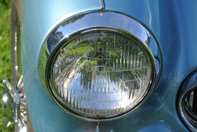

Here is a pic of an original 26k BJ8 set up
